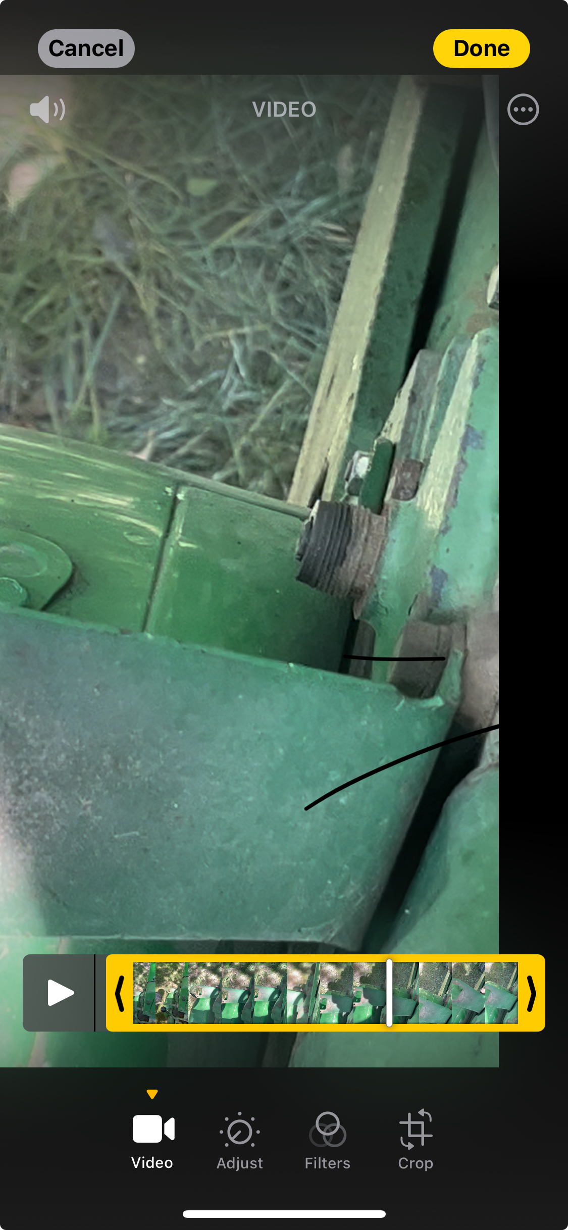

My 60 has some vapor coming out of the speedometer/tac cable attachment point to the power trowl.
Is this just normal windage/pressure that is escaping because I do not have the cable attached, or is this an issue I should look into further ?
There is no oil or moisture evidence running down this threaded port, so I am assuming this is just normal windage pressure.
Pics are from video that was too big to load here, 2nd pic shows white/blurry out of threaded port, that is the vapor.
Thanks

It is normal windage/pressure that is escaping because you do not have the cable attached. If no cable, there is a cap you can screw on with a rubber gasket. Or just put on one of them plastic caps. Keep the dirt out, vapor in.
