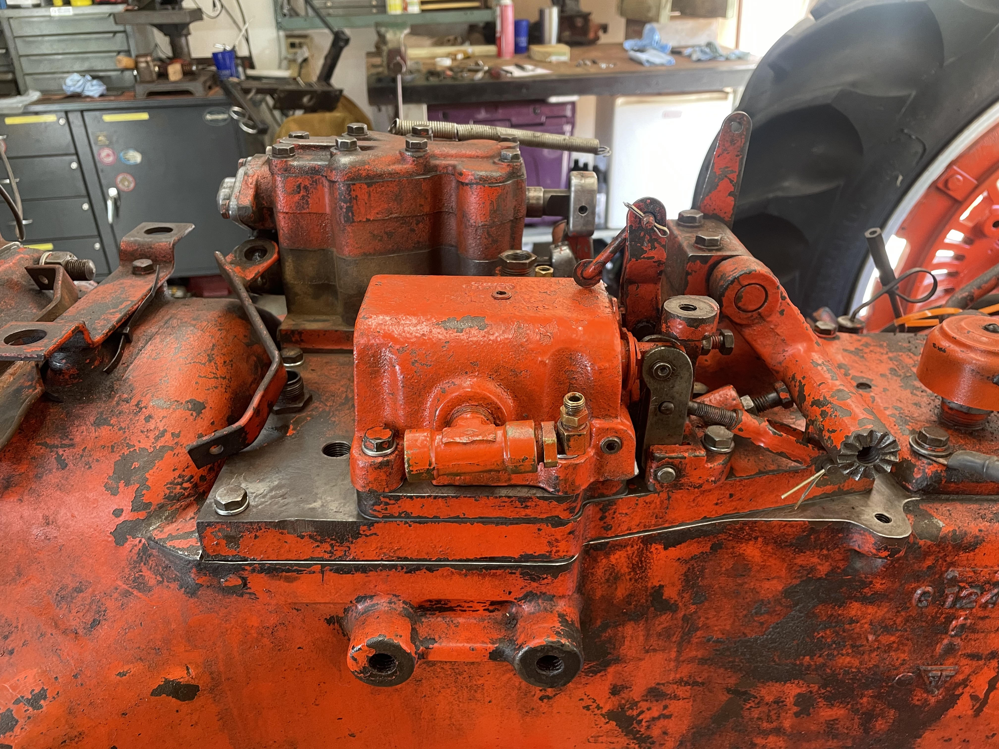

I have Completed the Case somatic overhaul for my 611 B several months back. I’m just now getting to the point of taking it for a test run. The main valve body has two spools, and even though I replaced those seals, I am still getting some minor weeping. Clutch pressure is just a little high at 180 pounds,So I believe I will go ahead and remove one washer, which is an accessible between the two spools. That’s called the clutch pressure regulator. Chuck Machinist.
Sorry about that. The photos did not load the first time. Chuck Machinist.
