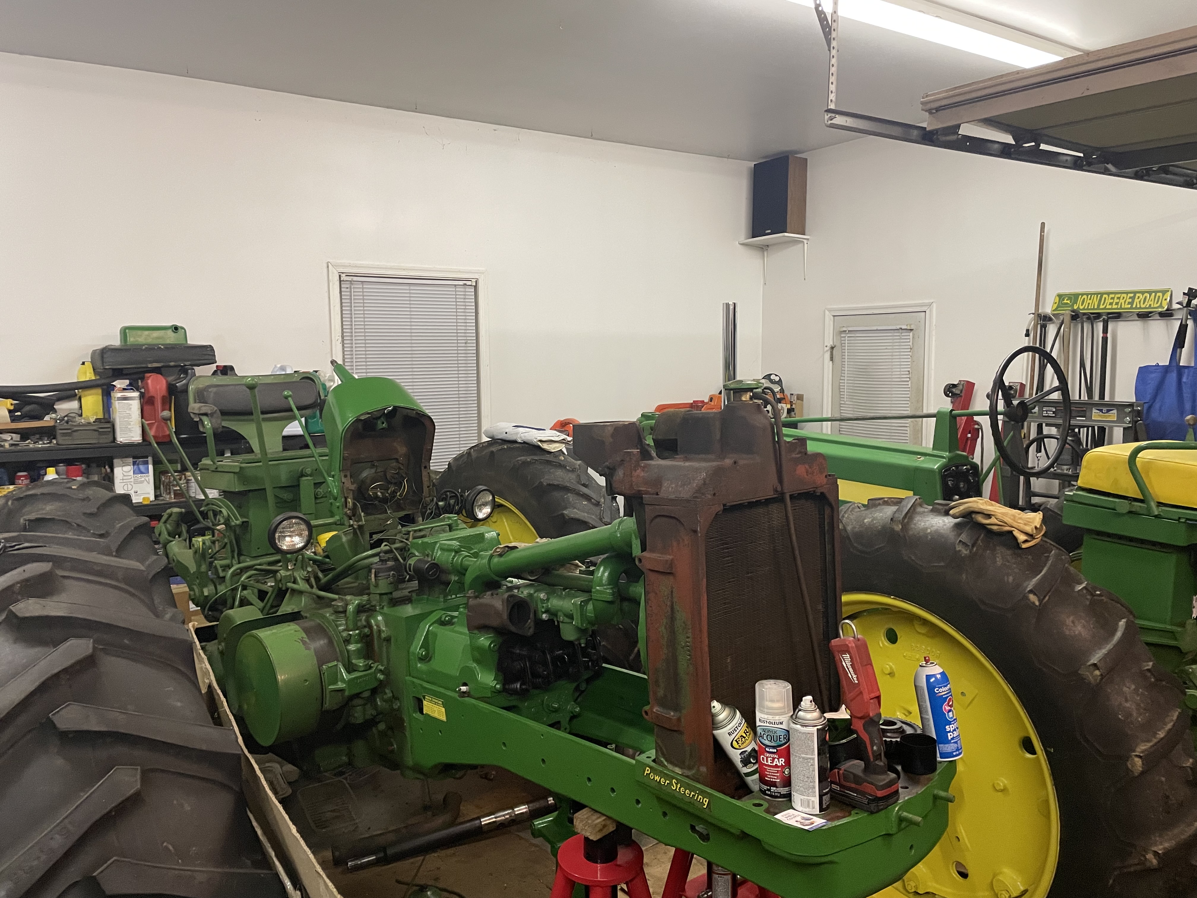

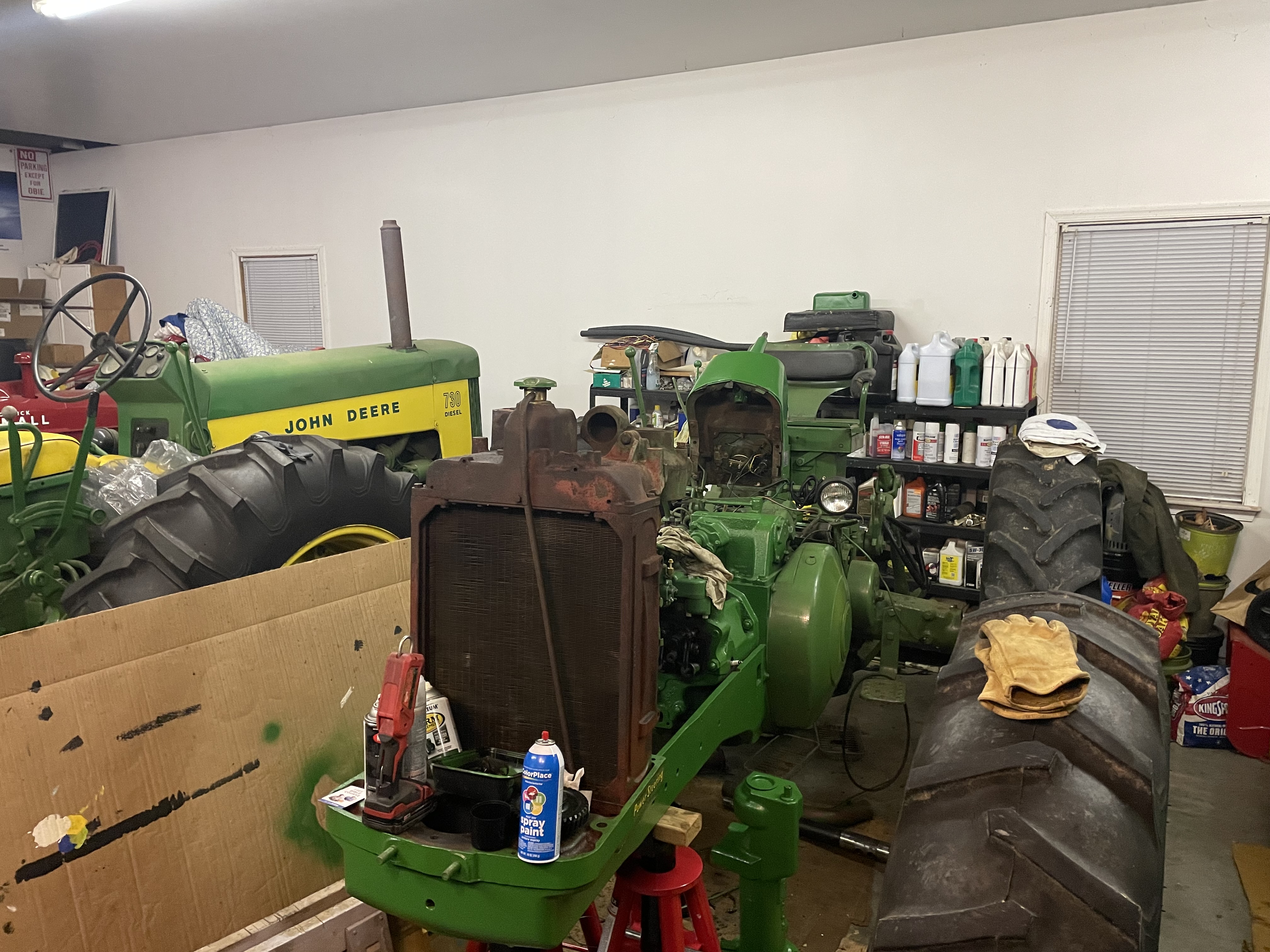

Mine is in a similar state. Haven’t had any shop time in a few days, need to pickup a radiator pressure kit from HF one day this week.
