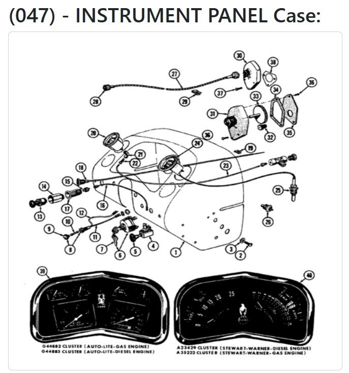

This may help in that my gauge cluster (1962) is a Stewart Warner that Case used on all early models 300, B series, and I believe early 30 series. Your's is a Auto-lite and most likely is a 1963. Probably was some cross over so can not be definite.
The pic showing the back axle looks like a model 641 general purpose 630 tractor.
TG I thought you had it nailed and you could still have it but there is no before/after serial nr for the change over from SW to Autolite instrument cluster in the parts manual. John is going to make or break our guesses when he sees that brake drum cover.

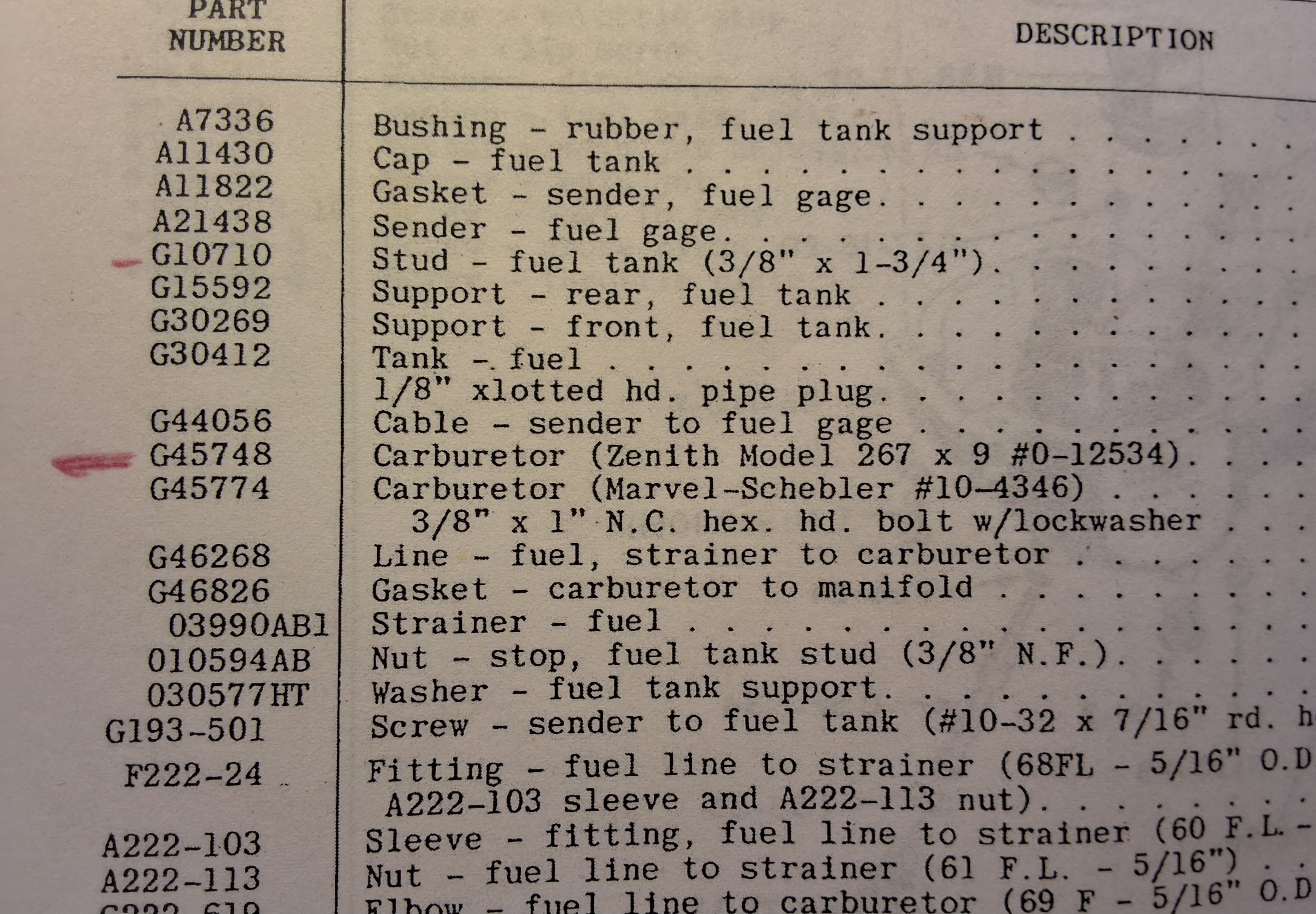

I've removed the Carb from the tractor and located the ID tag on it. After cleaning the tag it revealed 2 sets of numbers, GA5748 and below that number 2534.
The Case P/N from the Zenith parts illustration is A35817. Does anyone know is the GA5748 a Case P/N? Is the 2534 a Zenith P/N ? I'll be ordering a kit but want to order the correct one for this carburetor.
Here's what my parts book shows . . . .View attachment 152731
Tg,
Thank you for digging this info out. The inside of the carb is really dirty& oxidized. Can only imagine how the internal passages look Also found the carb to manifold gasket was missing as well as it was missing one screw fastening the upper & lower body together. I'm going to clean this in an ultra-sonic cleaner I have ordered. Installation of new jets and gaskets should go a long way to improving the tuning of the engine.
