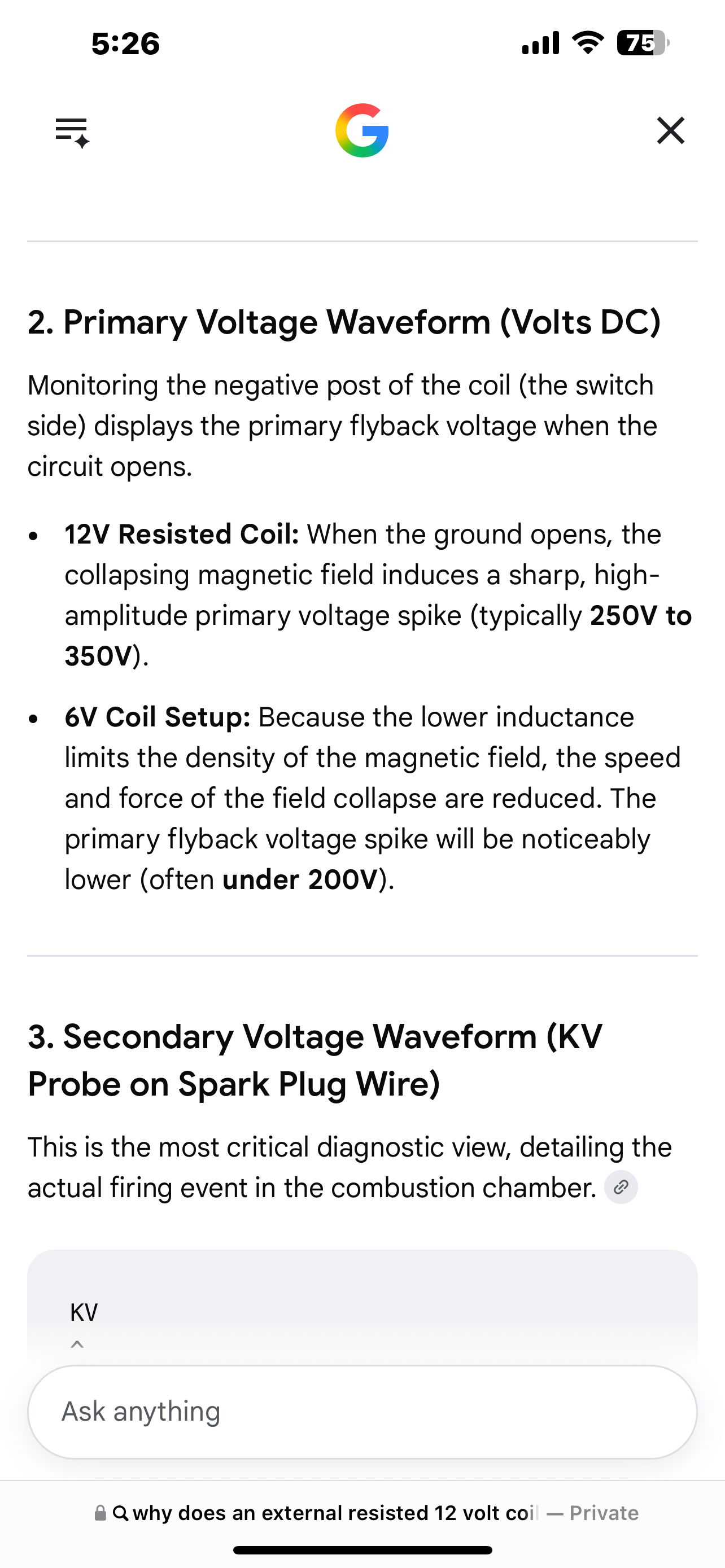

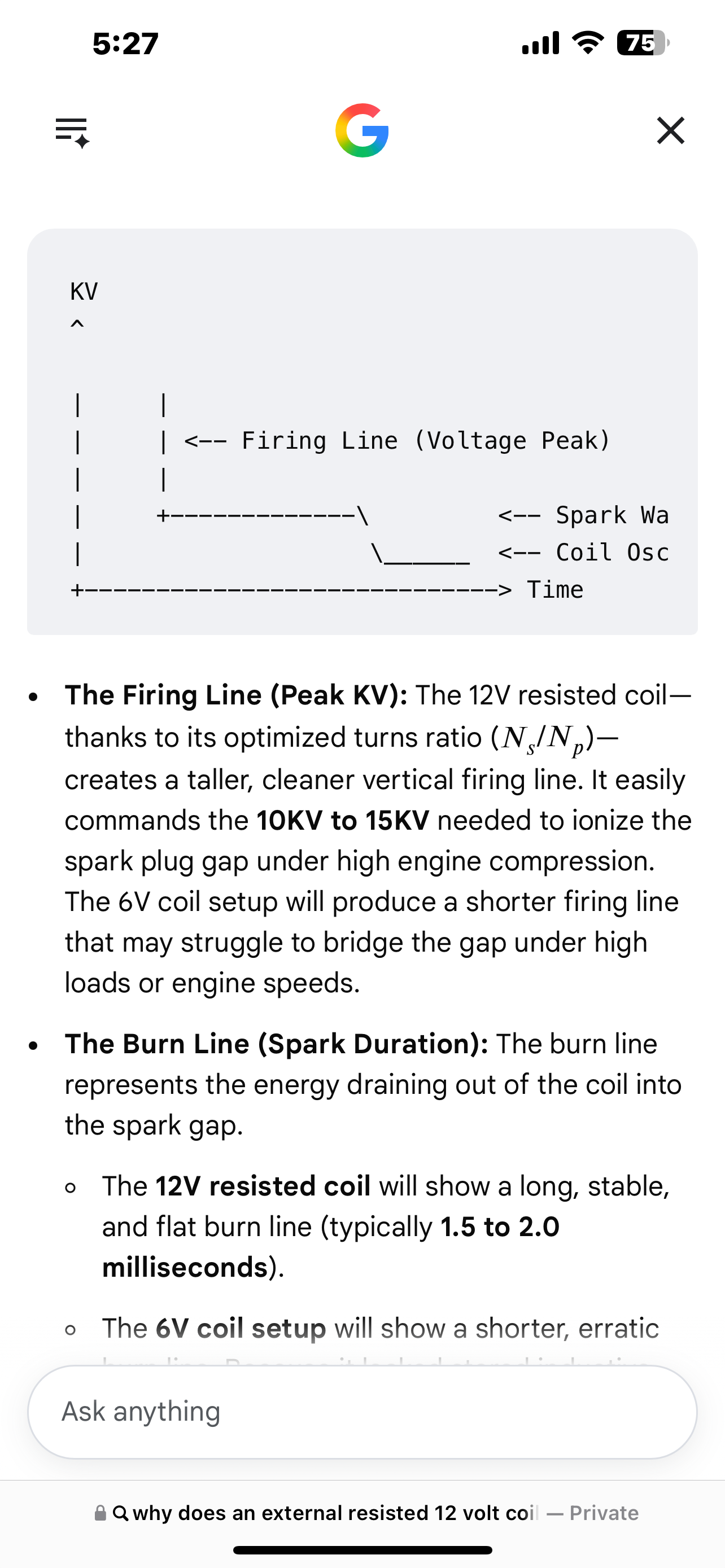

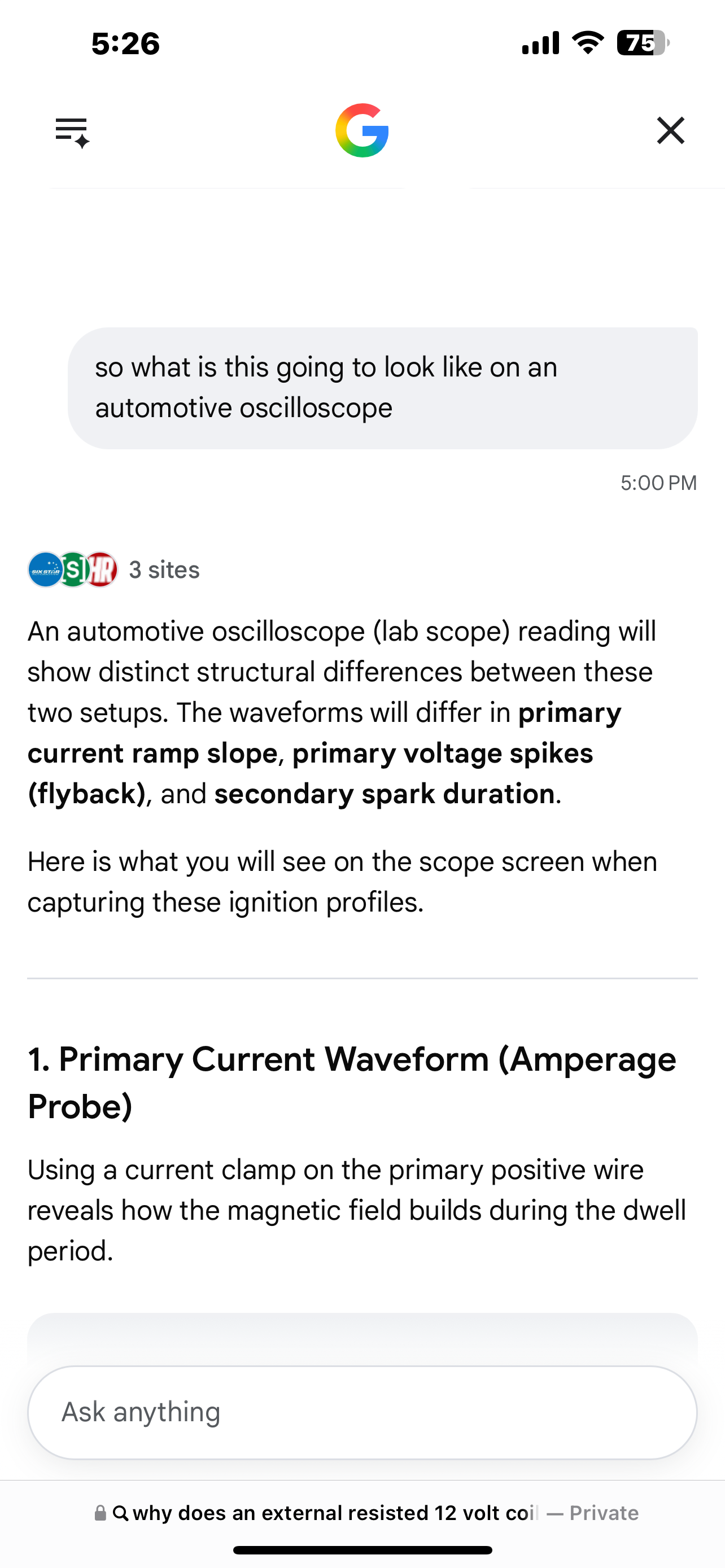

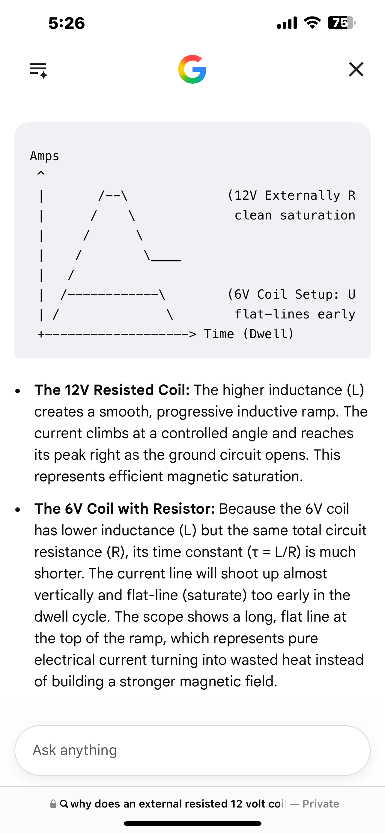

Pix 2 today we call coil ramping its common to check coils this way and the most effective fast way. On modern vehicles its not easy to scope the secondary and normally not worth the time it would take. Then add in one small mistake the possibility of damage to your scope. Today we have misfire counters that are fairly accurate so unless you are a ungodly fast scope guru that only works on one make and model and the coils are EZ to access follow the code/misfire counter. If I have to pull a scope out I am in deep do-do.
4) Spark burn duration (burn time) is what is going on in the cylinder, Lean, rich, low compression burn that into your brain life will be good. I have not read all you posted I still have a day job.

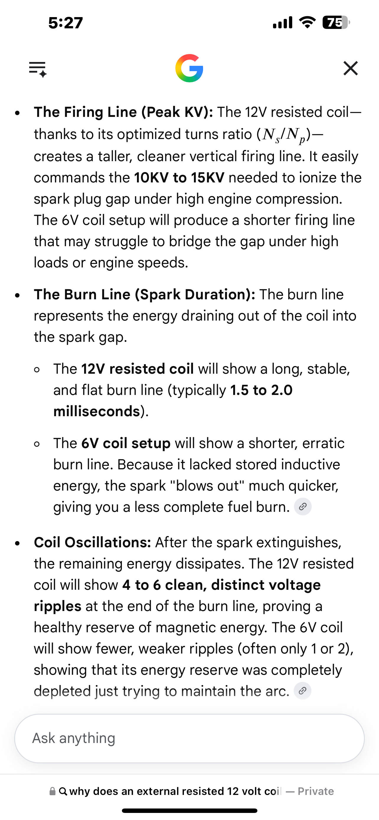

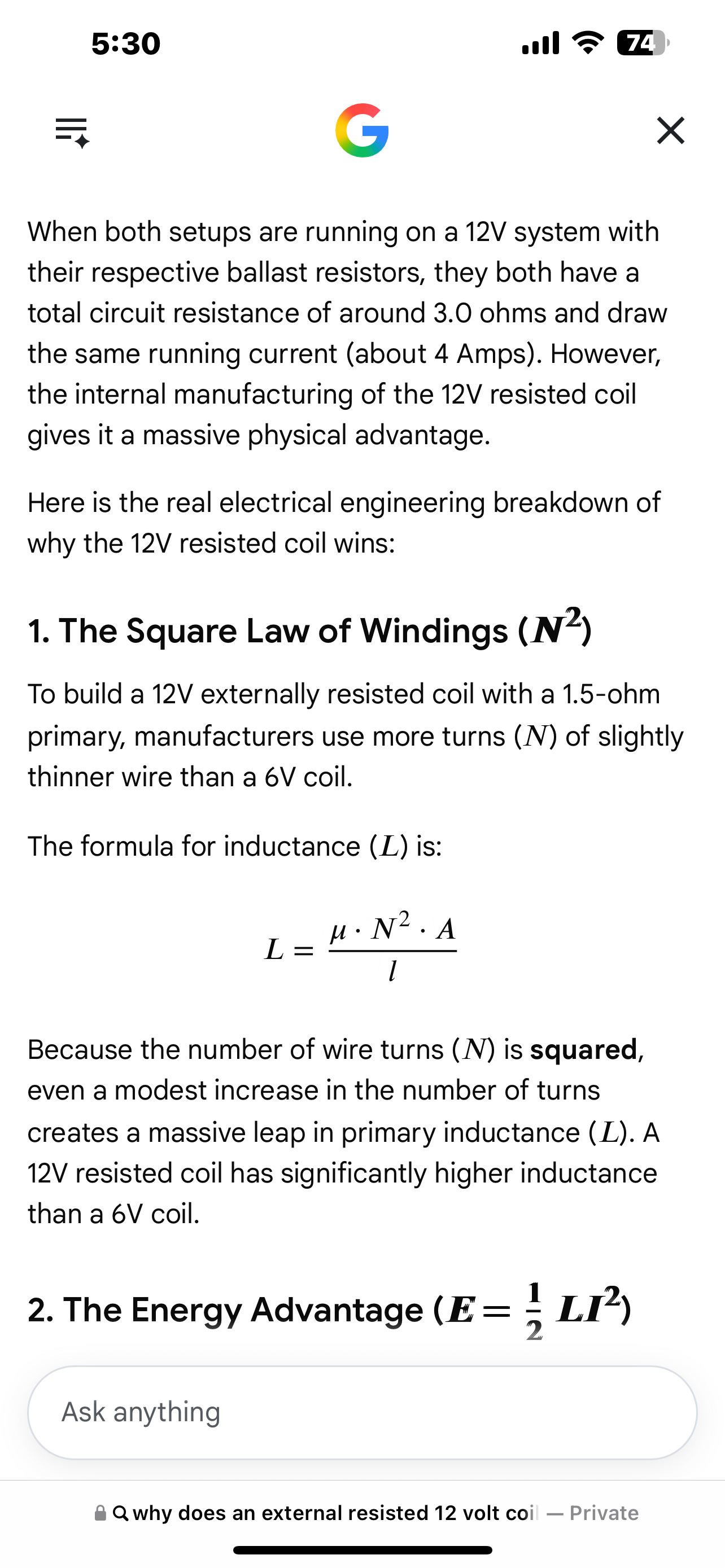

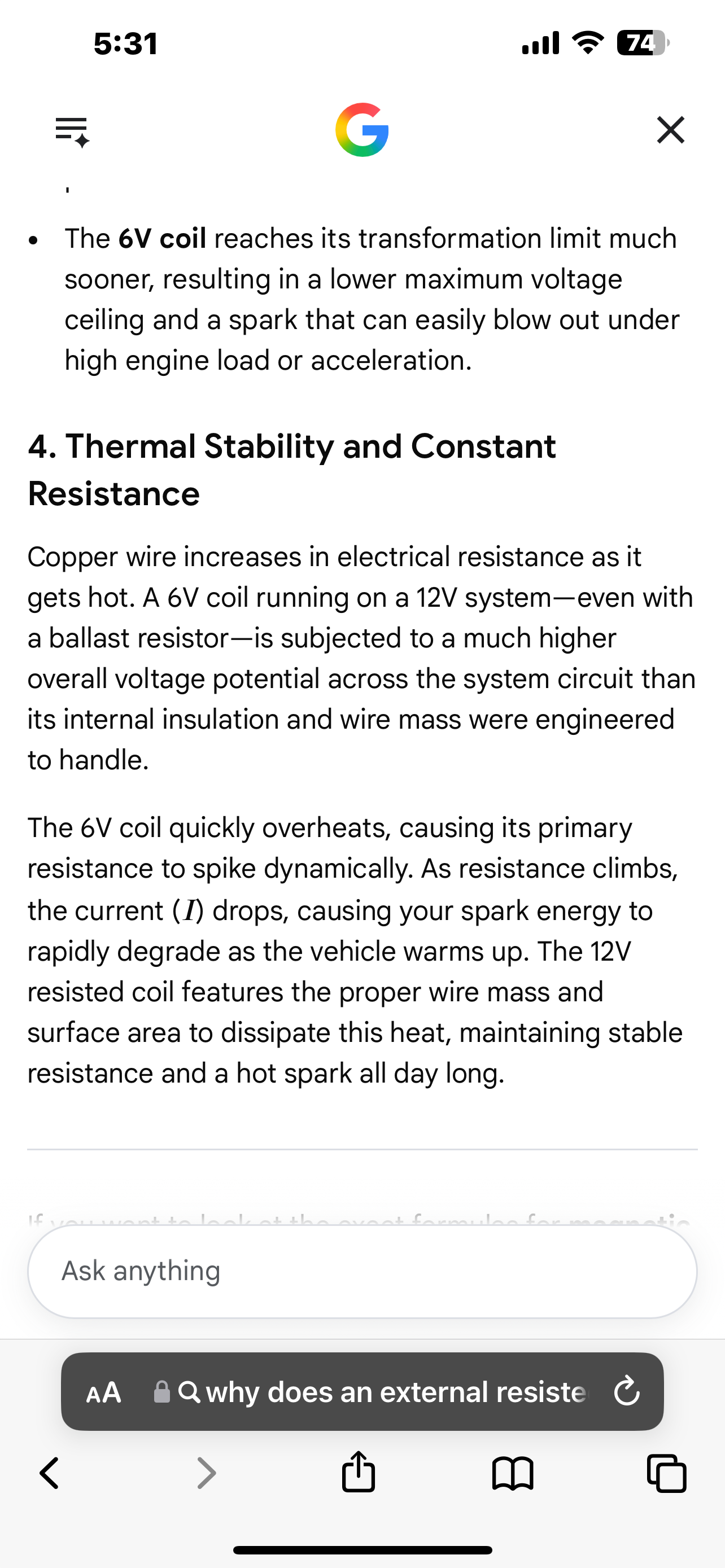

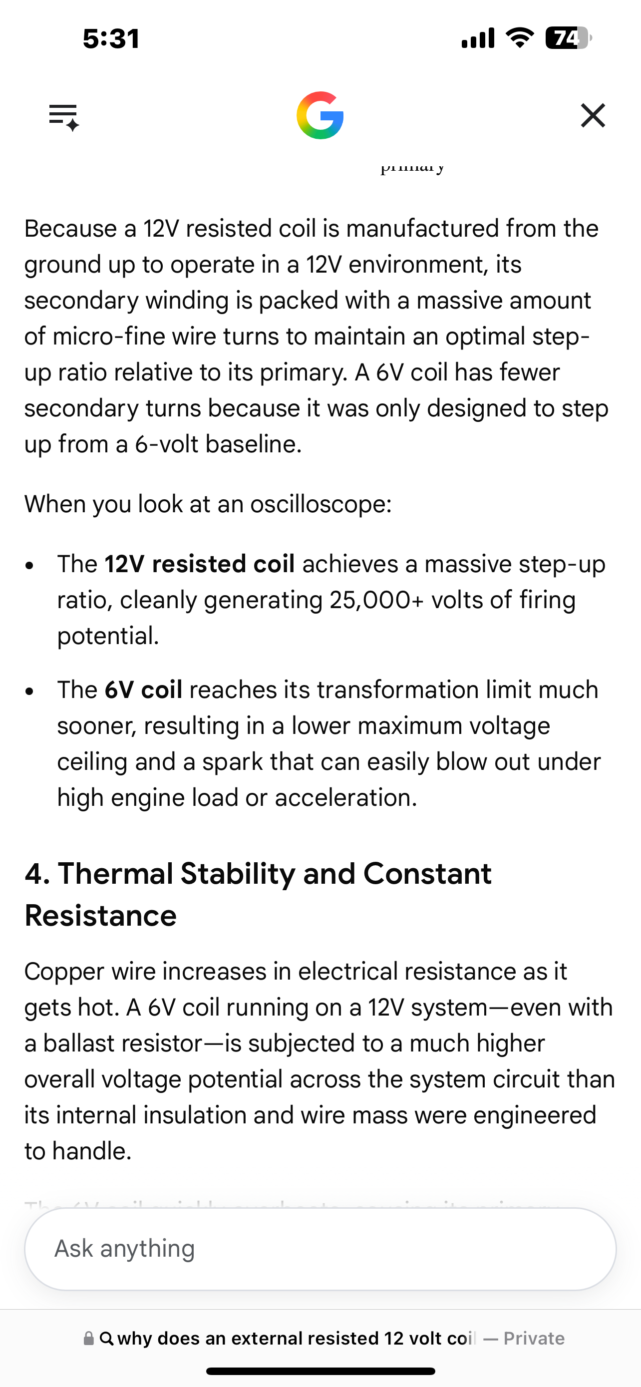

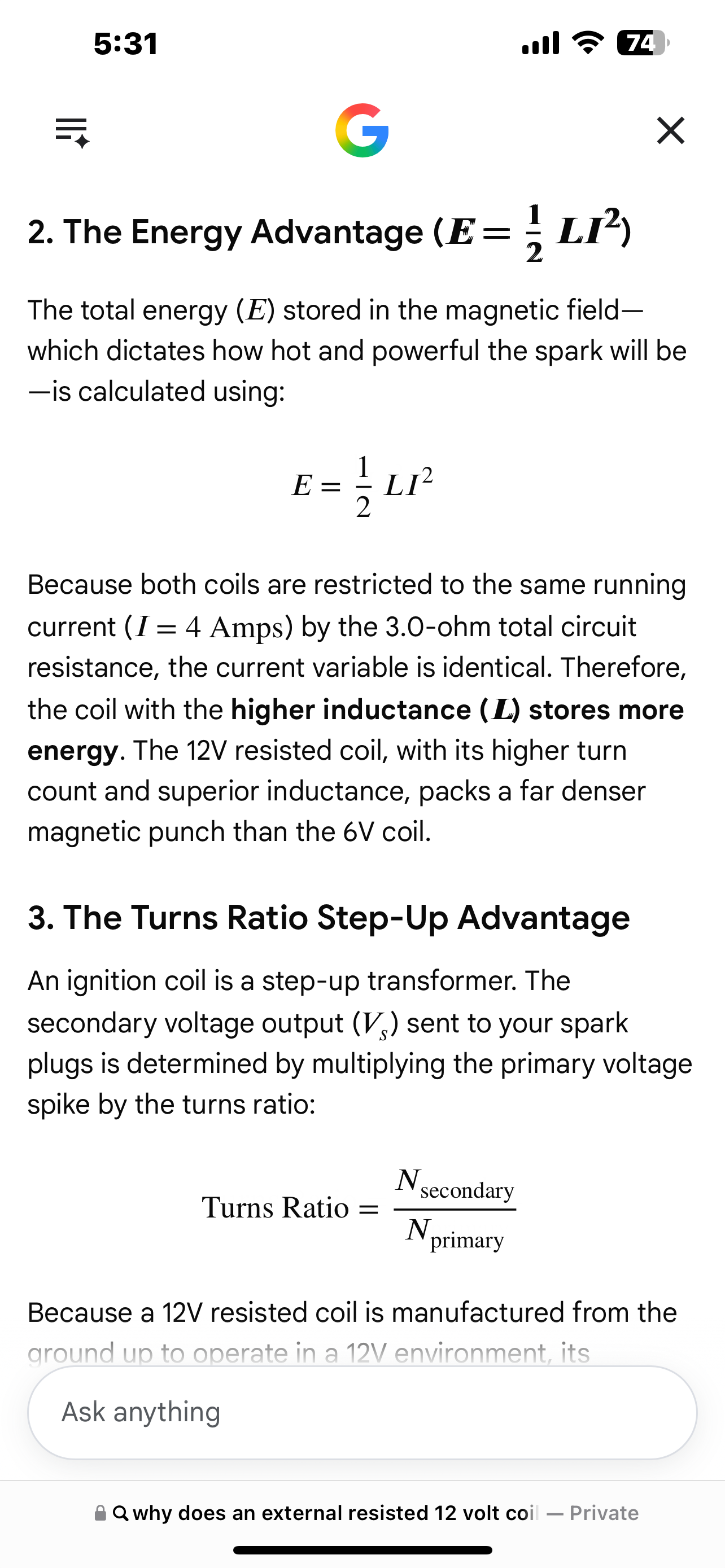

Not to worry my scope is a Sun model 1120 , currently 57 years old and points ignition only . I was giving everyone a chance to prove their point which of course no one did . Plus I was limited on how many pages I could post at once . Standard Electrical engineering was over 30 pages . GM Electrical engineering course for Mechanical Engineers got me down to about 20 pages . So I dumbed down to 1978 Freshman class Voc - Tech high school Auto Shop course using my Sun Scope to eliminate everything except points type ignition and that got me down to 9 pages .
Please, read post #91 again.
Same coil with same voltage drop, what differs?
Do you know how to read ? The first paragraph on the first page clearly explains it . It is TWO different coils both with 1.5ohms resistance so both coils require a 1.5ohm resistor to be used on a 12 volt system . This is all based on a 1978 high school Auto Shop basic ignition course using a 57 year old Sun model 1120 Scope . I can’t dumb it down any further because I never saw a basic ignition course taught in pre-school , kindergarten or first grade . So if you can’t comprehend 9th grade I don’t know what to tell you .
Oh my goodness! you just posted the exact thing that you said wouldn't work!
That states that a 6 volt coil at 1.5 Ohms works with an external resister of 1.5 Ohms in a 12 volt system just fine.
It also states that the newer designed coil works better. Something that no one here has a problem with. At least I don't, because that's what I replaced my 6 volt coil with when it finally died.
