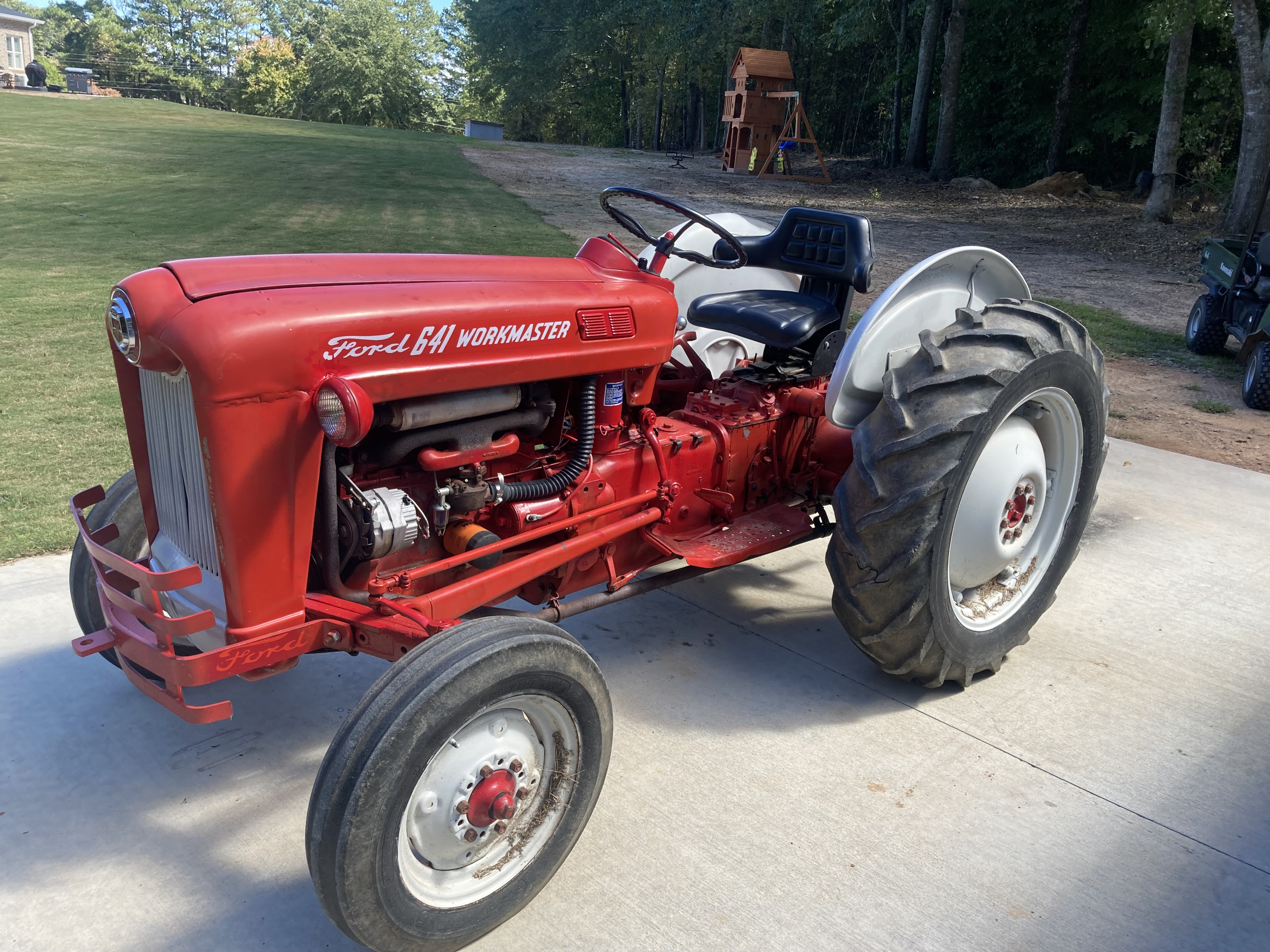

Hello all. I wanted to post this in hopes that it might someone, sometime. It’s long but, I think you’ll understand why. I have a 1959 ford 641. This has been the most reliable piece of equipment. About a year ago I did some bush hogging. Shut it down no problem. A few weeks later went to crank it and had a no start condition. Well, there just aren’t any mobile tractor guys near me. So, I started to work on it. Short story, I replaced just about everything on it. Have the shop manual, nothing. A week ago I talked with a heavy equipment guy. He came over and at the end of the day he was just a frustrated as I was. Said there was no logical reason for this. During the week, he contacted me several times and gave me some things to do. While I was poking around, I took off the valve cover (had already ruled out valve and others - great compression, etc.). Wanted to see rocker arms, valve springs, etc. to be sure. Well, I started cranking and, holy motley it fired right up. I mean as soon as I hit the starter. WOW, now I was going crazy. But guess what’s on that valve cover - a valve vent. Cleaned it up and it’s back to it’s old self. Putting on new filter and ready to get back to it. I really hope this might help someone with a similar problem.

PWhite, welcome to YT! You should have place this in the Ford forum in the manufacturers section, more relevant to the topics there. I am glad to hear your tractor is running again. However, I am going to say that the fact that your tractor started with the valve cover off was strictly coincidental or “luck of the draw.” Some other problem was the cause but apparently chose to correct itself. If the space under the valve cover which is connected to the entire crankcase (space above oil pan and around crankshaft)built up pressure for some reason the engine would still start. It is more likely that in the process of removing the valve cover you moved a wire or time allowed something in the ignition to dry out. There is just no reason for the engine to not start if pressure has built up in the crankcase.

I had a no start that was hard to figure out.
Using basic electrical diagnostic tools, I found the insulation around the bolt going thru the side of the distributor had broken down.
Silly little problem that stopped the tractor dead.
HTH
