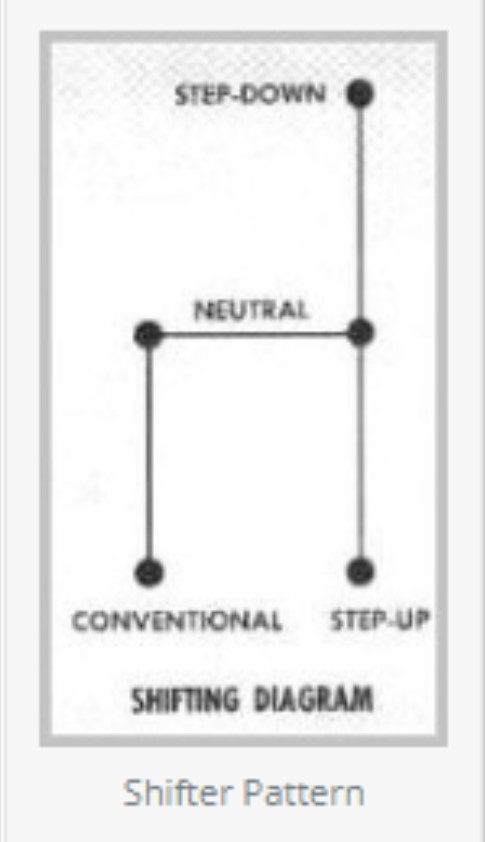

@fran213, did you get your Sherman to shift into anything other than high range? Are you sure you're not just getting neutral/conventional and not able to push shift lever in far enough to get to low/high range?
