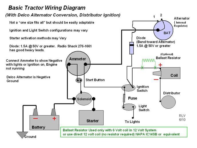

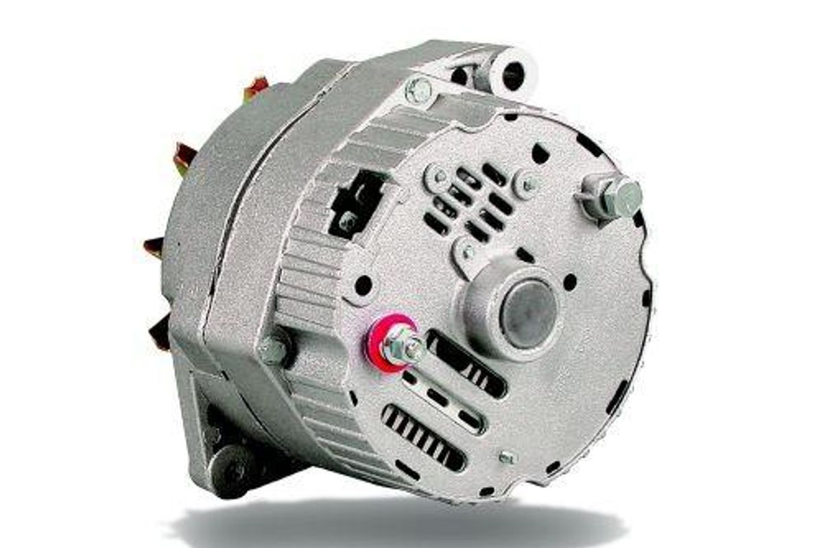

To make sure your alternator is not part of your worries:
If it has an internally regulated 12 V alternator, with 3 places for wires, or a Delco 1 wire, I'd rewire the alternator according to the multitude of schematics on this site (Search 12 V alternator conversion). Then you won't have to worry about that part of the electrical system as you work through the rest of the issues. If you are not battling with an external regulator, it's really a simple wiring system. This assumes the tractor is negative ground.
Almost all 12V alternators will have 3 terminals. This is a Delco 10SI style. The large stud with the red washer in this picture takes at least a 10 gauge wire, which goes to one side of the Amp meter gauge on the dash. Or to the Positive battery terminal as a temporary connection while you work out the rest of the dash wiring. The other two tabs (directly above the large stud) can be wired several ways. So look over a schematic and figure which way you want to go. Most other brands have similar wiring tabs and lugs. Here's a generic schematic for wiring a 3 wire alternator:
Of course, with a diesel, you won't have a coil and distributor circuit. And I'm of absolutely no use on your diesel engine issues. But if you describe them well others will be along to help. Pictures help a lot.

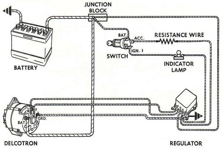

Your MF 40 may have an externally regulated 10DN series, as shown in the parts book. Those have 3 wires with two going to an external regulator. Two of the wires are in a plug that goes straight into the back, rather than the side as in the 3 wire internally regulated alternator stevieb posted about. It is best that an alternator not be run without a battery hooked up. If you need to run it, I suggest unhooking, and you posted they are unhooked, all the wires from the alternator and securing the ends where they will not short out.

Here's a schematic for the externally-regulated 10 DN that Jim mentions:

The answer to your question is YES. The engine in your tractor will start and run with only the starter wired. I would go through the fuel system and get all the air bled out to get the engine running. If it runs well then tackle the rest of the electrical system. And be careful with the starting fluid as too much can damage the engine. Bleed the air out at the fuel filter then, open the bleed screw on the side of the pump and spin the engine over. You should have a good stream as the engine spins. Close the bleed screw and at the injectors loosen the fuel line at all 3. Just loosen the lines . There is no need to remove the line from the injector. With all three loose spin the engine over while observing the open fuel lines. If all is well you should see fuel at all 3 connections. Now retighten all 3 fuel lines at the injectors. If you have a good strong battery that spins the engine fast your tractor should now start and run.
