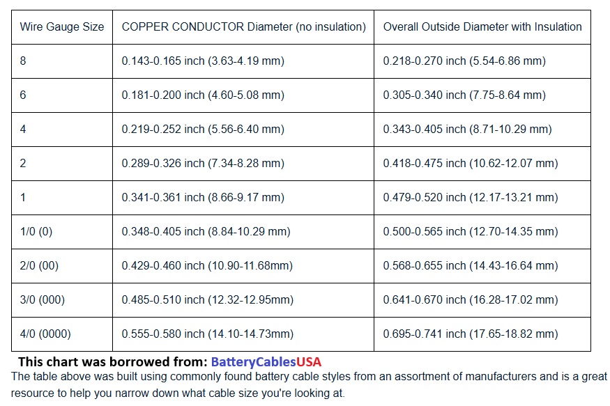

I am probably wrong on the size #. It's a typical battery cable. braided core is 7/16 or 1/2 inch diameter. The bolt goes through the dash support into the steering box. No sign of overheating and engine now starts on 3rd or 4th revolution.
I would say you are off on the size. This chart may help you.
