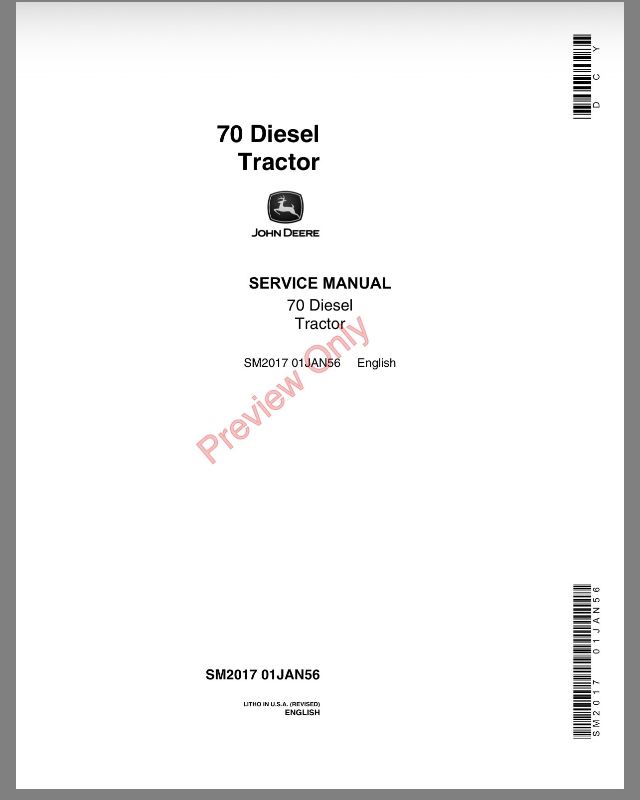

There is NO factory deere service manual for a 70 gas though, so it wouldn’t do any good to call other than waste time on the phone 🙄.
The JD Publications site appears to say otherwise SM2025 would be one. JD techpubs
I have it, along with pretty much every other two cylinder book. The ONLY thing in that book that is specific to a 70 gas is the pulley brake adjustment. The engine, transmission, hydraulics, pto, is all for the 720… The book shows the head torque of 275 for a 720, and nothing for a 70…
Regarding the 70 gas . A 70 diesel manual would provide some specs omitted in the 720 gas manual
My apologies, I see that is for the 70 diesel! Should have been sleeping instead of posting.

70 diesel is close with everything except the engine though... That's where I need the correct specs, is the engine. The only thing really interchangeable on a gas to diesel is the oil filter when it comes to the engine. Different bearings, different bores, different valves... All different between a diesel and a gas, and again different from a 70 to a 720... I know you don't like the IT books, but where did they get their information for a 70 gas? I doubt they pulled it out of thin air. I know the torque specs I was talking about, I'll probably just go with the 208, but it just doesn't make sense that deere didn't publish engine specs for a 70 gas... I know the all fuel is basically a styled G though, but head and block are different to a gas.

Head , main ,rod , flywheel torques are identical . Most clearances too .
