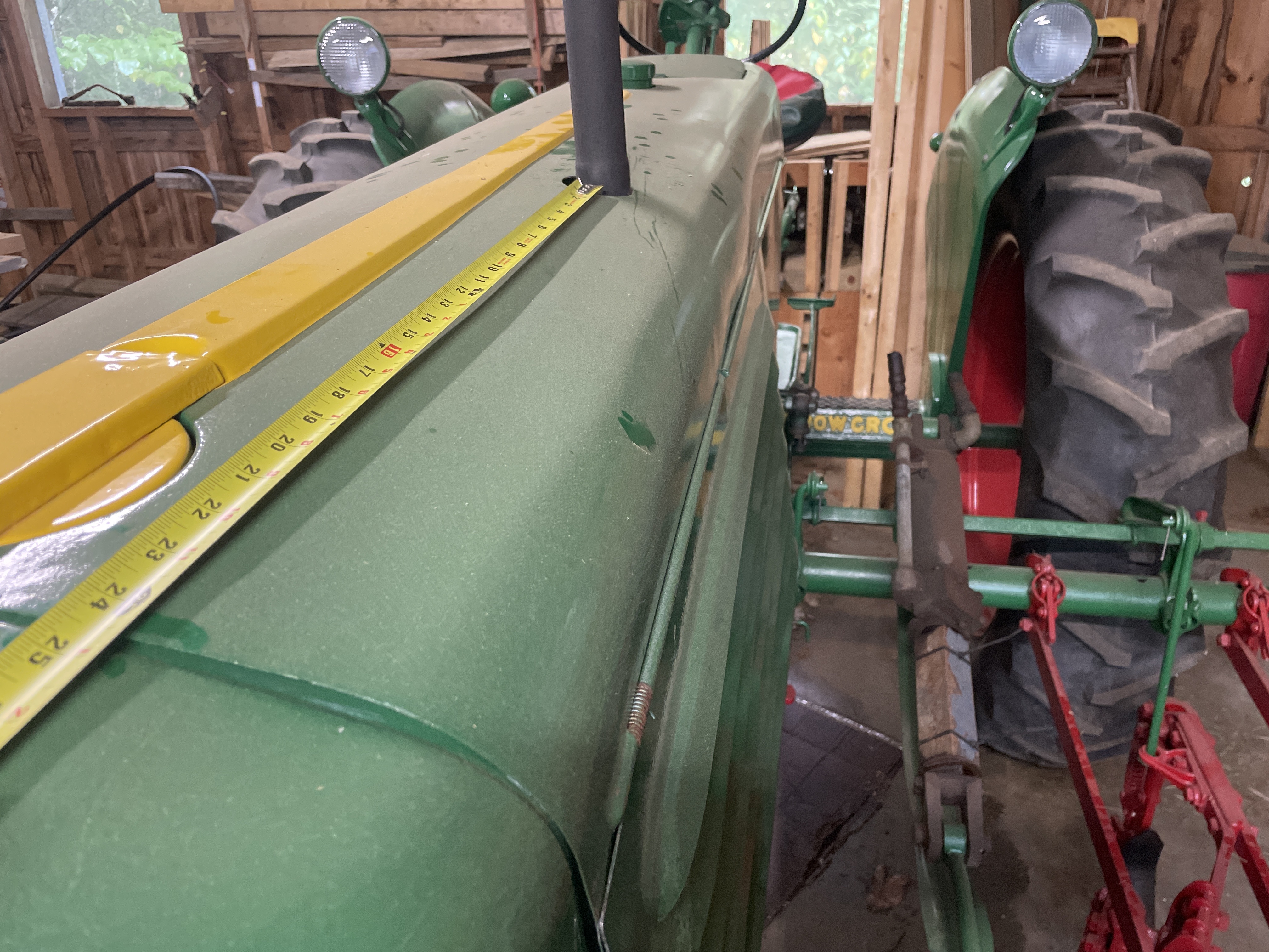

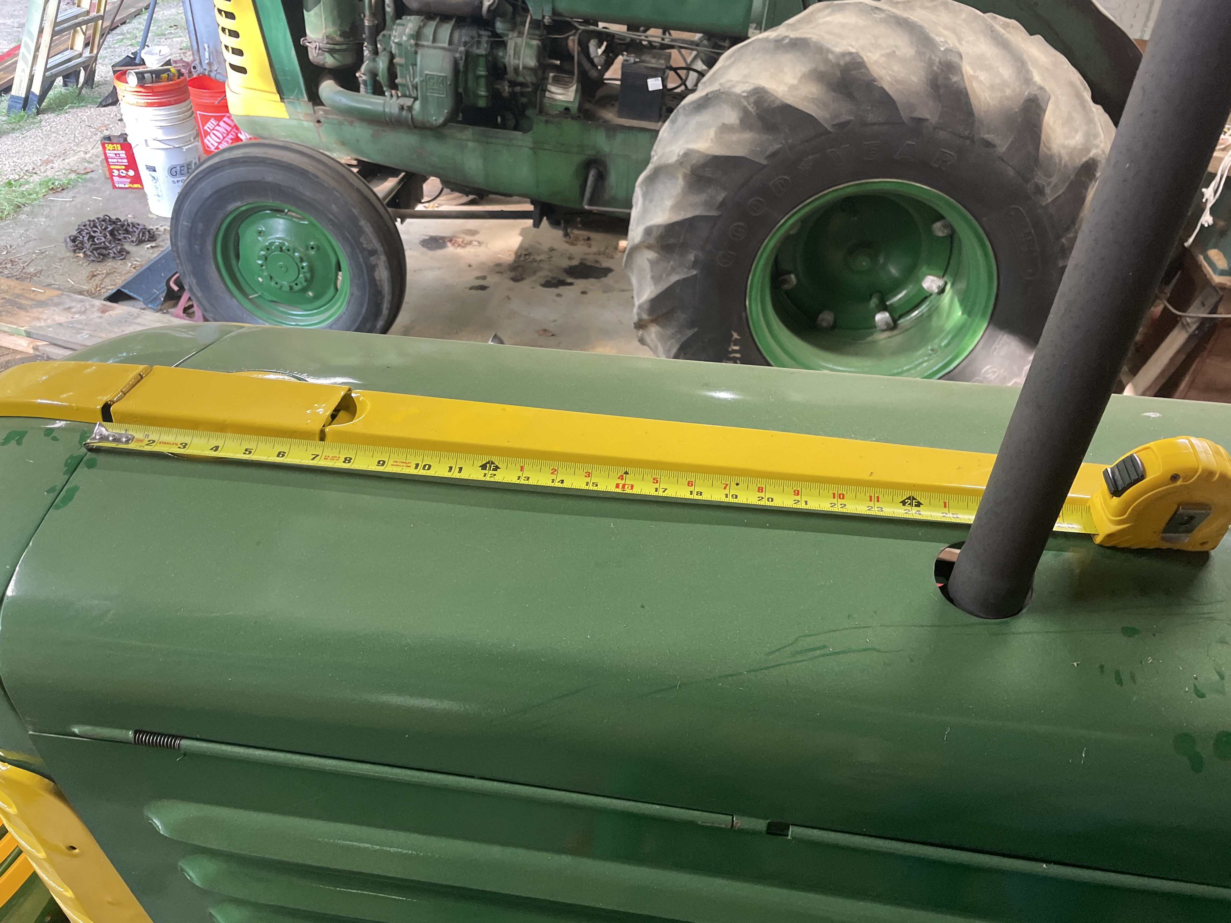

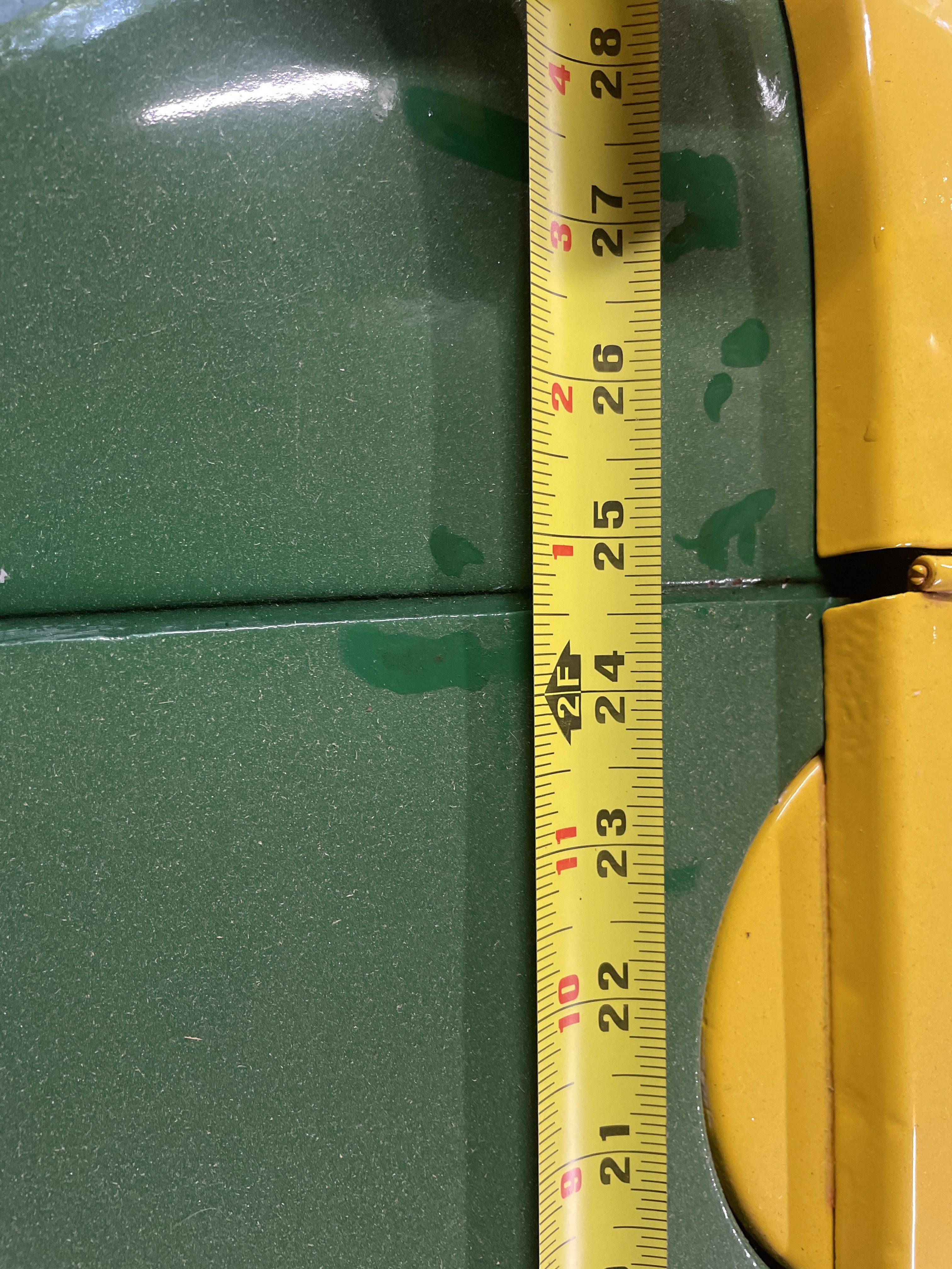

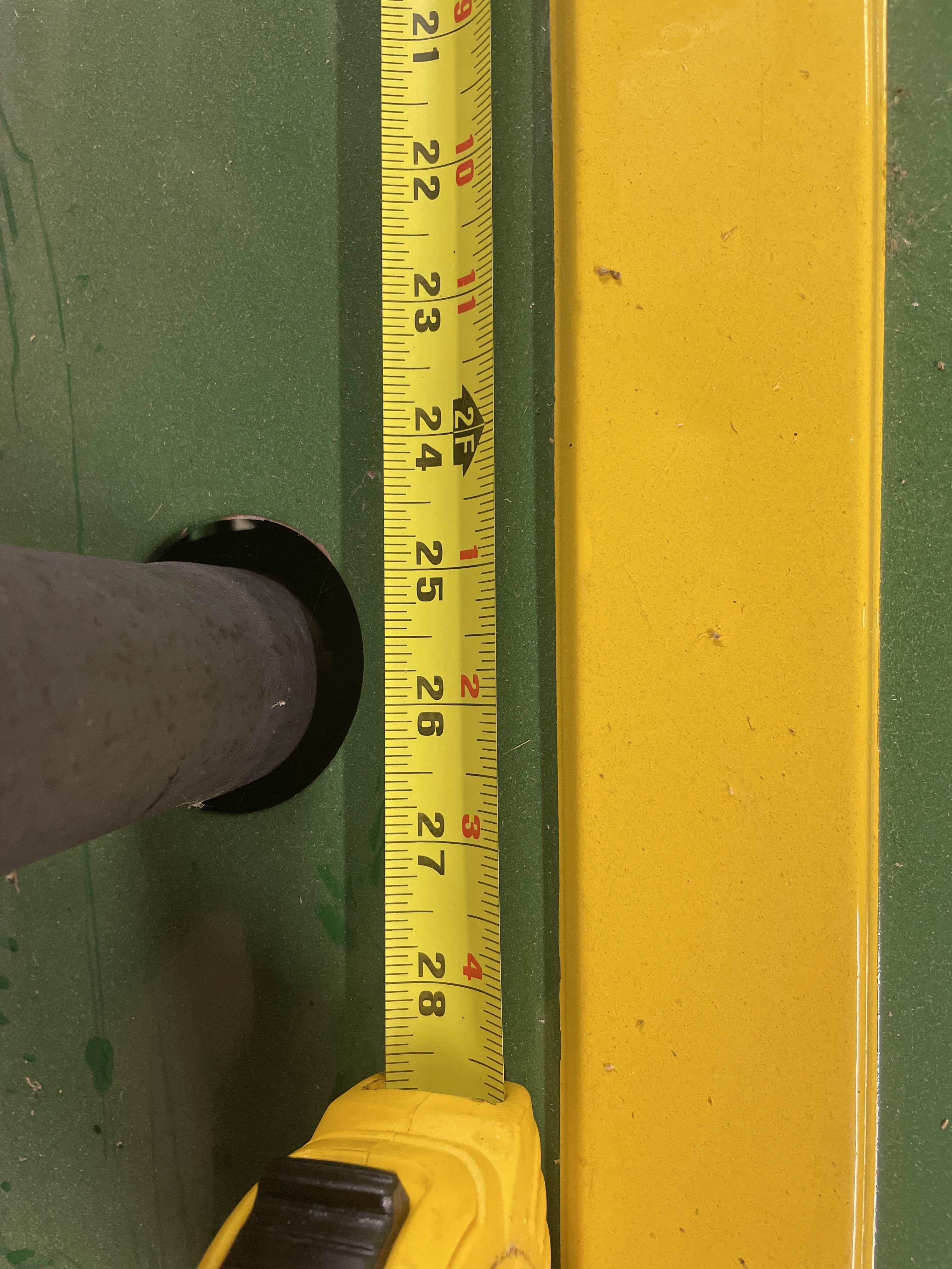

I have a nice straight 77 hood but like many it was cut for a bigger muffler. I’m going to weld a patch in. Does anyone have measurements to locate the center of the hole in the patch? Thanks.
