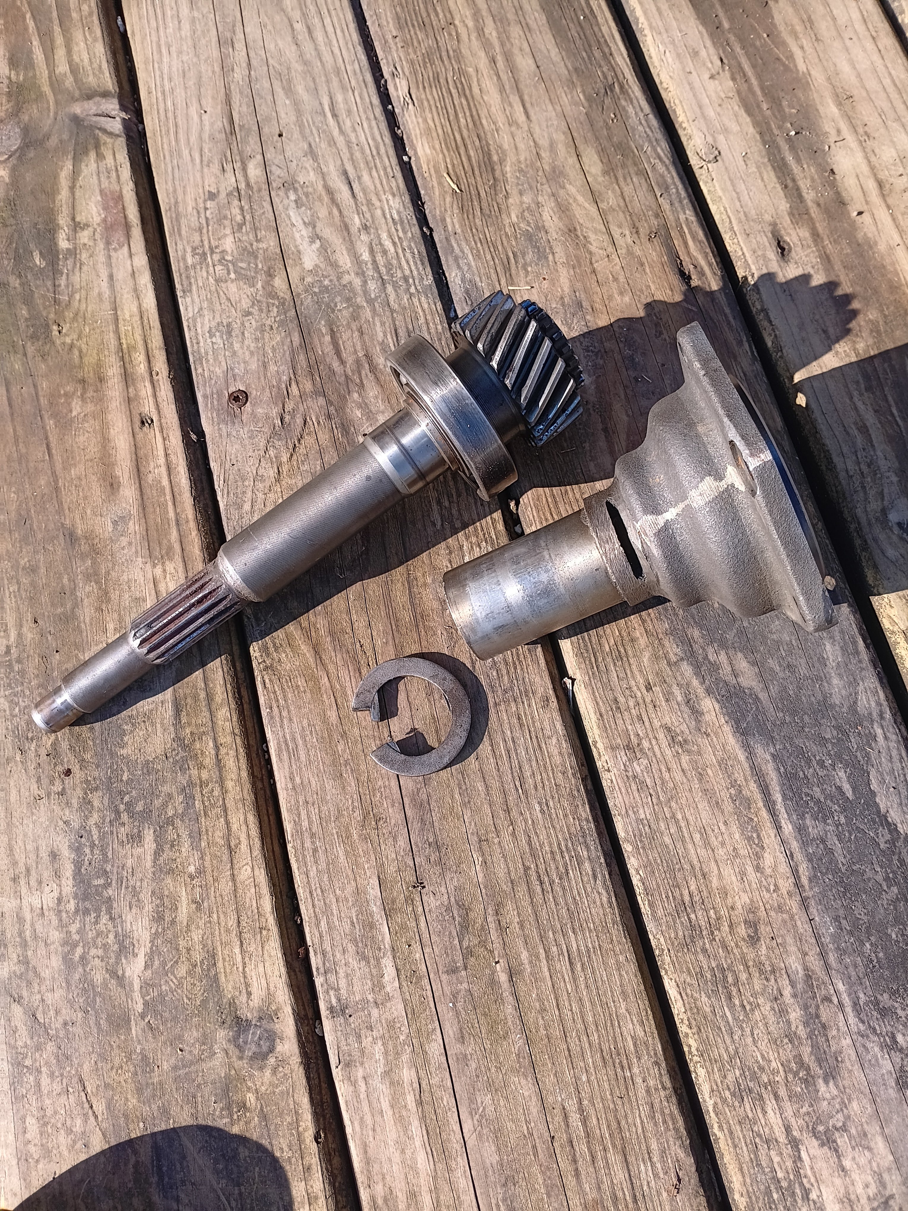

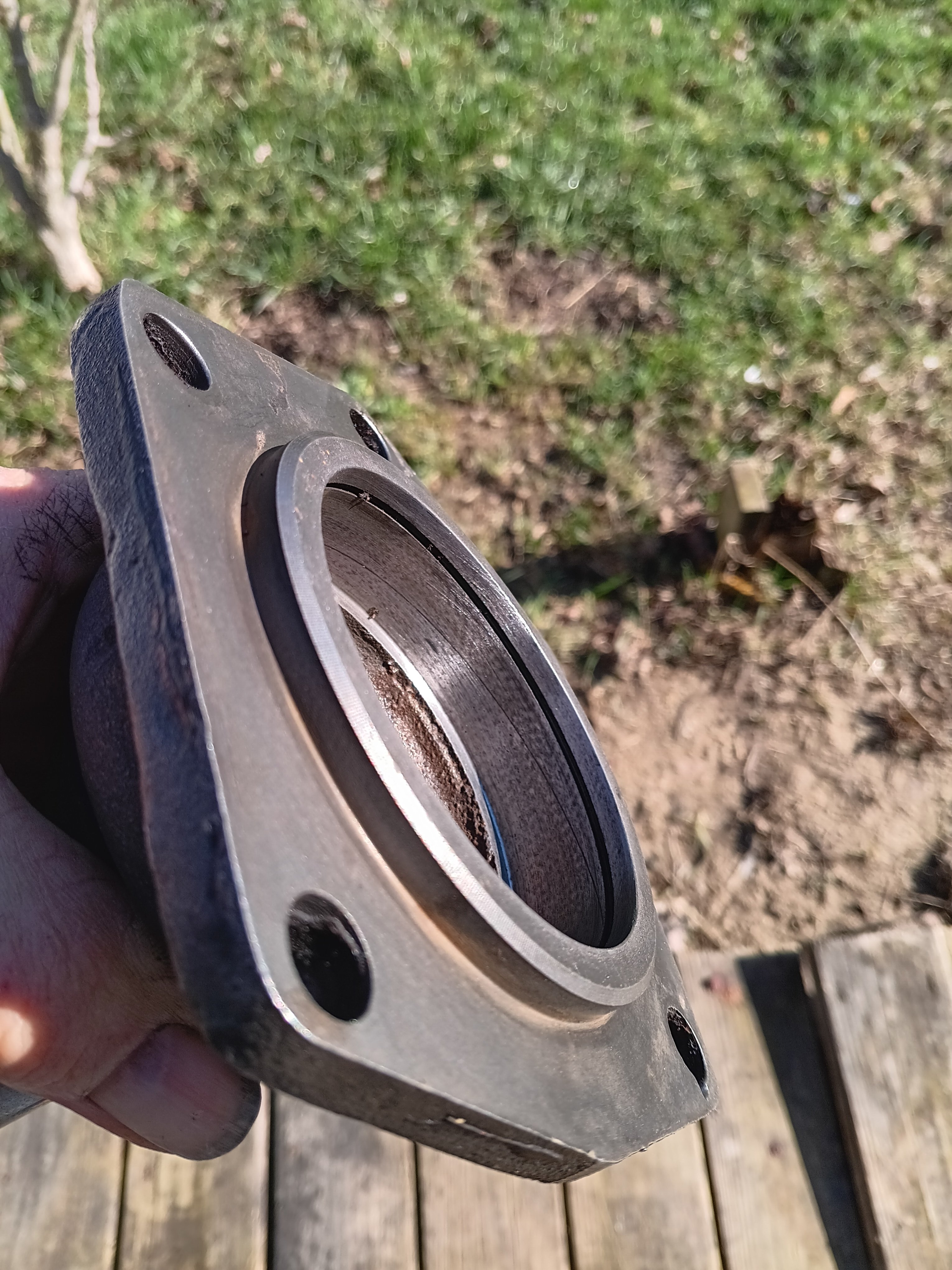

Ok Sean ...so I went back and found some pctures of when I changed the miserable seal and bearing...what a miserable thing to find the right bearing and seal...I remember spendng a week trying to just do that...but I dont have any pics of the gear I was describing to you...but it had to move in and out of this pinion gear for back and forth direction of the main shaft.....I read somewhere that Warner/Swasy had a set up like this as others but who made this I dont know...

Idid what you said and yes I see the spline from the trans thru the shift lever removal...Now the big welsh plug needs to e kknout out and somehoe find a correct length of a PO shaft and a shift lever cover ...I dont think I have the 100 series rear end but a !000 series...so that I hope I can figure it out...

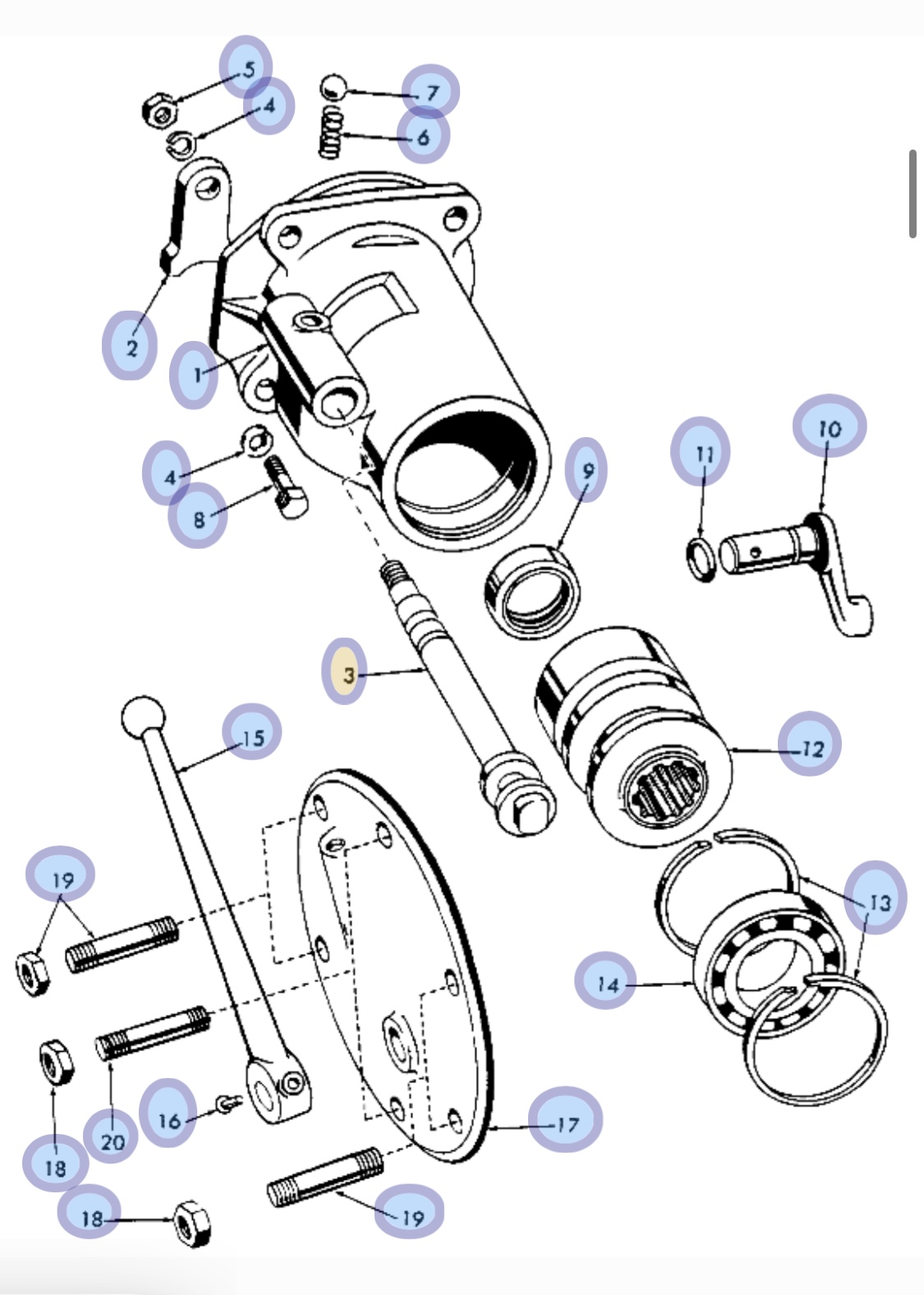

The hundred series and the 4 cylinder thousand series have the same components but that is a hundred series rear end. It was cast on June 27 1961.
151297 is a late 1961 built tractor.
First thing I thought of when looking at that 3 spline chain gear was the Elenco also as that would only be driven when the tractor is in motion.

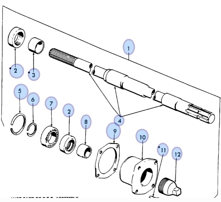

If you can see the spline PTO shifter you will need the side cover and shift rail along with a complete PTO shaft with the seals and bearings.

Ok thanks for the diagram....so are yiu saying then that I have a hundred series rearend then ok .....and the tractor was built in late 1961 then thats helpful...thanks...!,
And so with the pictures I put on here ...your thinking I will need the complete shaft and bearings and seals ,,,and I will need the coupler also .. and I would need a shifter plate and lever assembly too.....is there anythng else I would need ? .I can get the PTO assembly and coupler new but cant seem to find a shifter plate assembly...would one off a earlyer tractor like an 8N work? so I will have to get one out of a tractor salvage yard ...and I dont have a shifter plate to take off to know if I am missing anything and the diagrams help but does not have discriptions ..so Im not sure if Im missing anything ...what is this shiffing rail and shifting rod things im reding about ? does my pictures show I need them or doe my tractor have that from what ou can see?

The shifter plate assembly from any 1955 through 1964 Ford tractor should work. Anything in the 600, 800, 601, 801, or 4 cylinder 2000 or 4000 series, with the exception of the S-O-S models, of course since they had a cable controlled, hydraulically actuates, independent PTO.
Thanks for that info....now that I have looked at some pctures on computer I see the setup....so what I need is aPTO shaft with all the bearings and seals ect and I can get a new one complete .....and I will need a shifter plate assembly ,,,,,,and A shifter rail and the stop fork and the nut for the end of the shaft.... Last question is I can see the splined shaft in the pto assembyl showing inside the housing through the square slot cut out......does that mean that all the parts like the shaft bearing,seal,snap rings is probably in there ...and all I need is a coupler for the 2 opposing splines ?
1 more question...there is a hole over top the rail sticking straight up as I look down inside on the rail ........the picure I have on tht casting has a hole ...and I have a diagram here showing the rail and at th end 2 cut outs...I image tat is wheree the detent ball and spring goes? ..and I will have to find these parts too...anyone know where to get them?
All you have for the PTO shift unit is the casting. You needed everything else. The easiest thing to do is buy the complete shifter and casting assembly which will have all the parts. A seller on eBay has the parts you need:

You will need the complete PTO shaft assembly too, which you already know you need.
As I said before, I think there is a bearing/bushing that goes in the front of the differential housing where the plug will be taken out, and there should be an oil seal there. Make sure the bearing is there after removing the plug, and install a seal. Easiest way is to split the tractor.
