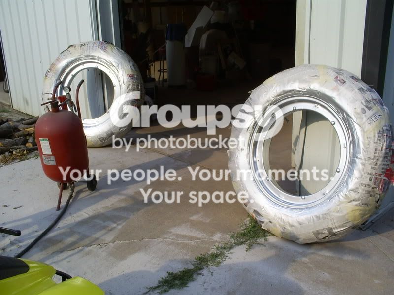

Rims can be fixed
Before
After cutting out and welding in a piece from a donor rim
prep and paint as desired
Move 180 degrees, hit the rim hot and use a 1" square bar stock and BFH and make a new flat spot for the valve stem and drill
ready for sandblasting and painting
Good idea on standard rims, John. I caution others though, that if you want PA rims to work right, the valve stem has to be put back in eaxactly the same location it was originally.
