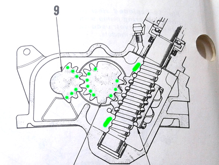

1955 Ford 860 used almost every day for the 30 years I've had it.
Steering was very hard and very sloppy, so I rebuilt the steering box with new bearings, seals, etc and steering shaft/nut assembly.
All went well until installed on the tractor. Upon installing and tightening the Pittman arms, I find I have less than a quarter turn on either sector shaft adjustment screw. I do not understand at all. Without the arms installed and tightened, the screws pull the sector shafts in and out as expected.
What am I missing?
Could steering shaft end play cause the adjuster screws to bind?
Should they have been unscrewed all the way before putting the arms on?
TO-20 is not clear in this respect.
Ideas?

Everything is all lined up per shop manual. The shafts themselves are wobbling even when adjusted so tight the wheel binds - it just about HAS to be their bushings. I guess there's nothing for it but to pull the shafts and replace those bushings. Now to find a way to pump out all that pourable grease the box and tube are full of...
when you diddle them bushings, just clean em up- and find 'the seam' pry that seam open open with a 'soft metal cheapo flathead screw driver if thats possible --drove mine back in with a piece of pvc pipe if i recall
All the play seems to be limited to lateral in the arms, rather than radial.
Does this mean the sector shafts/gears are too worn?
Or did I screw the pooch by not replacing the bushings (which seemed snug enough on assembly)?
The drag links appear to not be tight on the steering sector shaft. I went back and looked they are loose as a goose. Those arms are tapper/interference fit either the sector spline is bad are the arms are.

You are beyond locktite.
When those arms are in good condition you will need a hefty puller to remove them. The amount of threads showing on the ends is also telling me the arms are shaft are worn out.
I am not a fan of this I get good parts and fix the issue.

Those bushings felt tight enough, but I really should have taken the arms off of the tractor and mounted them on the steering box on the bench.
Might have noticed before putting the whole shebang back together and expecting perfection...
