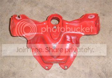

8n/ 2n front axle support
(quoted from post at 15:14:18 04/03/15) Does anyone know if the front axle support from a 2n will fit a 8n?
Yes it will "fit" but you may need to change the axle pin along with it. The early 2N support was a modified version of the cast steel 9N support and used a 4.25" long axle pin. The later 2N's used the same stamped steel support and 4.00" long axle pin used on the 8N.
TOH
[size=24:f4756e0074]Early 2N Style Support
[/size:f4756e0074]
[size=24:f4756e0074]8n Style Support[/size:f4756e0074]
