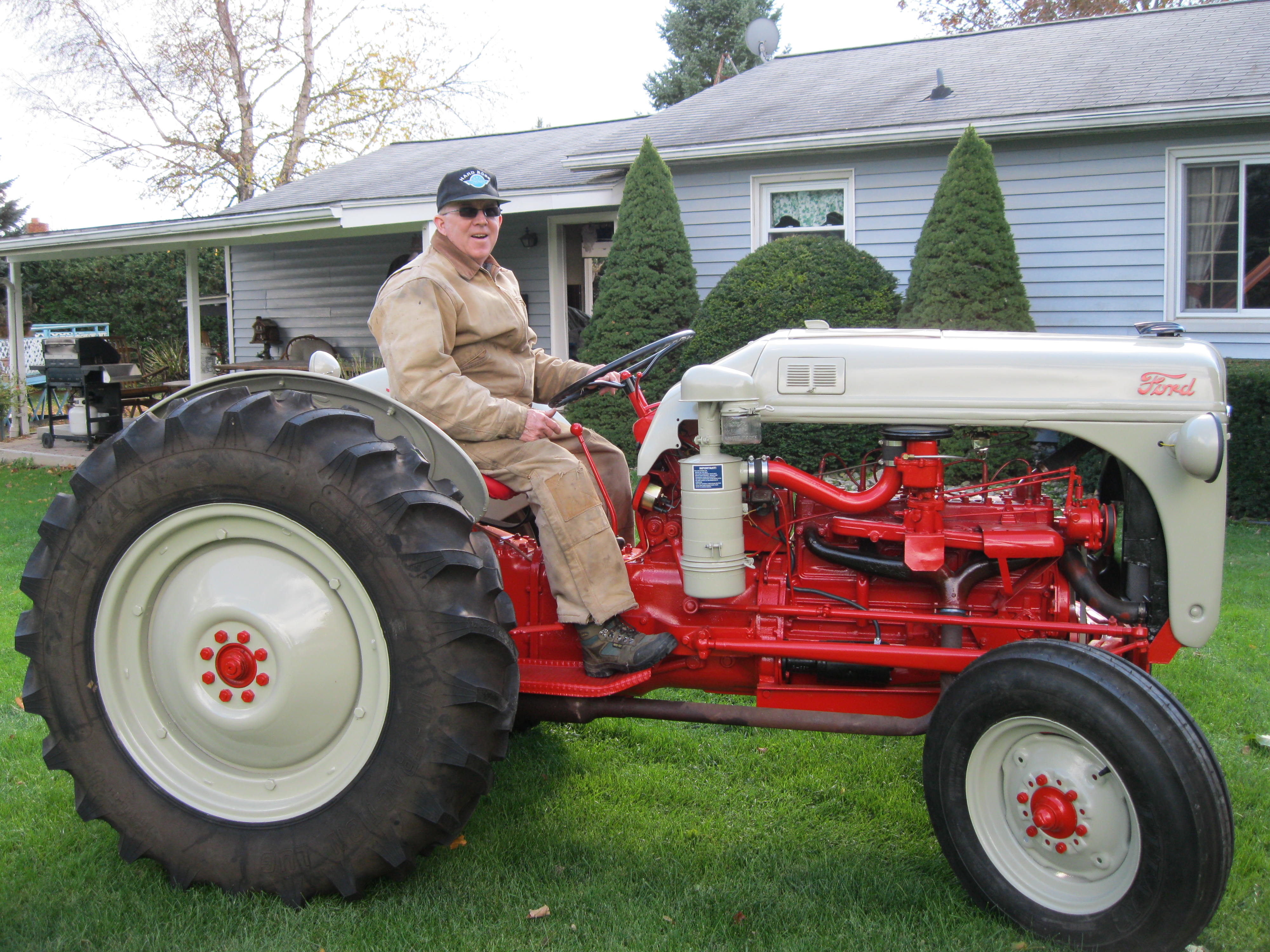

First, as others have said, make sure there isn't a problem that caused it to break. I don't think that starter had anything to do with Funk. It came w/the Ford six it is attached to. Funk only made what was necessary to put that six into an 8n. I would find a starter for whatever engine you have if a starter shop can't replace the cone. My Funk w/95hp industrial six (also my profile pic).
First, as others have said, make sure there isn't a problem that caused it to break. I don't think that starter had anything to do with Funk. It came w/the Ford six it is attached to. Funk only made what was necessary to put that six into an 8n. I would find a starter for whatever engine you have if a starter shop can't replace the cone. My Funk w/95hp industrial six (also my profile pic).View attachment 68072
Thanks for the info. Great looking 8n. Wish mine was that clean.
