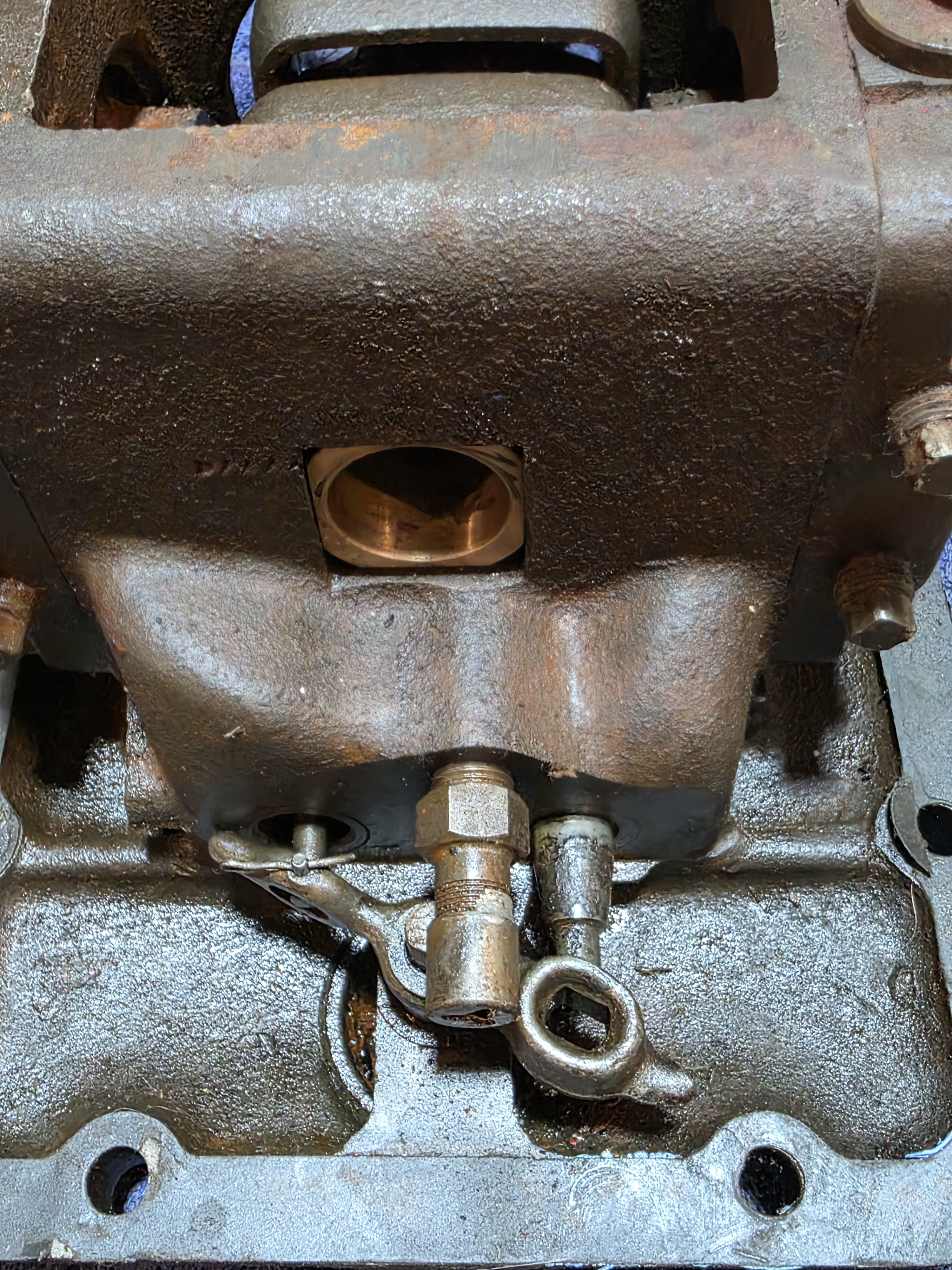

Agree, the exhaust valve must move forward in its bushing far enough so the tapered end is open to the two ports in the bushing.

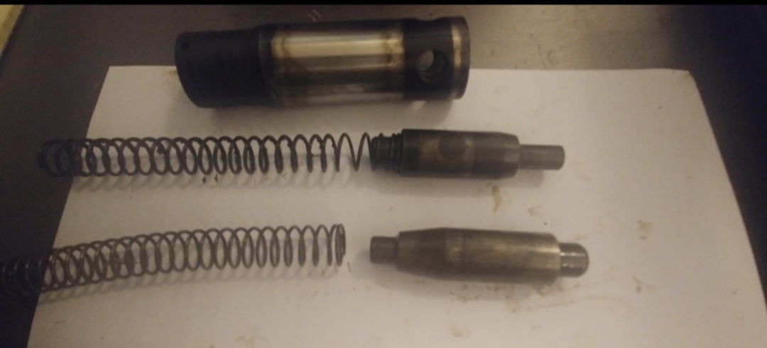

This is the exhaust valve, taken apart.
The spring is inside the spool, pushing the rod to the rear of the spool. It helps the arcing lever smoothly push the valve forward.
( or pulled rearward)
It doesn't push or pull on the control arm.
If the spring broke, the valve wont move forward enough to drain the fluid.
There were two versions of the intake valve, newer one has the longer taper.
Its spring DOES push rearwards against the lever--- but not much force.
Exhaust valve is pinned onto the lever.
Intake valve spring is pushing the lever to the rear.

I found the spring for the intake valve but can’t find one for the exhaust. I looked and noticed other people had the same problem finding one. I’m sure there’s one somewhere if just knew what to get.
The spring is 9n 632.

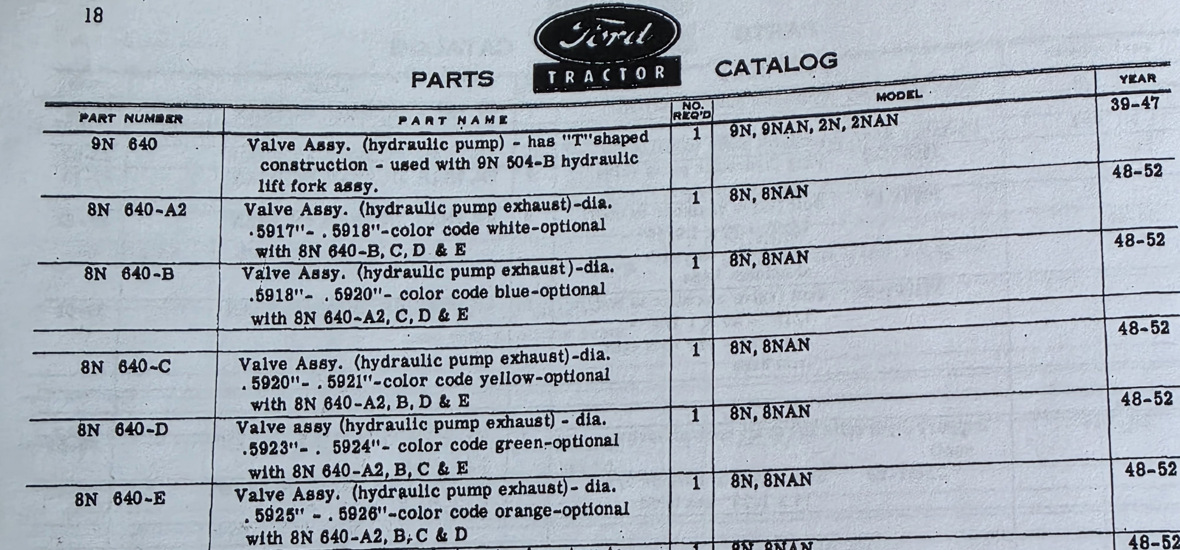

8n Exhaust valve assy came in 5 different sizes 8n 640-A2,,, 8n 640-B,,, 8n 640-C,,,
8n 640-D,,, and 8n 640 -E.
None have been available new, for a long time.

The control rod needs to move the lever rearward to push the ex valve forward, to lower the 3 point. With the pto not turning, can you move the lever by hand, to see if the arms will drop?( need towel to dry hand:))

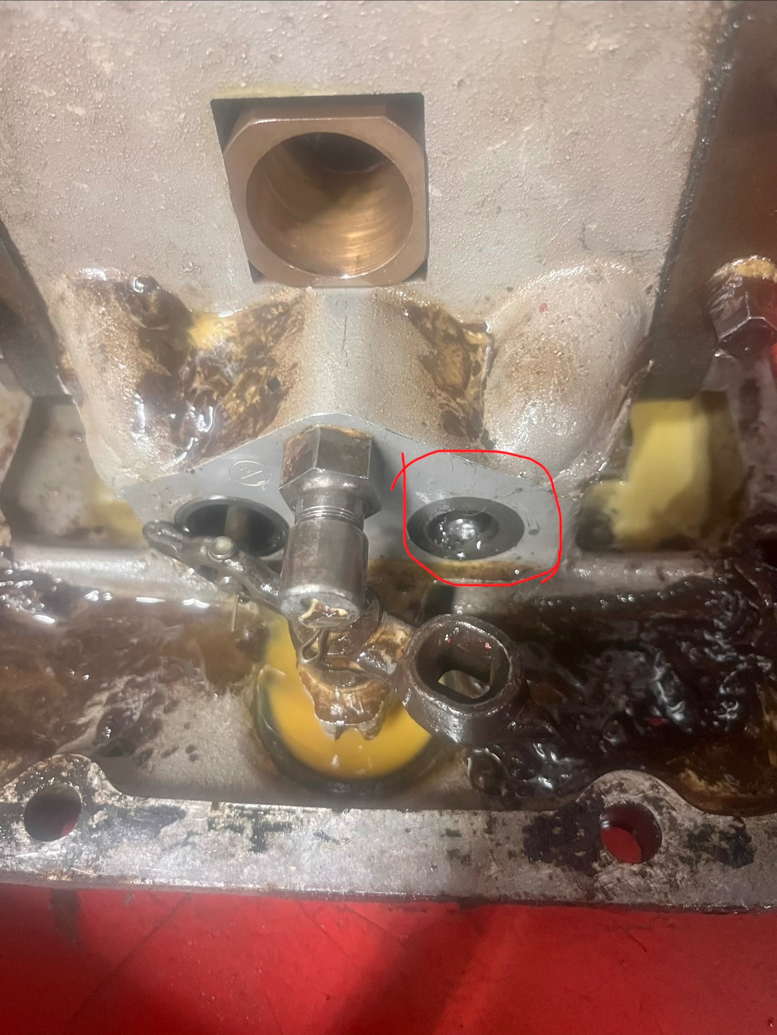

I’ve got the pump out now. The exhaust side moves fine the intake has the valve pushed in stuck. I haven’t tried taking the rest apart yet. When I turn the pto off or stop it the lift goes down but soon as I turn it on it raises straight up with no control or problems just can’t stop it or make it go down while the pump is pumping.
OK, so the intake is stuck in.

Did your control arm move the lever in the full down command so the exhaust valve was pushed all the way in, when pushing by hand? (like in the last Pic in post #7?)
Is your control arm straight or does it have a curving bend?
It’s just like that one except my valve is stuck in the housing.
