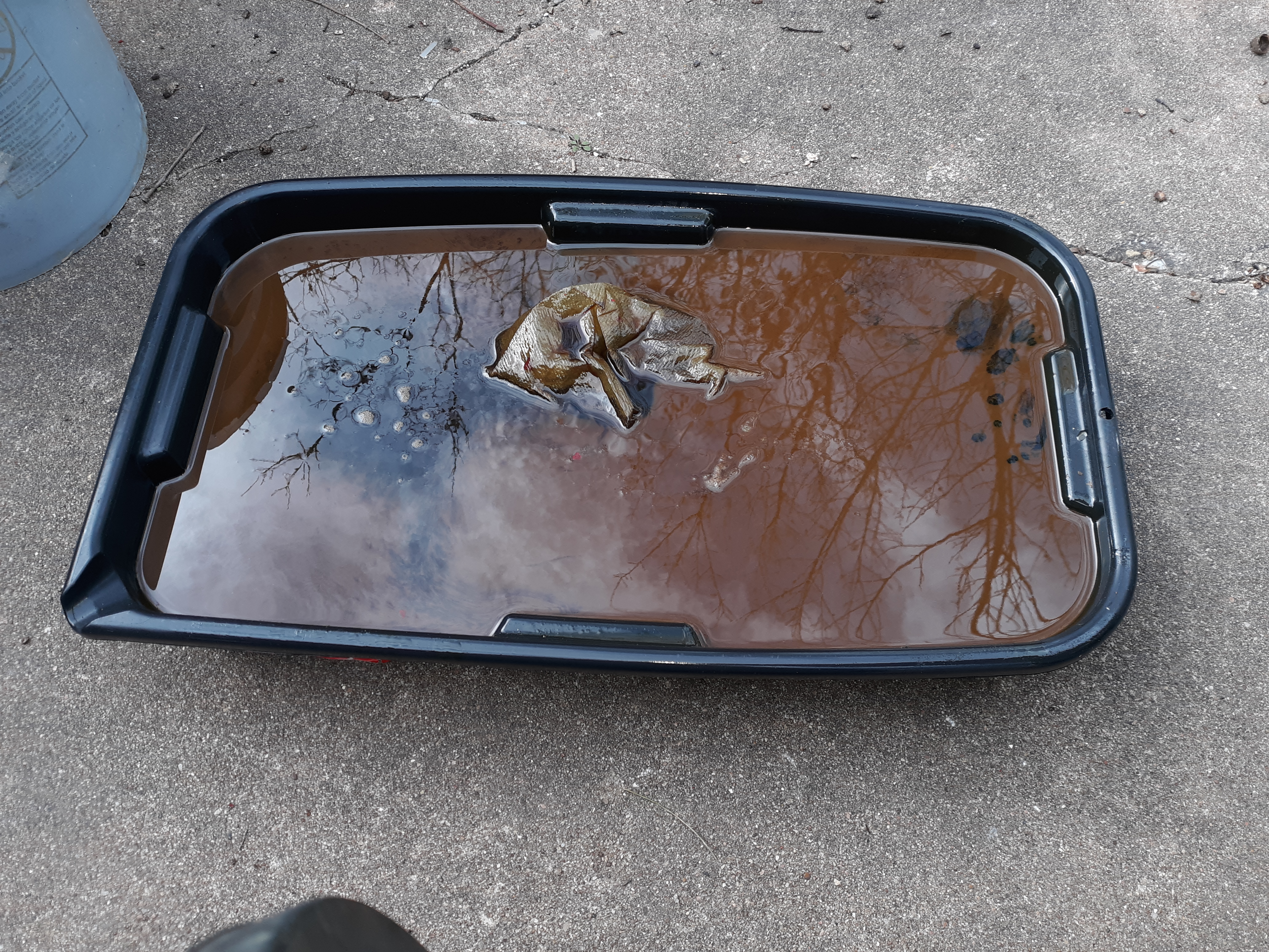

I know I know I know….. this has been covered. I read some of your posts and tried some of your tricks but no luck. I just got my 8N to start yesterday and today when I was getting ready to do an oil change I checked the oil gauge and NOTHING….. I unscrewed the oil line at the gauge and at the engine where it runs from the gauge. I cranked it for a second but couldn’t get oil to come out. I unscrewed the oil filter cap and the filter was empty. I poured some oil down the tube and filled the filter can halfway, I also took the “large” bolt and spring out of the front of the block and poured some oil down in there. Some oil came out of the connector where the oil gauge screws in at the back of the block. I screwed everything together and cranked it up for a second but no oil pressure. Any ideas on a quicker and easier solutions???
I went ahead and drained my oil and it looked like caramel chocolate milk. I have no idea what the history of the tractor is. Any thoughts?

Hi BigstarATX, first thing I would do, is put fingers up in the oil pan drain hole, and see if the oil pick up tube is still soldered tight in the oil pump cover plate. If not, it can suck air, so the pump wont prime.

Yes, see if the end of the tube has movement. It may flex 1/8 inch, or so if still soldered good. It should not move and stay. I just had one that when wiggled, it was obvious the solder joint was loose at the pump cover plate.

The screen is supposed to be soldered to the drain plug, I'm not sure why the solder joint cracks sometimes and lets the parts separate.
Once loose, the screen can't go anywhere except into a P.O.'s oil drain pan, the oil pickup tube assembly blocks it from going in harm's way, in the rest of the crankcase where it would likely get slapped around by the connecting rods.

Oil Pump Prime ,Putting oil in the oil pressure gauge line is the easiest
place to prime the pump.Take the line loose from the gauge then take a 1/2 pint pump oil squirt can, or even a pump up garden sprayer hook up length of vacuum hose to the oil can/sprayer and to the oil line.Pump 2 full cans of motor oil in the line install the line and tighten it up,then start the engine immediately.The oil will fill the oil galley run down to the mains and rod bearings,camshaft and fill/prime the oil pump.Much easier than at the bypass valve.

I wouldn't.
With sitting and now you are mucking around with it who knows how much dirt and debris will getting kicked up. Or, perhaps hardly any at all.
They do not have a "full flow" oil filter, so any small stuff will go right through the bearings, and anything a little bigger will first gouge the oil pump (or maybe even break it) BEFORE it gets to the bearings.
The screen isn't perfect, but it's all the protection your engine has!
