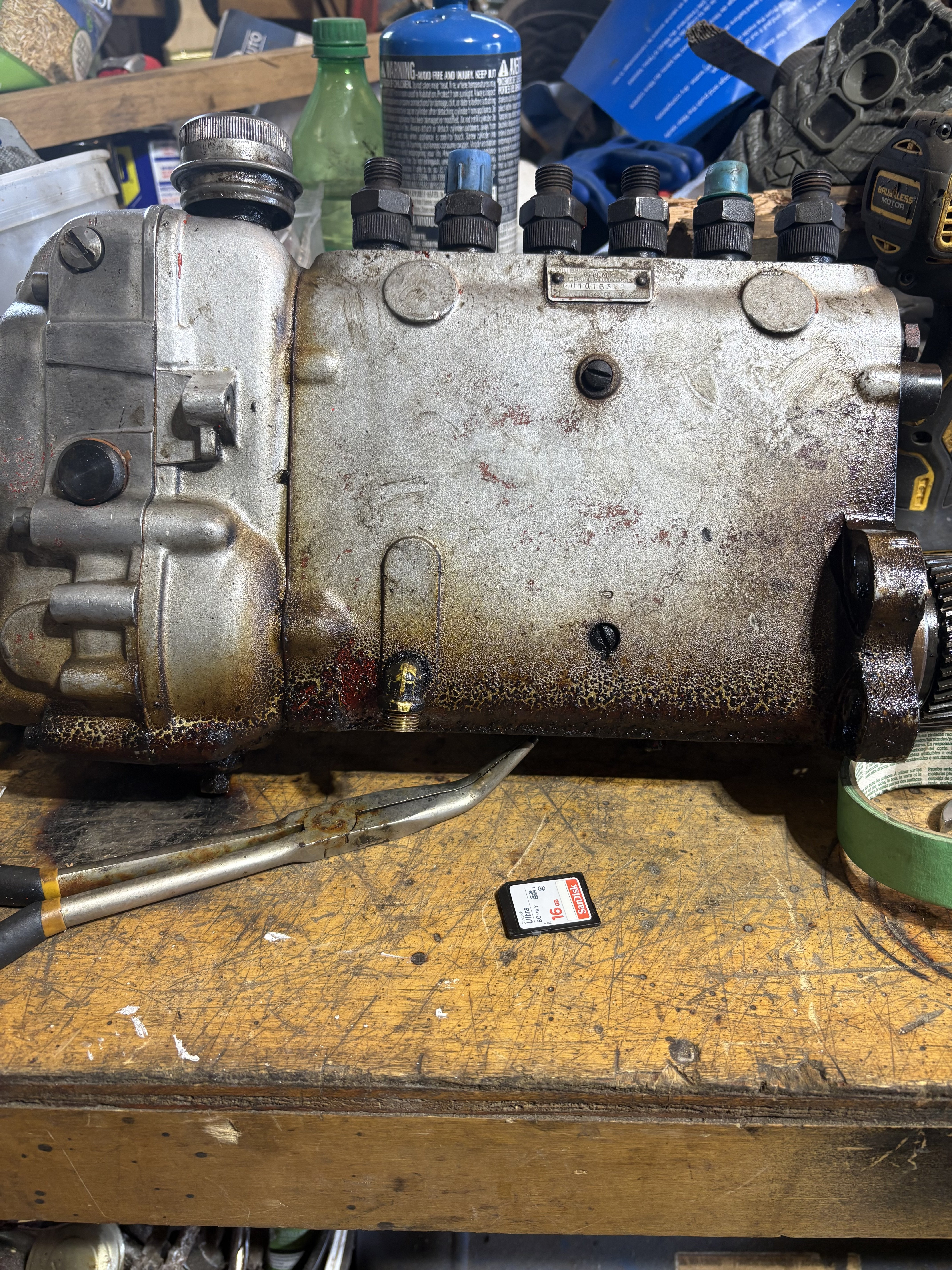

I had the injector pump on my 900 Case rebuilt, or so they claimed at the place that did the work and after installing it I found out that the transfer pump isn’t working. They said they can’t get parts for it. Is the transfer pump external , if so is it the piece attached to the pump and the lines from the filters are attached

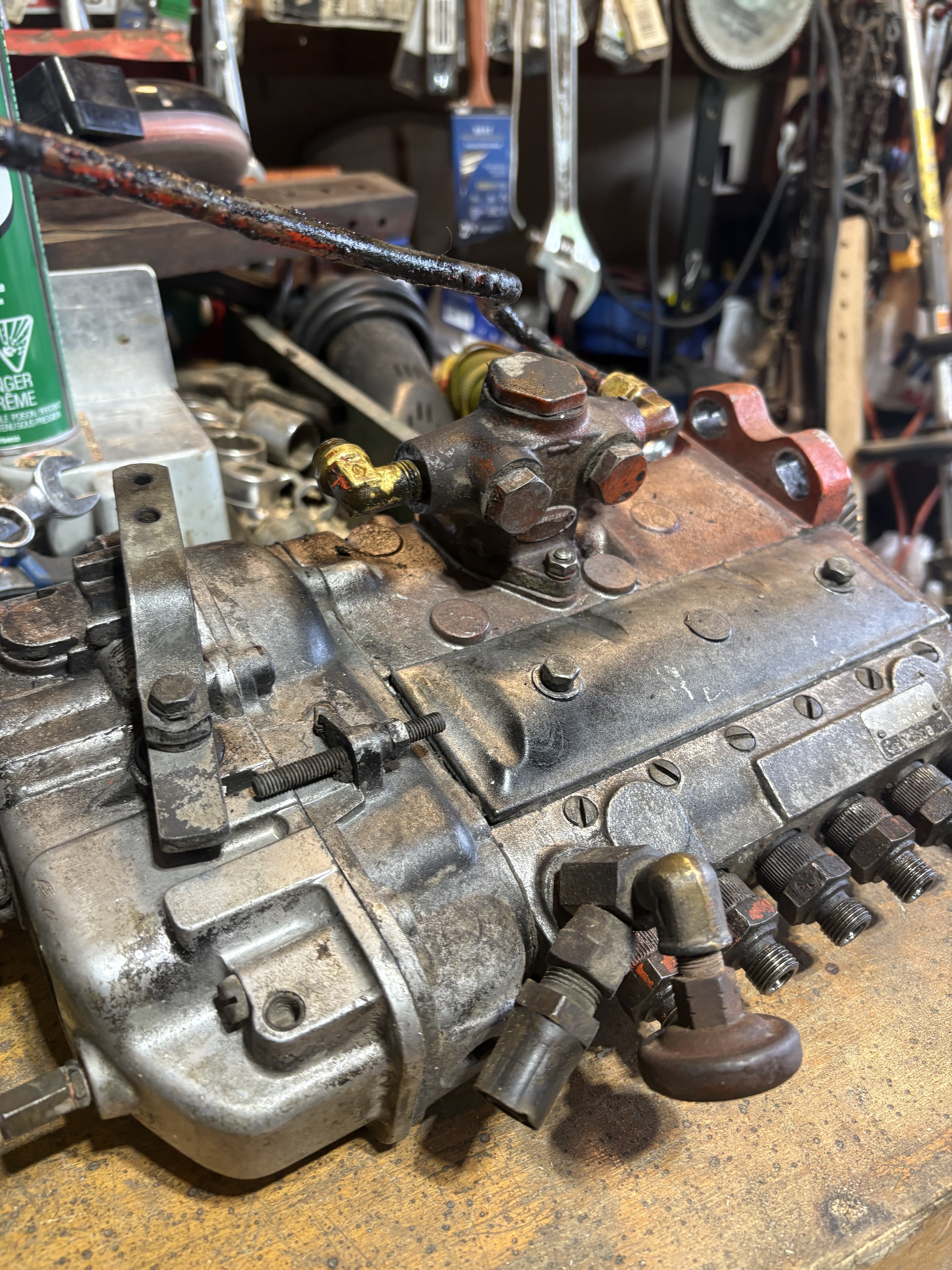

This is the original pump.i also have another pump that i got. The second photo is the other pump. Just wondering if the piece showing on the pump in the second photo is a transfer pump.
You can add an electric fuel pump to push fuel to the injection pump. Do you have the original pump or a inline Bosch pump?
