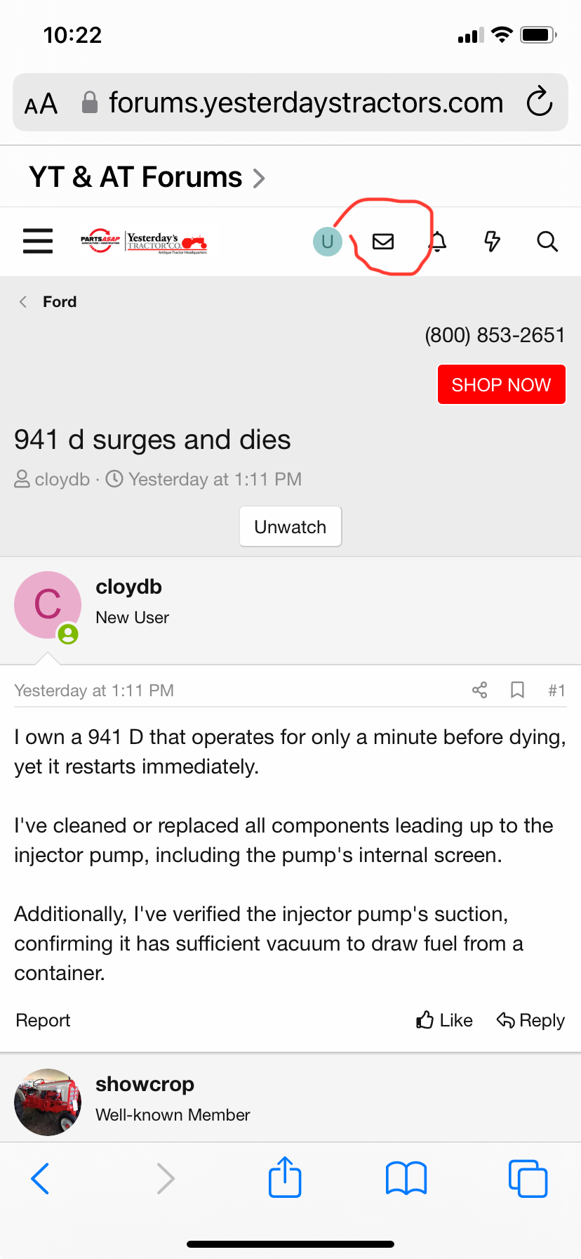

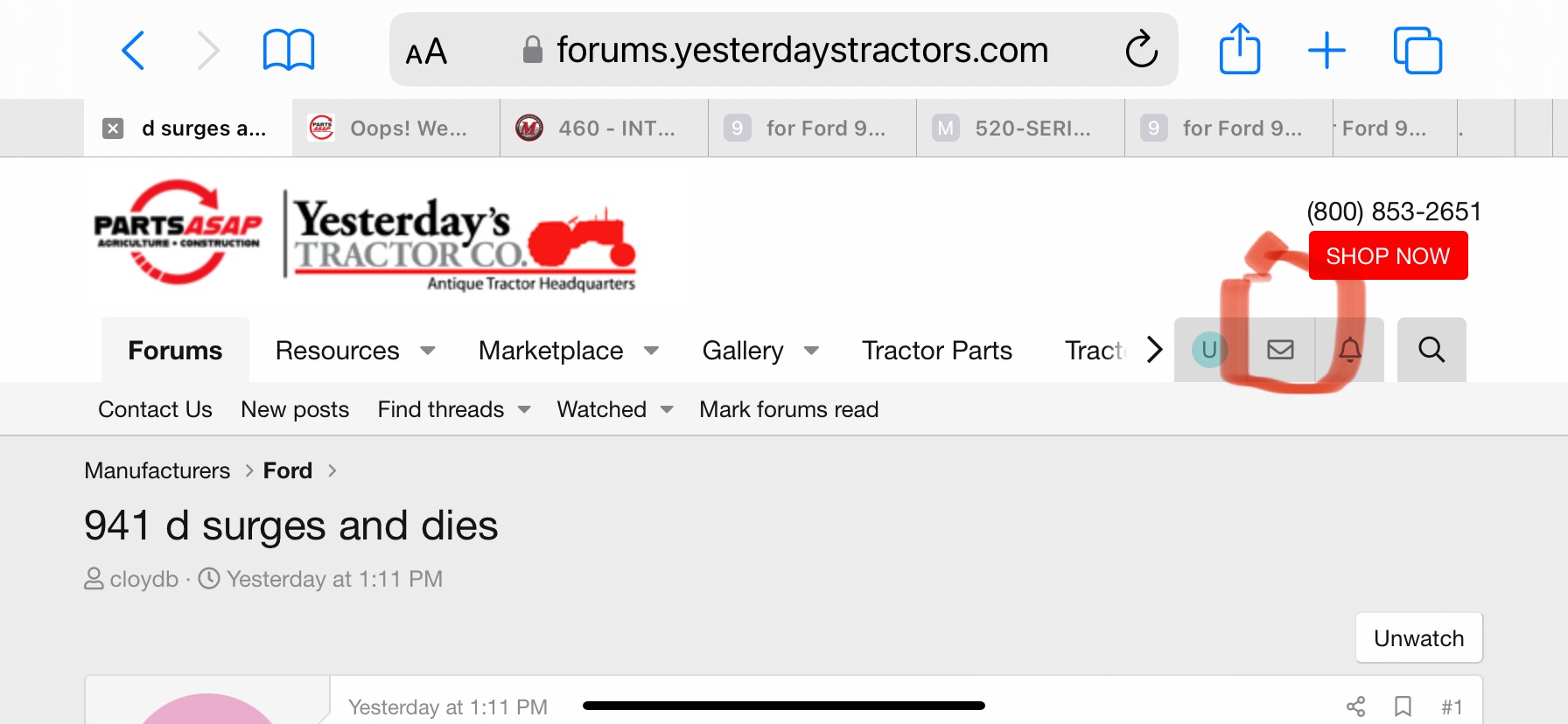

Cloy, maybe this will help you. These are screen shots from my phone. I have circled the “Letter or Envelope” icon to show you where you view your “Private Messages” It not a scam button, it is legit. It is like email between forum members. Does this help? Were you afraid of poking something and messing something up? First one is holding my phone sideways, it makes the layout look more like a computer, but the circled icon or button is hard to make out. In the 2nd one it is easier to see.
