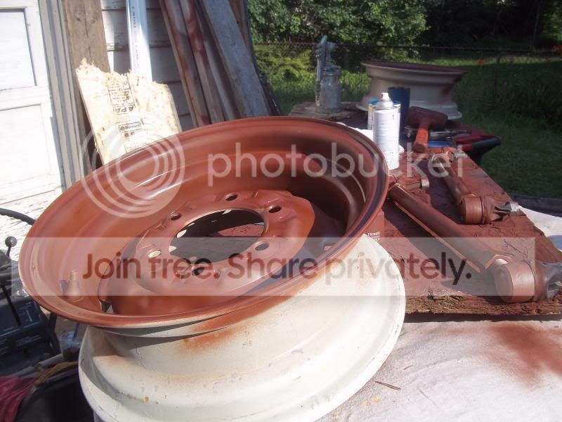

I just got new front shoes for my 9N
I went to my local Mechanic to get them broke down, he would not mount the new front tires and tubes until I removed all of the light rust and painted the insides of the rims
I am not saying he's wrong that is just ole SKOOL
He has many old ford tractors at his shop
So I trust his judgement.
A wire brush and angle grinder made short work of it and I put 3 coats of primer on it .
It may be over kill but it's not wrong either
I will probably just remount them myself with trie spoons
Question should I put baby powder on The tubes before reinstalling and at what point do you install the tubes after you get the tire half way on.
I don't powder mine but it's not wrong to do it either. Get one bead on then insert the tube, align the valve stem and tug it through. Spoon the other bead in place (don't pinch the tube) and fill-er-up
I do all my own tire work - fronts and rears.
Drive along the edge of the rim with the pickup to break the bead. Fronts are child's play.
Yes you put one side of the tire on the rim then insert the tube.
If your primer is completely dry I doubt you'd need any talcum power. I never use it. If not a few days dry I guess it would help prevent the tube from sticking to the paint. Wont hurt anything in either case.
I always use dish soap to help the tire slip over the rim.

I tie and tape a strong string to the valve stem before putting it through the hole in the rim. I tie the other end of the string to a lug hole so the valve will not pull back into rim when I am getting the second tire bead over the rim. It is frustrating to get the tire on only to find the valve has pulled back into the rim and you need to break it down and start over again.

The local tractor tire dealer taught me to put the tube in the
tire and air it up part way prior to putting it on the rim.
It gets all the folds and wrinkles out and keeps them out when
installing, plus lets you position the valve stem at the correct
angle for the hole in the rim.
Probably more importantly it helps keep me from pinching the tube
with the tire iron. The tube can move itself out of the way more easily.
Like trying to pop a balloon with your finger.
Prior to him showing me that, I did them just as others described.
One bead on, then the tube with something to guide the valve
stem. Blow it up and let the air out several times to get wrinkles
and folds out, etc.

I sprinkle baby powder inside the tire to "slick up" the tire/tube and after I get the valve stem through the hole in the rim I screw on a 4 way valve stem tool to keep it from pulling back through.

i air mine a bit too. helps prevent pinching. i use tire soap for mounting. ruglyde is the napa one i'm currently using.

I will paint a top coat tonight over the primer and I am sure tomorrow will be another sit in the park day so I will wake up Mike from his all day nap and get them mounted.
NOX John reminded me I have a new tool I picked up that screws onto your valve stem thread through the hole in the rim and has T handle to pull it in also has a valve stem tool on the T I even remember where I put it LOL
