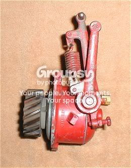

I just rebuilt the Governor on my 9N got the shims right at .220 having problem with the RPM's
low idle is at 800 high end wide open is around 3300+ RPM how do I adujust it down to 2200 RPM

While the BEHIND the carb idle speed might slow things down; (try it) I think yer problem is STILL the governor. ......Dell
Is there not an adjustment bolt at the back of gov?The manual says there is,and I have used it to set max rpms[lowered them,sounded too high].Try that,and check the manual.---lha

ee the bolt with jam nut on bottom of gov arm (the one attached to throttle rod)? Adjusting that bolt length changes limit as it will hit stop on side of housing earlier or later in rotation of arm/throttle movement. Screw IN to slow engine.
Yeah, I know...you have 9N & gov pic is 8N...for this adjustment, it makes no difference. Just a handy pic.

JMOR once again your picture solves the mystery
the bolt in my Governor is allot shorter I had it bottomed out all the way in with no results.
I will pull out that one and replace it.
