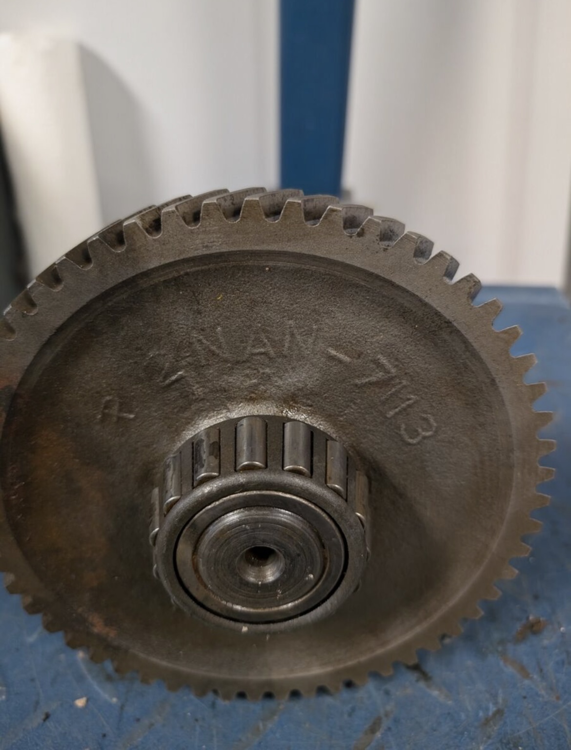

Up for discussion the 9N Low Ratio trans. Some will be stamped LR

What do you know about it Kirk? I never knew there was such a thing. Are all three gears low ratio or just 1st and 2nd?
It’s my understanding that the main gear on the counter shaft was changed out. Factory ordered would have the low ratio or LR stamp on the trans flange. This would effect all gears

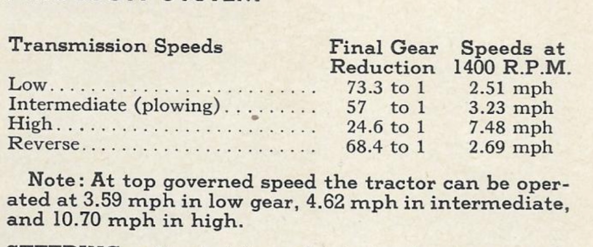

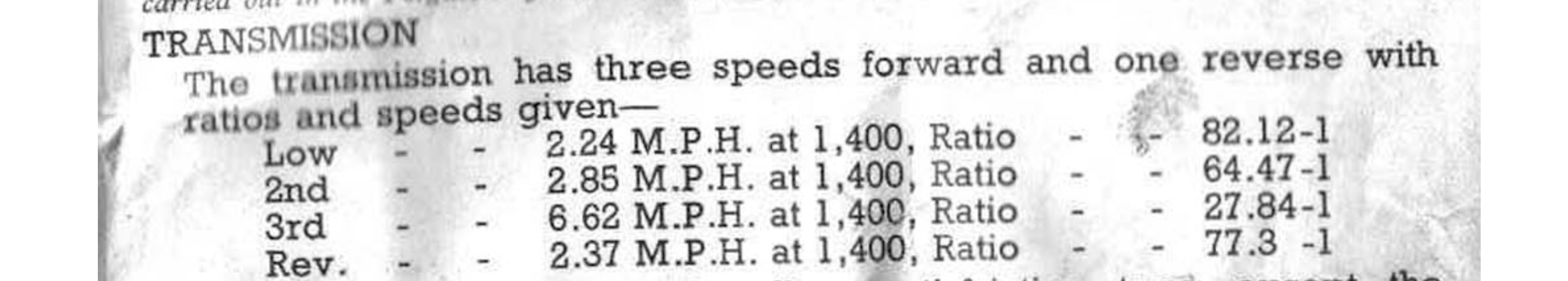

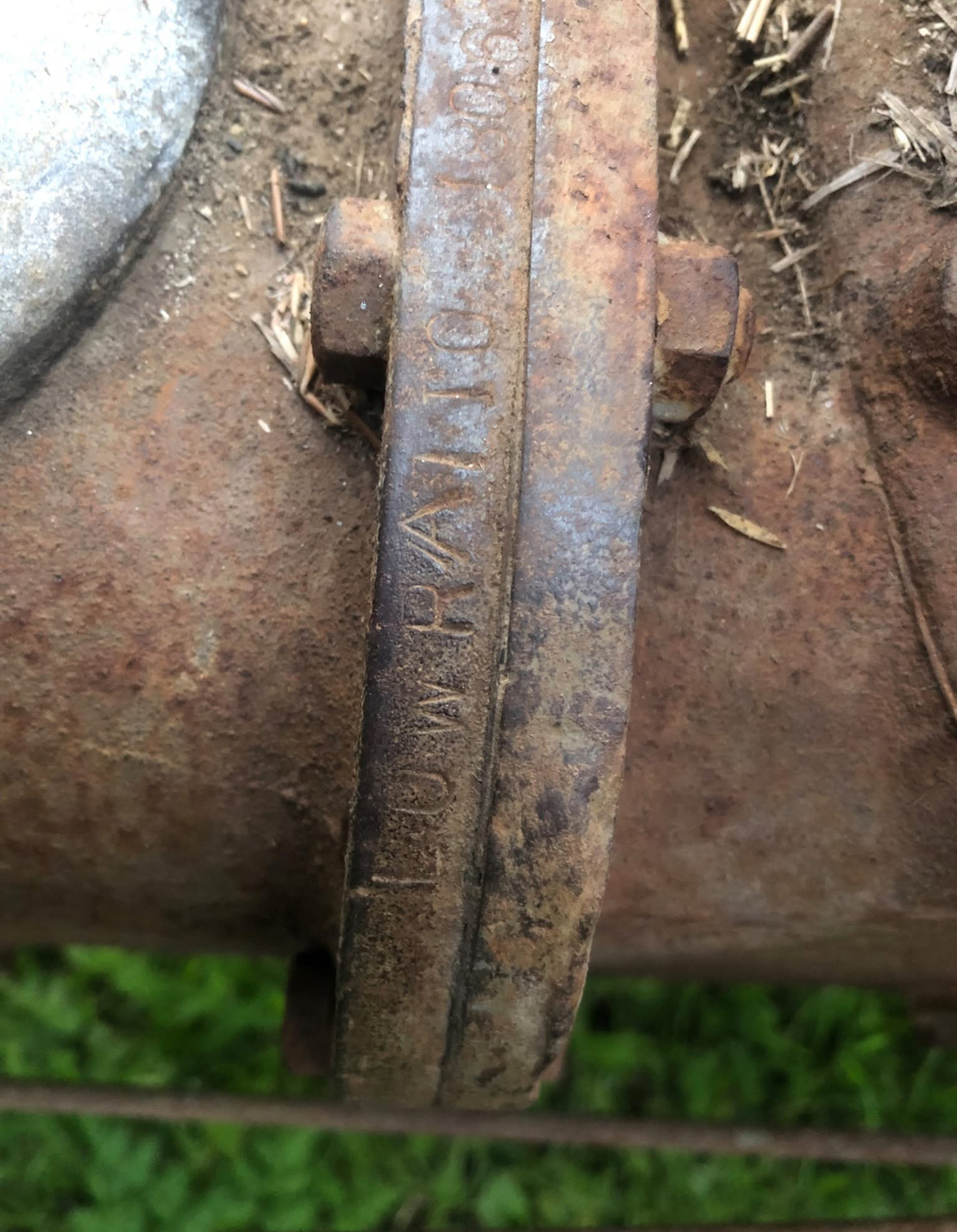

Difference in the low ratio and standard trans
