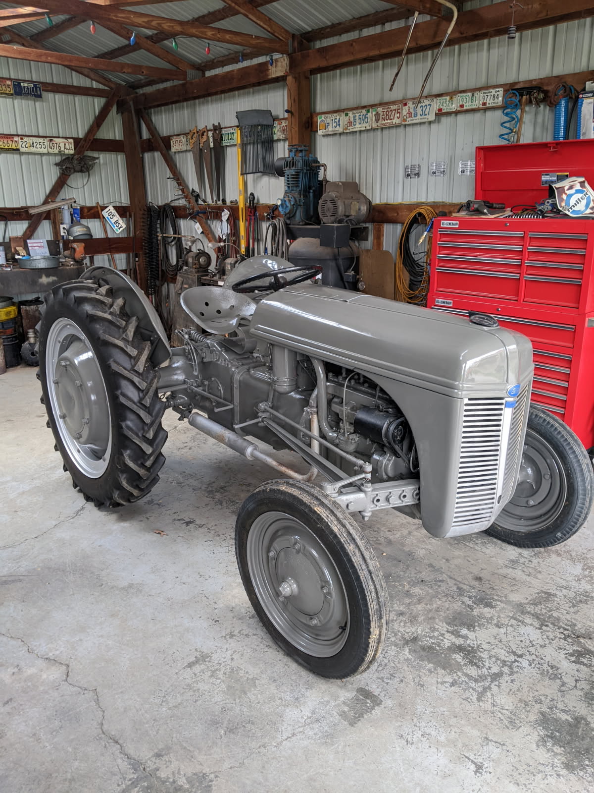

Got a 1940 9n. Repainting the tractor. Has anyone used the Majic Massey Fergusen gray on their tractor? Is it close to the original color?
I was looking back at some old posts, and since no one replied----thought I'd answer your questions. I've used it before and looked and did real well------make sure you add the catalyst to it. Here a picture of our 41' after we did it.

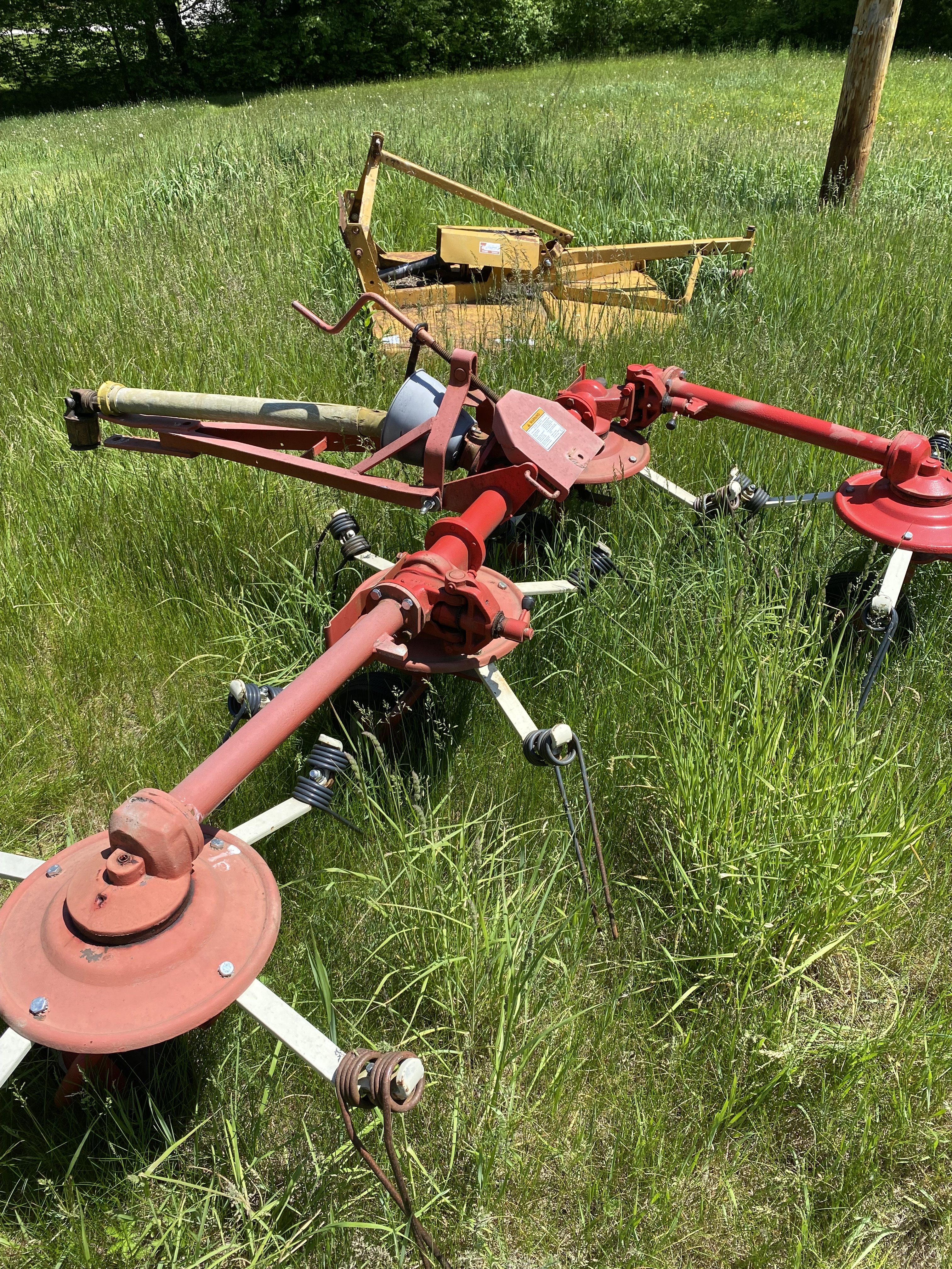

Here is my tedder that I rebuilt a few years ago. I did the bright red parts one year and painted with some leftover 2K urethane from a Ford project. The rest of it I did a year later with Majic because it is "only a tedder." I am sure glad that it wasn't a tractor! The 2K urethane costs 2X what Majic costs but is only 1/4 what the paint most auto-body places use costs.
