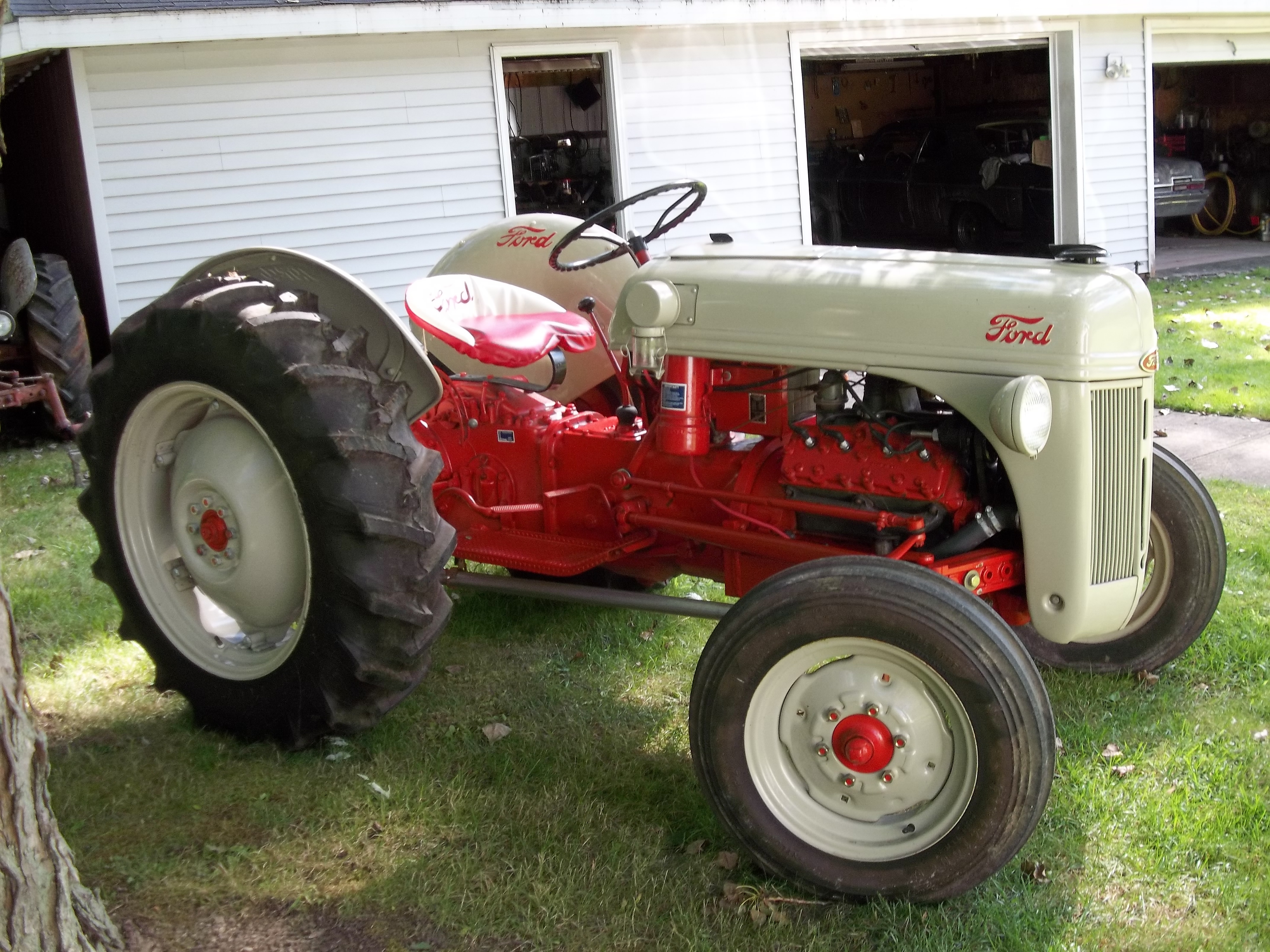

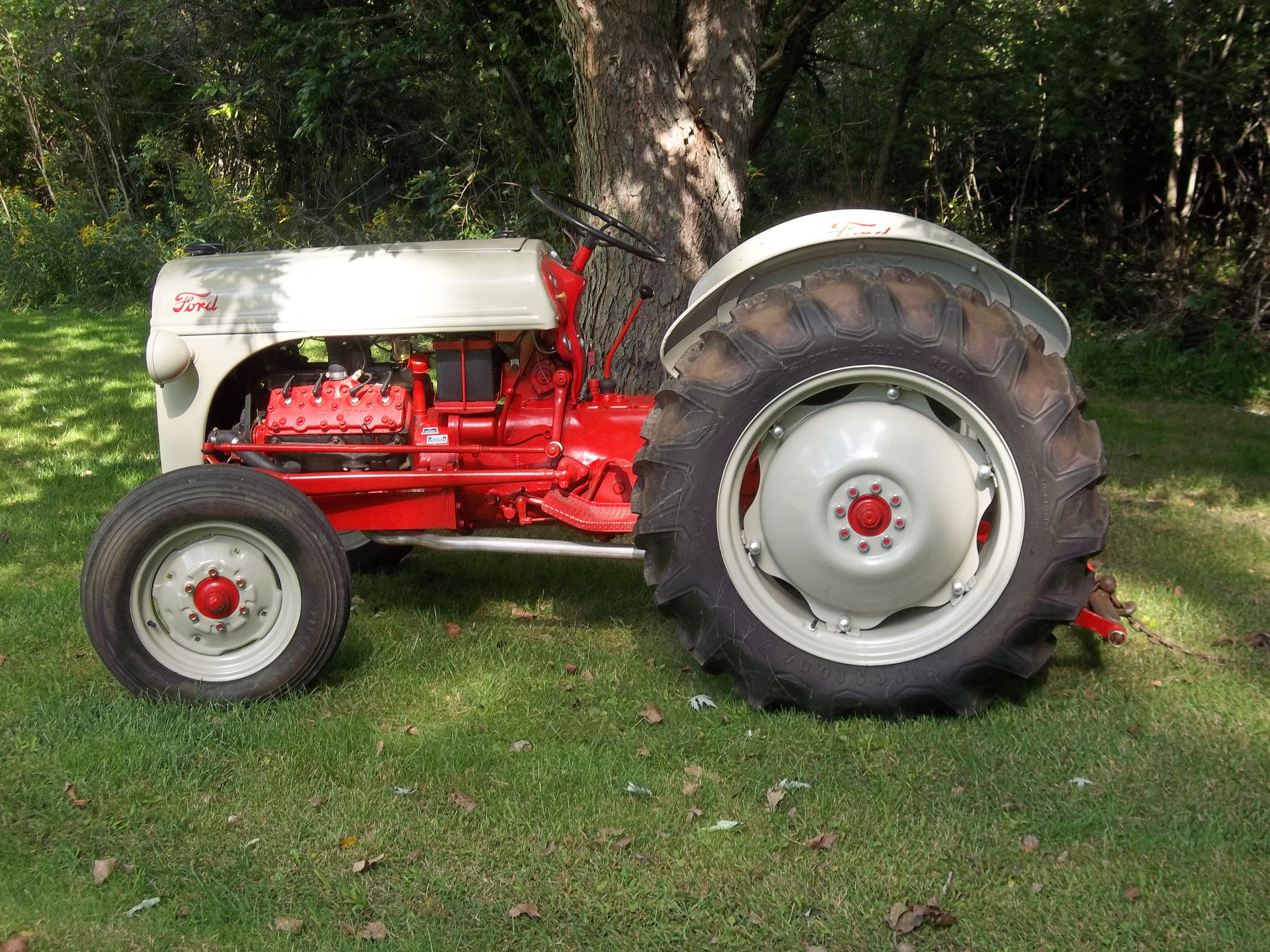

Built my 8n with flathead about 25-30 years ago. It's a 1951 with the Sherman tranny, installed a 1937 flathead 60HP with the aluminum water jackets in it. No need to lengthen or widen the hood, looks pretty stock.
