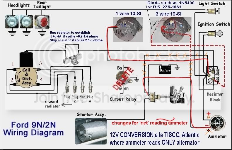

1941 9N 12 volt conversion.
I just purchased from this site a new wiring harness. The polite salesperson on the phone said this harness does not come with directions, so... what exactly have I just purchsed and where does it all go? :)
My tractor was converted by who know's when and been re-spliced on no one know's how many times or why...
Also purchased a new starter switch to eliminate some of my grimlins. :)
Any comments and sugestions will be appreciated.

his is probably what they sold you. I do not like the way they specified the ammeter wiring as it registers only alternator output vs. registering the net input/output to/from the battery, but have been told that wire lengths do not permit my preference. Mark-up shows net-reading ammeter. The harness will not included lighting & you can see the wires needed for 3-wire alternator or not needed for one-wire alternator.Hope this useful to you.
