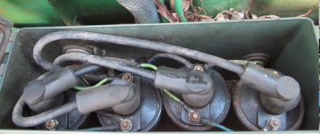

My goal was to spend the minimum possible to get it running and determine the cost to get it in good shape. There was no spark so I checked the coils and determined both of them were bad. I then wired up four 12 volt coils separately from the tractor electrical system and powered the system with 12 volts. I used 6 volts for the starter. I got the plugs firing, dumped some gas in the carb and got it to pop. I removed the carb and determined it was a mess. I drilled out the lead plugs and cleaned out all the passageways which were plugged with corroded aluminum. I also got a main jet from a Cat pony from a salvage yard. I got it to sort of run but the Bakelite points did not like the 12 volts and one of them fell apart. I adapted a set of Ford points for the failed set and hooked up a Ford condenser in addition to one of original condensers. I got the pony running up to governor speed but saw the other points were smoking. I hooked the ignition up to the 6-volt battery and the pony ran fine. I then attempted to engage the pony with the diesel decompressed but all it did was grind. I found the clutch was stuck. On a whim I engaged the pony gear into the flywheel gear and with the diesel decompressed, started the pony which also rolled over the diesel. The pony came up to speed, I pulled the level fully in for the pony clutch and compressed the diesel and it started. I did this a couple of times and then the other set of points fell apart. I decided it was time to get new points, condensers and coils. After I installed these the pony would fire up fine. I then pulled the pony clutch in partly and compressed the diesel in an attempt to break the clutch lose. No luck at this. I also determined water was getting in the pony oil when it ran. I decided to remove the pony from the tractor.

As I stated, I used four 12 volt coils, one was from a Chevy, one from a Ford, one from a Mercury marine engine and one of unknown origin. They worked just fine on 6 volts. I have read info about coil resistance and voltage but from what I found in this instance mixing worked just fine. Attached is a photo of the ignition setup.
This is how I did my coils to run on 4 automotive coils. I mounted them in an old amo box on the side of the frame and enclosed the wires in plastic split conduit. Been that way for 12 years now.
