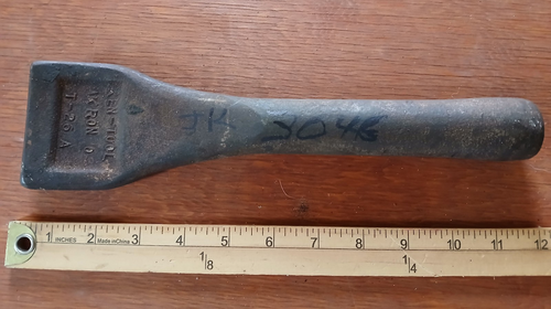

What do you have for a bead breaker? I have a Maddox manual screw type. I prefer a Ken-Tool bead breaking Tool Driving Iron (with a short handled 6-8 lb. hammer) for many applications. I find it easier to use in many places than a heavier slide hammer type. I use it to start a place to put my bead breaker, if I can't get it locked on without starting the bead down.

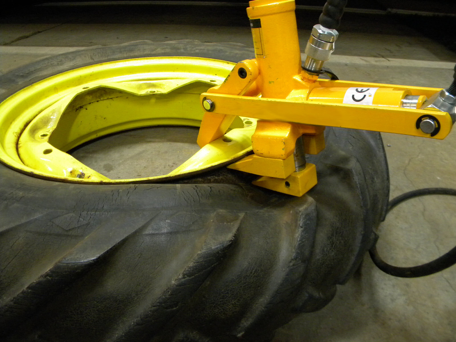

I have a hyd bead breaker I use on air over hyd pump. I think the name was yellow jacket got from an auto part dealer. No beating anymore it will clamp it self.
I did the same. I am contemplating getting one of the newer battery powered hydraulic pumps since I also have Port-A-Power cylinders and pullers, so that makes it a bit more justifiable.
The Enerpac, Milwaukee, and Greenlee versions are at or above $6K, but the Rain Forest types are closer to $600.
