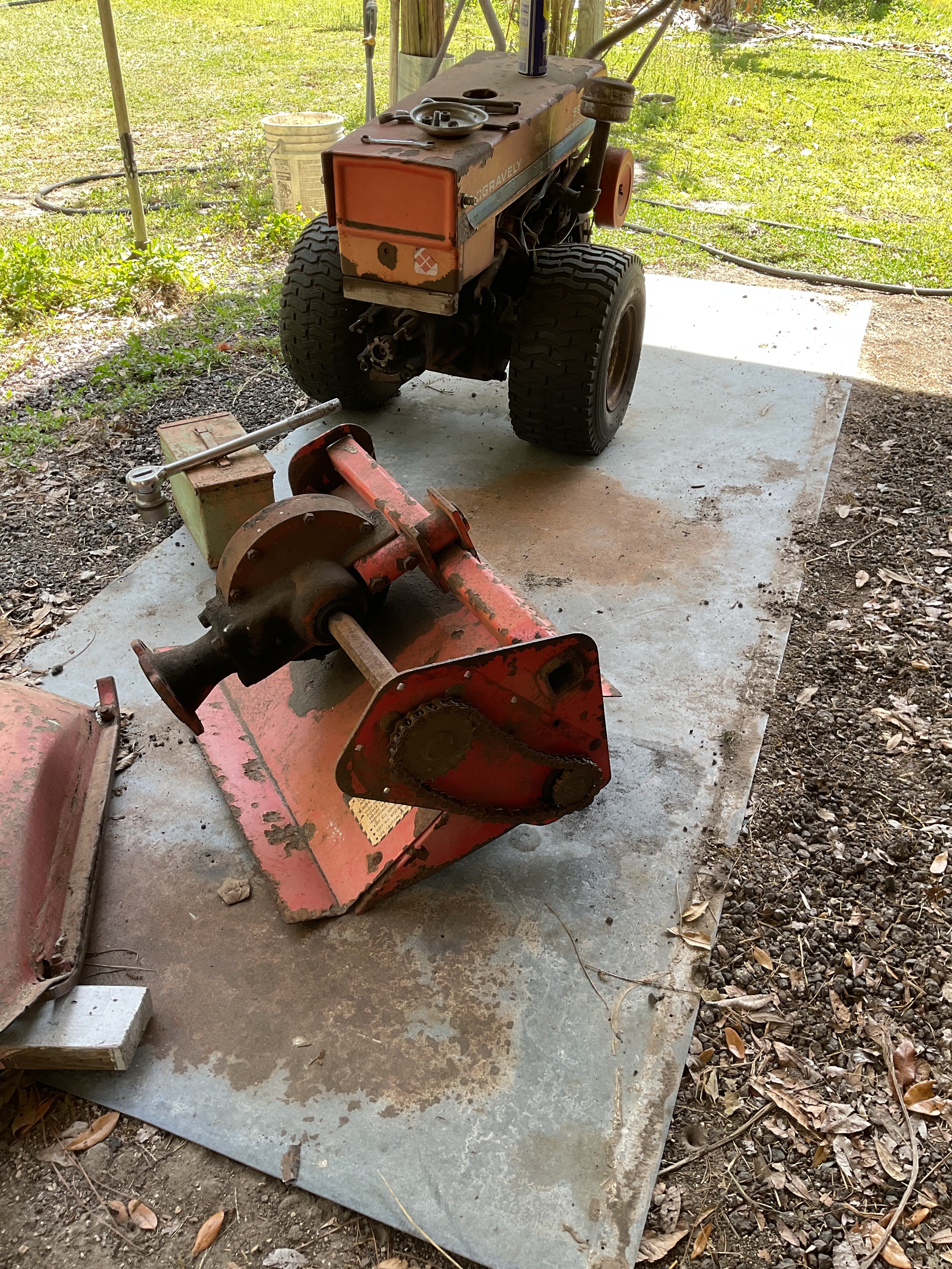

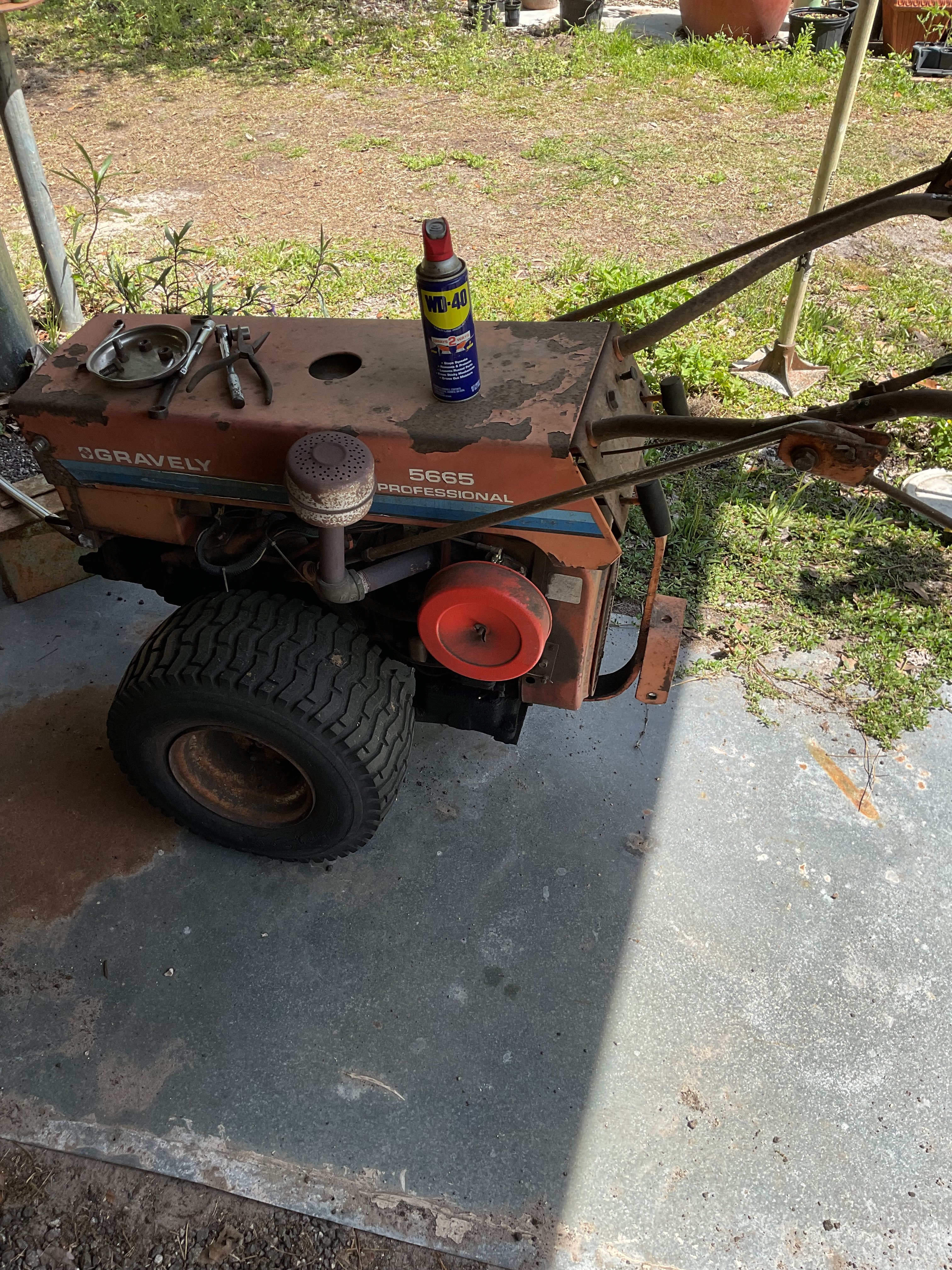

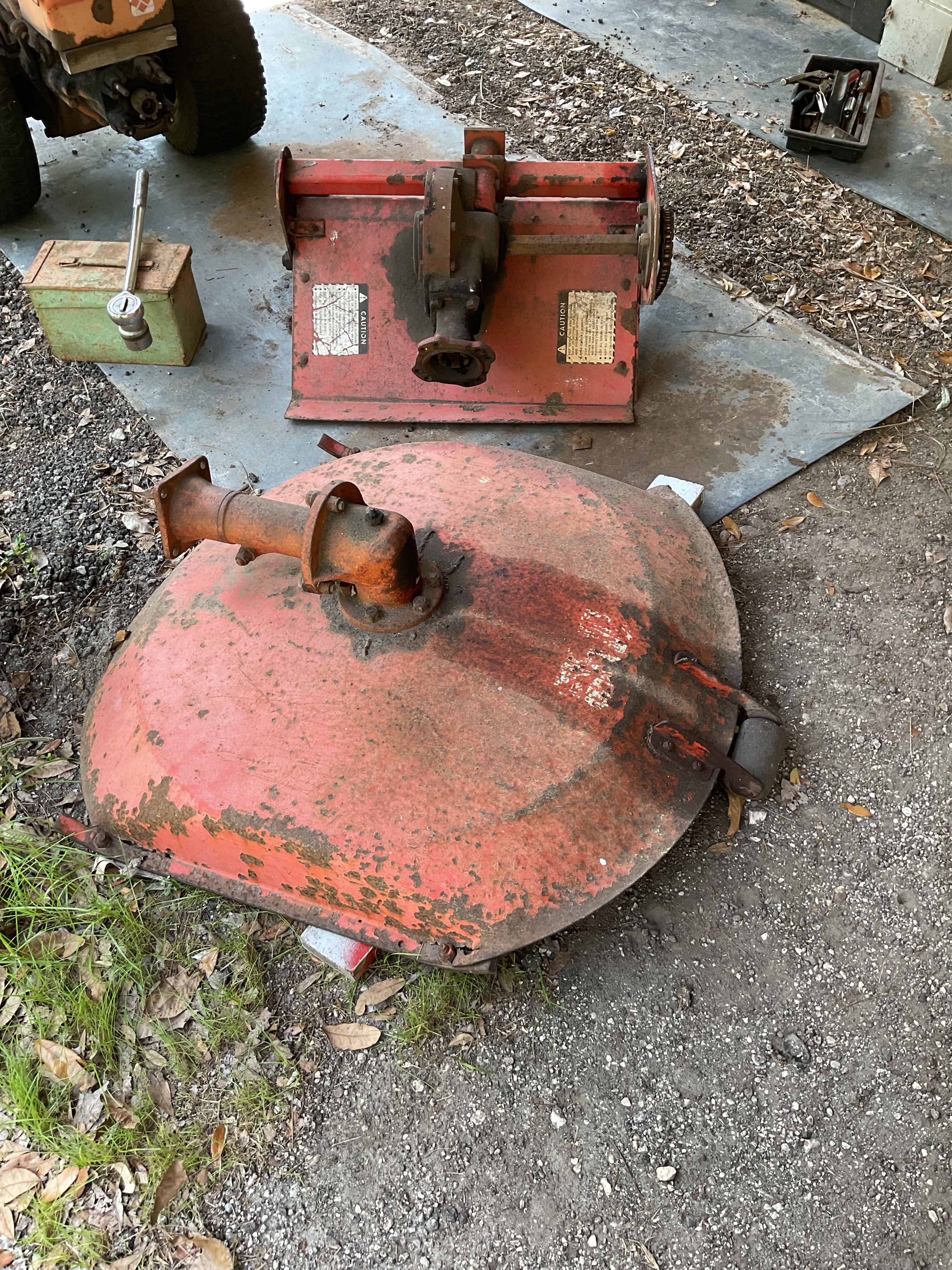

Hello all,not sure if I’m in the right forum or not but I’ll give it a try . I have a gravely 5665 professional walk behind Kohler engine gravely. runs great no problem there. I mostly use it for the the Rototiller and the bearings that support the tines are shot and I have no idea what model the pictured Rototiller is and I’m wondering if anybody can help me with that and also the pictured mower deck. it needs another roller in the front to keep it from digging in when going backwards. any help is appreciated thanks. Danc

I've never used a "tiller" like yours, so am just searching the internet. I believe that Gravely called them cultivators (rather then tillers) because the short tines were better suited to cultivating weeds rather than breaking ground. You can find some manuals suck as:
https://chipmanuals.gtcoa.com/pdf/Rotary_Cult_NewStyle_Op_Man_1178.pdf It shows the bearings as Gravely part 22193 which is an obsolete part number. Doing a search on Gravely 26" rotary cultivator brings you to a more recent parts diagram.

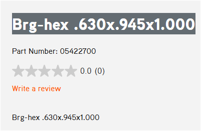

The bearing number was superseded by 05422700 and the bearing housing part 22192 was superseded by 085520000. The bearing is no longer available, but the bearing housing can still be purchased for about $143 each.
A search of the new bearing number shows a few ads with the "dimensions" of the bearing.
The best I can suggest is to take your old bearings and bearing housing to a good bearing house and see if they can match them. You might also call an old time Gravely dealer such as Richards Lawn and Garden Equipment in Spencer WV. They used to be great on older Gravely equipment (but it's been over 20 years since I called them.)

The chain drive gear (Top one) is very worn. Running it will cause rapid wear on the new chain (it needs)
I tried another search engine and found part number 05422700 listed. (I have no idea whether the company actually has any in stock.
At the price of $132.31 EACH, I hope you really want them.
Take the numbers off the old bearings and go to any bearing shop or search the number online. Even try NAPA or other parts stores. A-Z, Advance and O'R will usually show Timken or National but you get Chinese products. I've been using EZ Bearing in Pa. Good prices.
Good advice, but having a hex bearing that fits a hex shaft rather limits one's choices. The good thing is that Gravely was a relatively small company and seemed to use the most common (and cheapest) bearings.

Yours is the "new" style cultivator. An operator's manual for the old style is linked below.
The old style should also work with your tractor (based on my memory). With the current high prices and/or lack of availability of parts, you might be better off looking for another used cultivator rather than spending a medium fortune on yours. What is your general location?

As best I can remember, your 5665 was made from the late 1970's through the mid 1980's. Earlier 12hp models would have been the 500 (rather than the 5000) series, and the later model would have been the Professional 12. For a user, one of the major changes was that earlier models used bolt on attachments while while later ones used a "quick hitch" that didn't require bolts. Adapters were sold so a person could use older attachments on newer tractors and vice versa.
I believe that the Gravely company (before it was bought by Ariens) only had two rotary cultivators for two-wheel tractors and a rear mount tiller for 4-wheel tractors. Both of the two-wheel tractor cultivators used the same "gear box" attached to the tractor. This was the same gear box used for the rotary plow. I would imagine that Gravely stayed with the hex shaft when the "new" rotary cultivator was introduced. The "weldment drive sprocket" shaft part 09519700 is no longer available. Neither is the "weldment tine shaft" part 08520100. However, it shouldn't take a rocket scientist to find some matching sized sprockets to weld on the ends of your existing shafts (after the current worn sprockets are cut off.) It's all a matter of money. As a 1947 model, I have a hard time justifying spending big $$ for a project that I am unlikely to be able to use for more than a few years (at best.)
