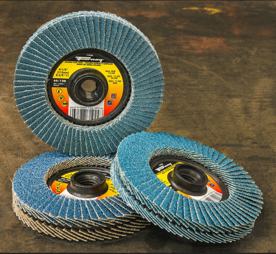

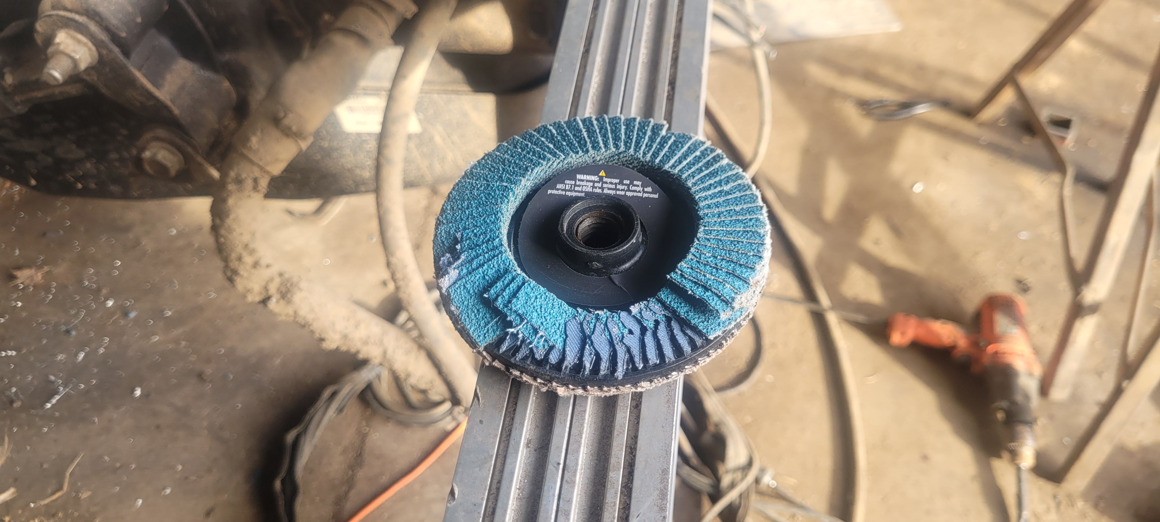

I figured to post this here as well as tractor talk because it's important to pass the word. I bought one of these double sided flap discs yesterday.
It didn't cross my mind how dangerous they are til too late, I have 7 stitches in 2 fingers to show for it. Anything touches the top side while in use will cause them to shred because the flaps are going backward. This is mine after maybe 10 minutes of work.
I really can't believe these got past safety. You would need to be very lucky to never touch the back side while in use I think. And those hard pieces of sand paper will make a mess of your fingers, or worse.
I've never seen them. Help me understand. Is each one two disc's that you separate for further use? When would one use the side that goes the opposite direction? Unless you have a grinder that runs backwards.
Not two pieces. You just turn it over once one side gets worn.
The ones made by Forney that I have saw scare me more due to them having a plastic center. I left them in the shelf.
I would not use one if you gave me a truck load of them.
Supposed to save carrying extra discs? Could have different grits for different applications. And they do give a warning on the page for their discs, not to allow the top disc to contact the work piece when the bottom is in operation. What could possibly go wrong?

If one were to use the guards supplied on all grinders, there are fewer safety issues. Operator error causes a lot of accidents; I have had my share, but fortunately, only little boo-boos! And I *always* use the guard; prevented damaged fingers a few times.

Since the first thing most guys do to their new angle grinders is take the guard and throw it in the trash, they can just throw up their hands and say, "It's your fault because the safety equipment wasn't in place."

They would not work with the guard on my 4 1/2" grinder.
