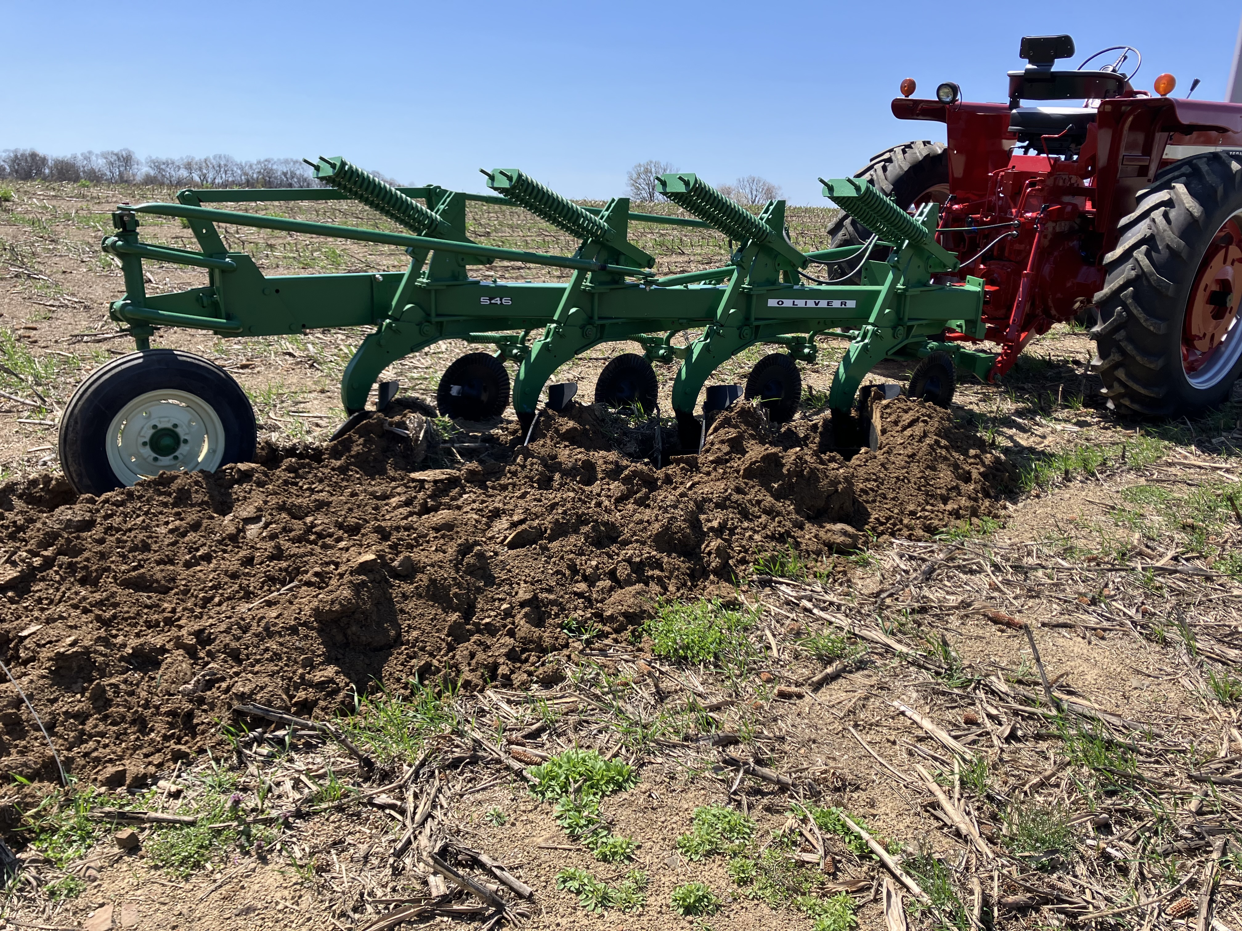

Is this my “plow” or my “plows”?
That would be a 4 bottom spring reset plow. Singular. There is 1 plow in your picture. Just like there is 1 plow in my avatar picture.
4 bottom plow, singular.
I have heard people call it 4 plows though. Also back when they rated tractors by how much plow they could pull, they would say "4 plow tractor" not "4 bottom plow tractor".
Nice set up. I had a 4x16 hyd. reset Oliver behind an AC 6060 which was the best plowing outfit I ever had. It was our first tractor with a cab. With full HVAC and "stadium" lights, it was a pleasure to run. And I had the wheels and plow set so the draft was nice and straight. Drop the tractor in the furrow and let it go.
Coulters appear set too high. I was taught to set them 2" above plow points. Great picture anyway!
He's striking out the land in that picture. Once he makes the next round with wheel in furrow the plow will be running deeper as will the coulters.
My intent was to set the coulters deep enough to cut through the surface reside. What I didn’t realize was how much wear there was in the casting that the shank goes through. So when it contacted the ground it was pushed upward. I have to compensate for that.
Some coulter's have grease zerks there but the grease is gone after one round.
You can weld up the wallowed out area or you can set it deeper like your going to do.
As long as the coulter's are doing what you want them to do, that's all that matters. You can ask 100 people how to set coulter's and you will get 100 different answers.

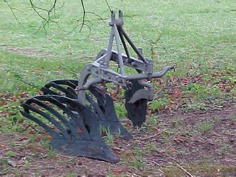

My H. Ferguson slatted-moldboard 2-bottom plow picture has a missing/broken coulter assemblyr. I loaned it to my BIL, he hit a large rock which broke the 1.25D mounting/adjustment bar and broke the plow point below that share. He threw the parts away.
Coulter's are adjustable for a reason, which is to cut above ground trash and underground small roots directly above the plow-point. This leaves a clean landslide the furrow wheel re-enforces..
