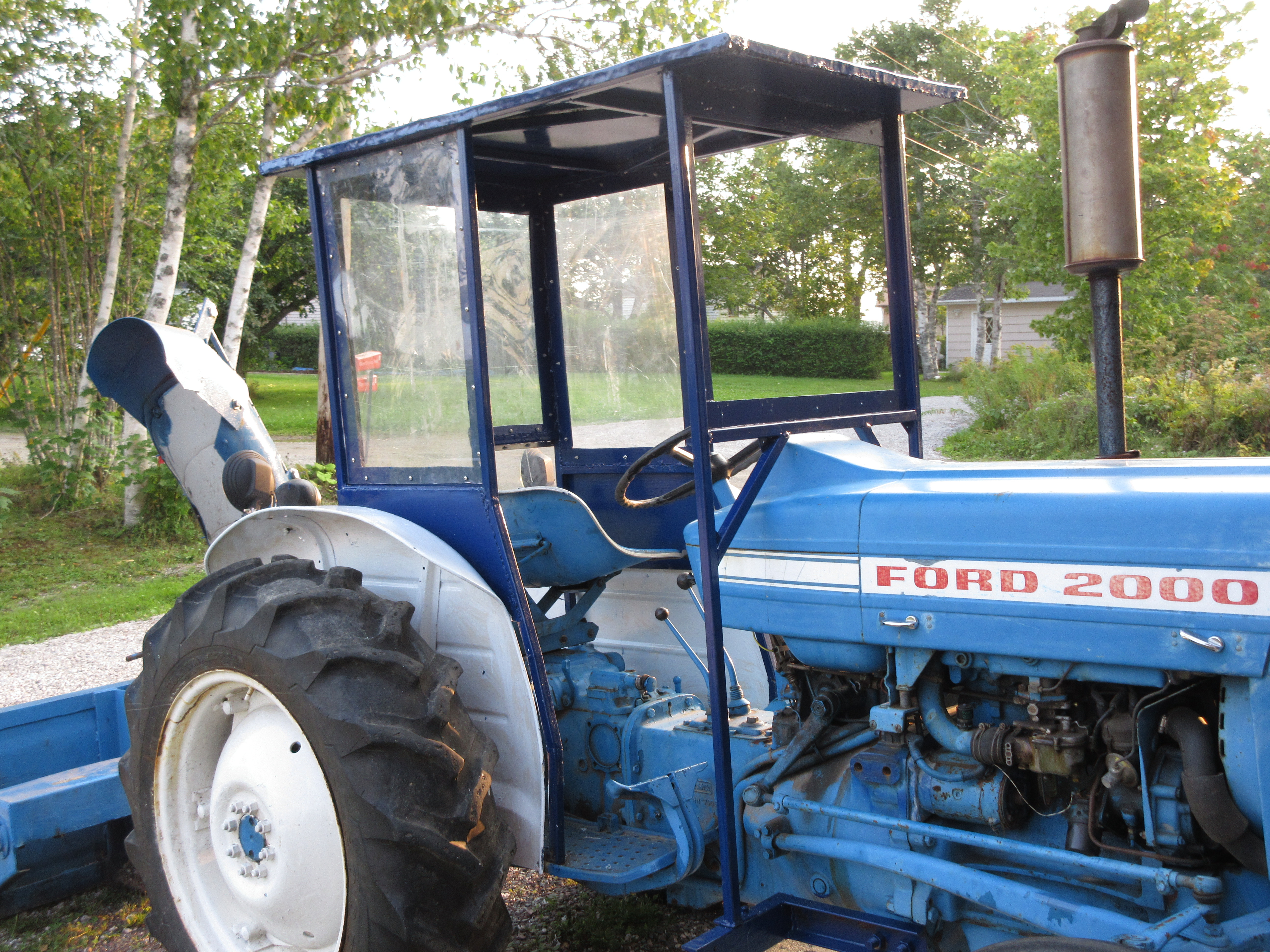

I want to purchase replacement plug wires for my Ford 2000 3 cyl gas tractor.
I do not like the carbon wires but would rather actual wires instead. Anyone know where I can purchase them?
It would be nice to have the boots to fit the cyl head.

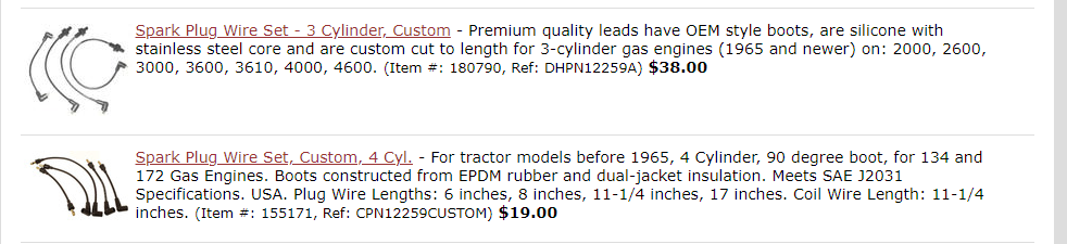

@DoubleO7 mentioned this to me. If you take the two numbers listed as "Item #:" in his post, and type those in the search at either Tractorpartsasap.com or Fawcett, it should come up with the correct part and either of those sites will accept the Canadian order. Our cart will change to what they are using later this year, but currently has a limitation where it only allows USA to be selected. The actual parts could be shipped to Canada if called in at the 800 number, but not through the cart.

Just ask them the question and they can research further if necessary. The description shows stainless core with silicone around it.
Here is's a nice article on the subject. Sounds like if it's stainless core, it would meet your concern. The article states the Carbon core breaks down faster but does a better job with RFI in automotive applications.

I don't know what your issue is with carbon core I have them on all my tractors most came from Donner's (what I took off of a customers car). For a 3 cyl Ford I would make my own if I could find the spark plug boots.
Update I found them on the net : ) I need to get a few things from them will add to that list. I keep a set of Belden wires for a 1970 chebby 350 pick up that I use to make up wires for Ford N tractors for $35.00 I can get two nice sets out of those. I will say most cheap aftermarket plug wires a poor quality at best : (...
2nd to all of that. If you can’t get the YT stuff from here which does appear to be the solid core good kind find an 8 cylinder premade kit like hobo said and then you can have a spare. If you have a decent parts guy at napa (Who knows maybe you have CAPA) he will know where to look. He also can sell you the old style if you prefer. I have noticed on the 2 cylinders especially the vibration kills the new wires much faster that thump isn’t something a modern engineer is going to consider furthermore that tube is actually kind of a pain in the buns to run fairly long expensive wires through so even every 5 years I’d rather skip that. Also running over the top of a dead furrow on accident regardless the tractor color isn’t something he will consider they don’t have those at the company meeting at the golf course. Consider the use of your tractor and plan accordingly just about anything will get you through the parade.
