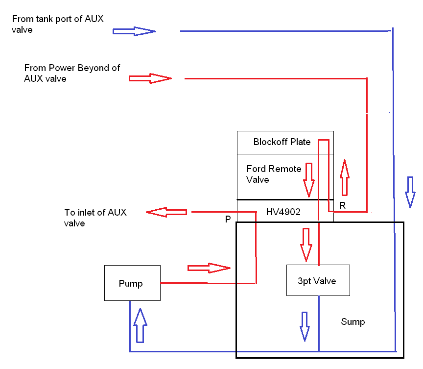

The loader (aux) valve will be the first valve in a three valve chain.
It will be receIvIng pressure from the P port on the takeoff plate and returning pressure to the return port on that plate. That pressure is then sent to the OEM valve on top of the plate, passes through that valve and on to the 3pt valve before it gets to tank.
The HV4902 instructions incorrectly call the return port a tank return port and it is NOT. It is by definition a power beyond (PB), high pressure carry over (HPCO), or neutral (N) return port.
Regardless of which plate you use for the takeoff your addon valve is always supplying another inplement (the 3pt) and it needs both a PB/HPCO/N outlet port and a separate direct to tank (T) outlet port.
If you use the HV4902 plate for your takeoff you would connect the outlet port on it to the inlet (P) on the aux valve and connect the PB/HPCO/N outlet port on the aux valve to the high pressure return port on the HV4902. You must then run a separate low pressure tank return line from the T port on the aux valve direct to sump. Thats often done by drilling and tapping the cap on the hydraulic filler.
Here is a diagram of the flow using the HV4902 and the OEM remotes. It should be clear why you need a loader valve with power beyond.
As Harry explained the HV5902 plate provides a third direct to tank return port for that purpose eliminating the need to find one somewhere else or modify the filler cap.
