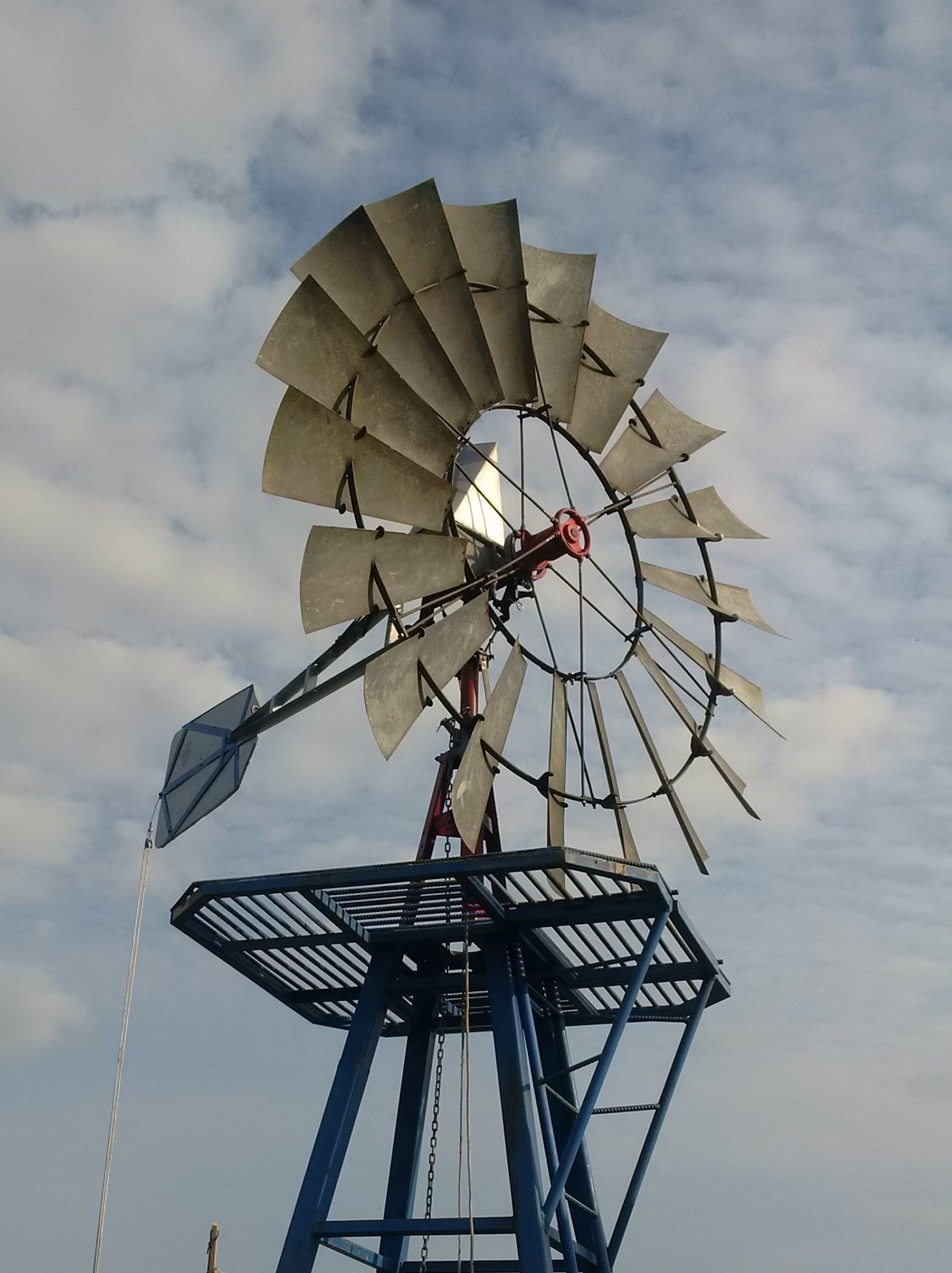

When I was building and repairing this old windmill I had a lot of problems with broken and missing parts, that's why it took so long.
When the wind blows steady, it pumps the water up and out with great force, basically a wind powered fountain on the prairie. The genius of the design and the simplicity make it 'timeless'. I made the tower extra sturdy because its a bit scary standing 30' up with those blades spinning beside you. Since its not coming down for at least 20years every thing had to be 'built to last', summer, winter, regardless.
Really nice tower. What are the legs made of.
The legs are made from 4x4 structural steel tube all welded. The platform and ladder are mostly 1"sch 40 steel pipe, 1/2" rebar and some 1.5x1.5 square structural steel tube. Then 3/8" thick steel plate for the machine to sit on, bolted with 3/4" nuts and bolts.

I have a 2" dia well that was abandoned on my property, too small dia for a submersible pump, so from a salvaged windmill from my parents farm I rigged this set up.
I call it 'St. Agnes Fountain' in her honour of course, pumps water from 100 ft down up into a 1000l tote, basically a fountain, runs when the wind blows. No electricity involved at all, no solar, just wind power. The best water ever. The tower was hand crafted be me out of scrap steel and the windmill was rebuilt/modernized by me too. Installed a new plunger pump with new riser piping and stuffing box. Since I always liked the Christmas carol Good King Wenceslas, I imagined St. Agnes Fountain to look like this. 'Right against the forest fence, by St. Agnes fountain ...'

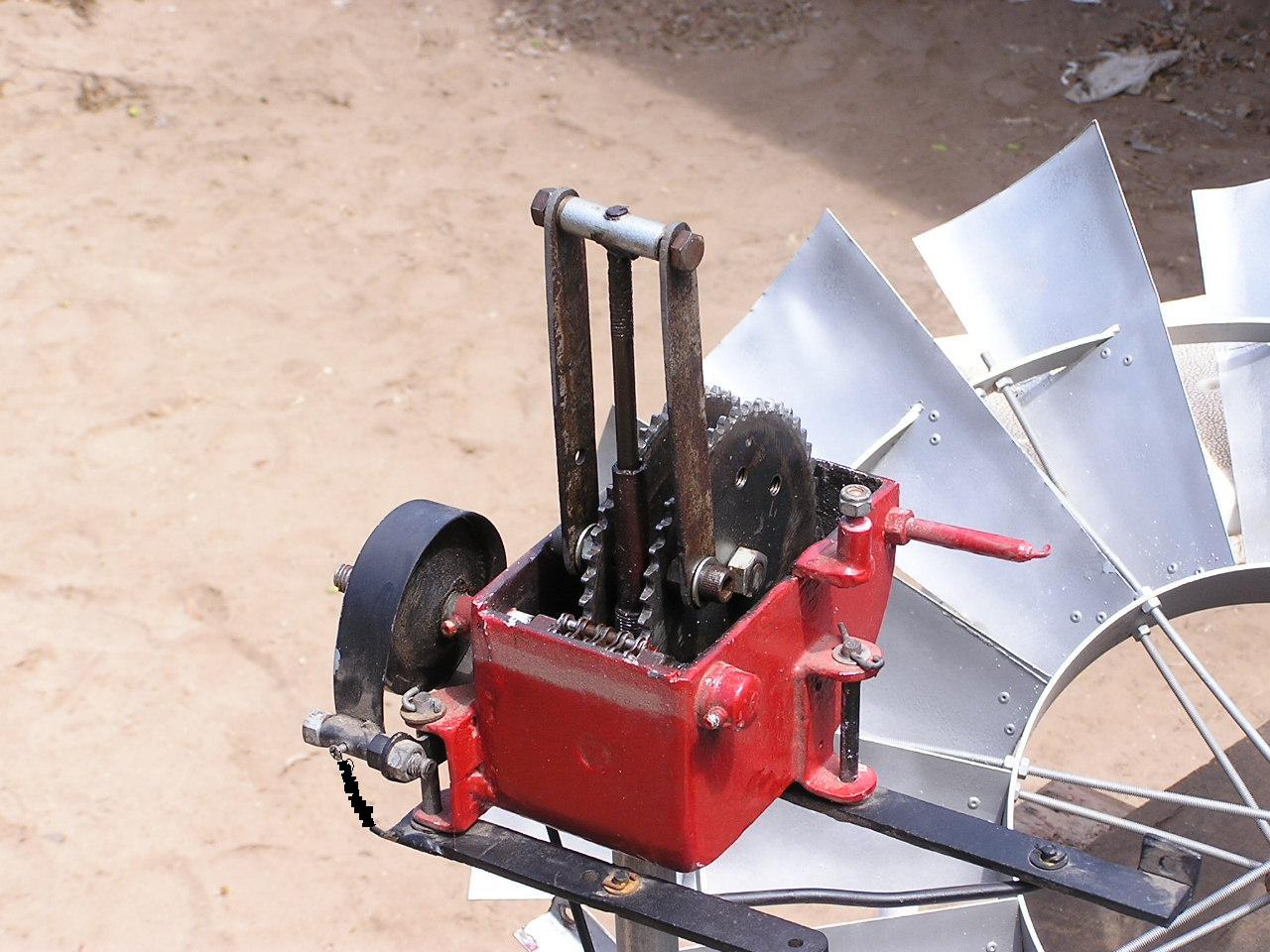

Here is my windmill. Handmade and homemade. Yard art. It cycles water from the tank underground and into the top.
It has a five inch stroke and will pump 3 oz of water per stroke.
I am still having a time perfecting and tweeking the pump cylinder as the leathers keep failing.

Is your cylinder a factory cylinder or is it a pipe you adapted. If the bore is not smooth on inside than the cup leather will wear quicker and rip.
The check valve is a 1 1/4" factory made valve from Lowes. The pipe is 1 1/4" PVC.
The pump valve is a cobbled up combination of 3/4" X 1/2" copper bell reducer with a salvaged computer mouse ball.
I wrapped leather strips around the bell reducer. It works but I need to experiment to get the right thickness of leather.

Thanks, This is about a twenty year on and off project coming up with various ways to make it work and look right.
Making the bull gears and building the closing mechanism took me the longest.
I would work on it for a while, start making mistakes, quit, and then later pick it up again.

I had a lot of stop and go while working on my Aermotor too. I ended up buying the plunger pump from a fellow in Ohio, Obrock windmills. I think he retired or died a few years ago. I was quite concerned about the pump fitting down my 2" diameter well casing, in the end there was barely 1/16" clearance, but it worked. My parents bought a property back in the 1970's and the windmill had fallen down and broke, someone took the original tower and left the gear box and blades as garbage, no 'rudder'/vane either. I had to repair/make those parts. At some point I plan on having a small pond where water can go.
