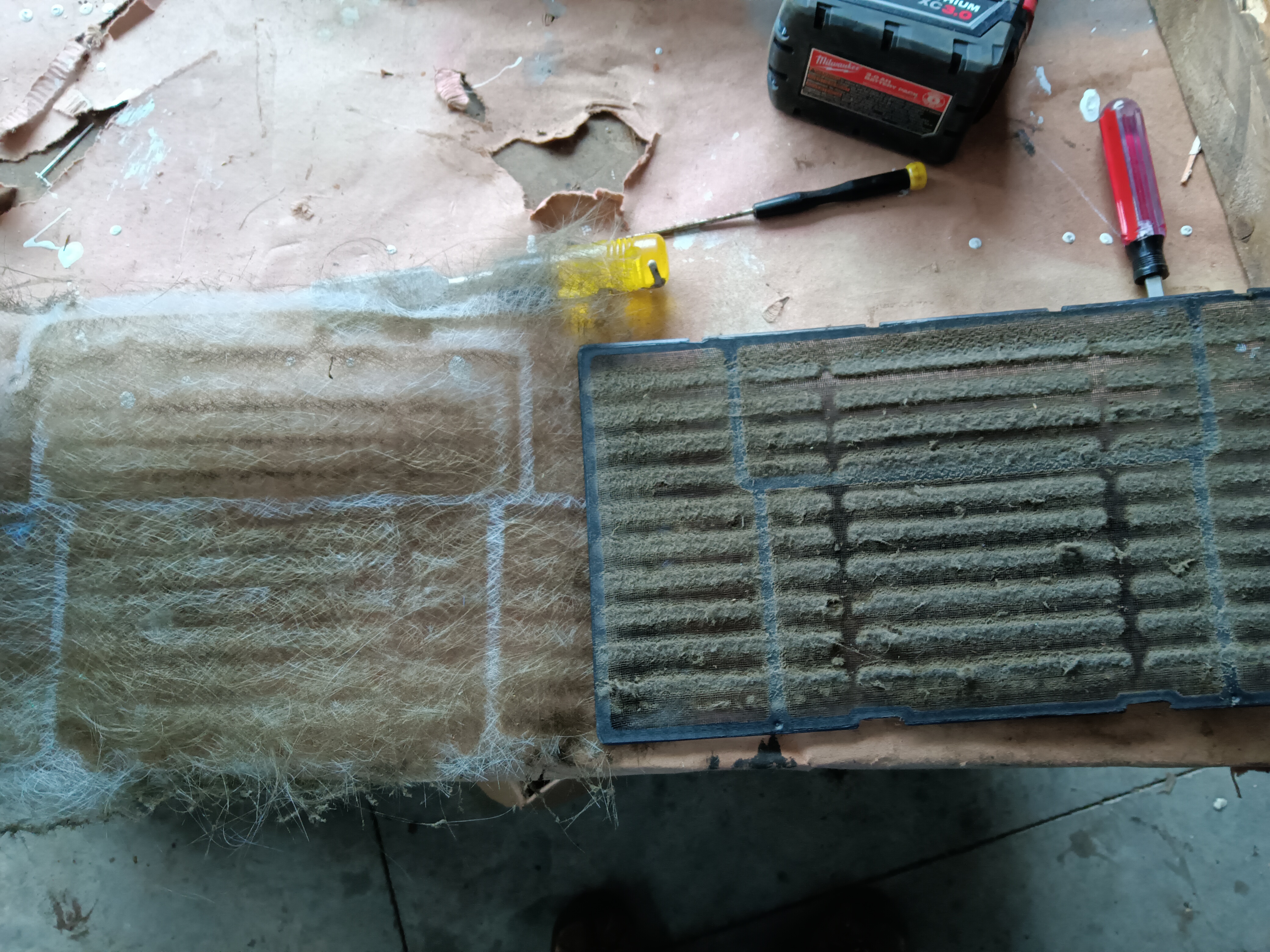

Last year I did an experiment using a cheap fiberglass furnace filter I used scissors and cut to fit.
I added a second filter behind the window AC's I use in rentals.
For the first time ever, the fiberglass filter prevents black mold from growing inside the AC's
The filter on the left is the second fiberglass filter I added and the filter on the right is the OEM AC filter.
You can also buy cheap foam filters you can add to your original filter.
The second filter proves the OEM screen like filter doesn't do a very good job.
Did you have day by day comparisons of the humidity for say the last four years so that your results could be considered meaningful?
