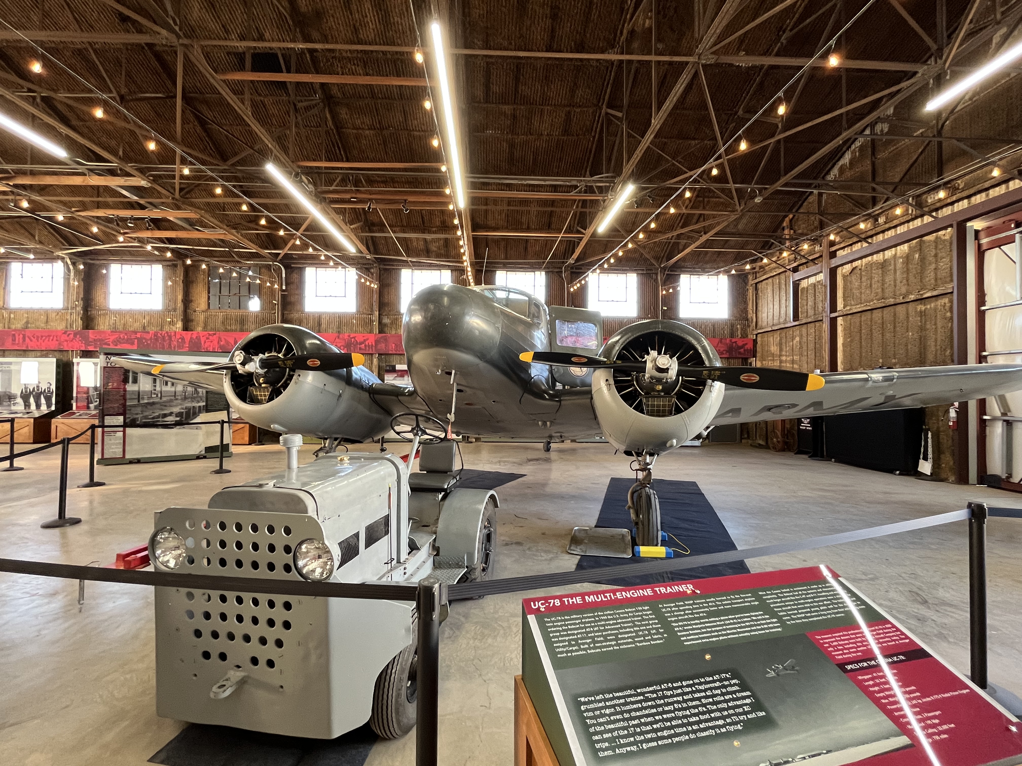

At the museum we have whats labeled as a 1943 Ford Ferguson 9 aircraft tow tug. Looking to not only verify that thats cirrect but also to get a shop manual and parts manual. The main issue is there is way too much play in the steering. You have to wig-wag the steering wheel about 1/3of a turn each way to keep it going straight. Need to figure out what to replace. Would appreciate help.

Thanks for the pictures and info. I looked thru all my pictures and this is the only one that that the tug. It looks stubbier than those people have sent me. Im a little confused as to what I do have. Im post better pictures at the end of the week. Thanks again.
Thanks for the pictures and info. I looked thru all my pictures and this is the only one that that the tug. It looks stubbier than those people have sent me. Im a little confused as to what I do have. Im post better pictures at the end of the week. Thanks again.View attachment 63330
Looks like a TUG brand purpose built unit.
Maybe a Clarktor brand.
What engine does it have?
I believe i have found its true calling. I now believe my tug is a Clarktor 6 with a Chysler flat head 6 in it. I’ll have the ladies at the museum do some measurements on it and send me some data along with pictures. Sure glad i found this forum.
Your tug may look stubby to you but it looks waaay longer than an N to me. Your tug could have both a three speed and a torque converter.
Can you tell me the usual location of any identification data plates on the Clarktor 6? Or something specific that will only be associated with a Clarktor 6?
I’ve spent a lot of time looking at all the Clarktor 6 websites and cant find a single one that matches our tug, but the 6 is the closest I have found.
