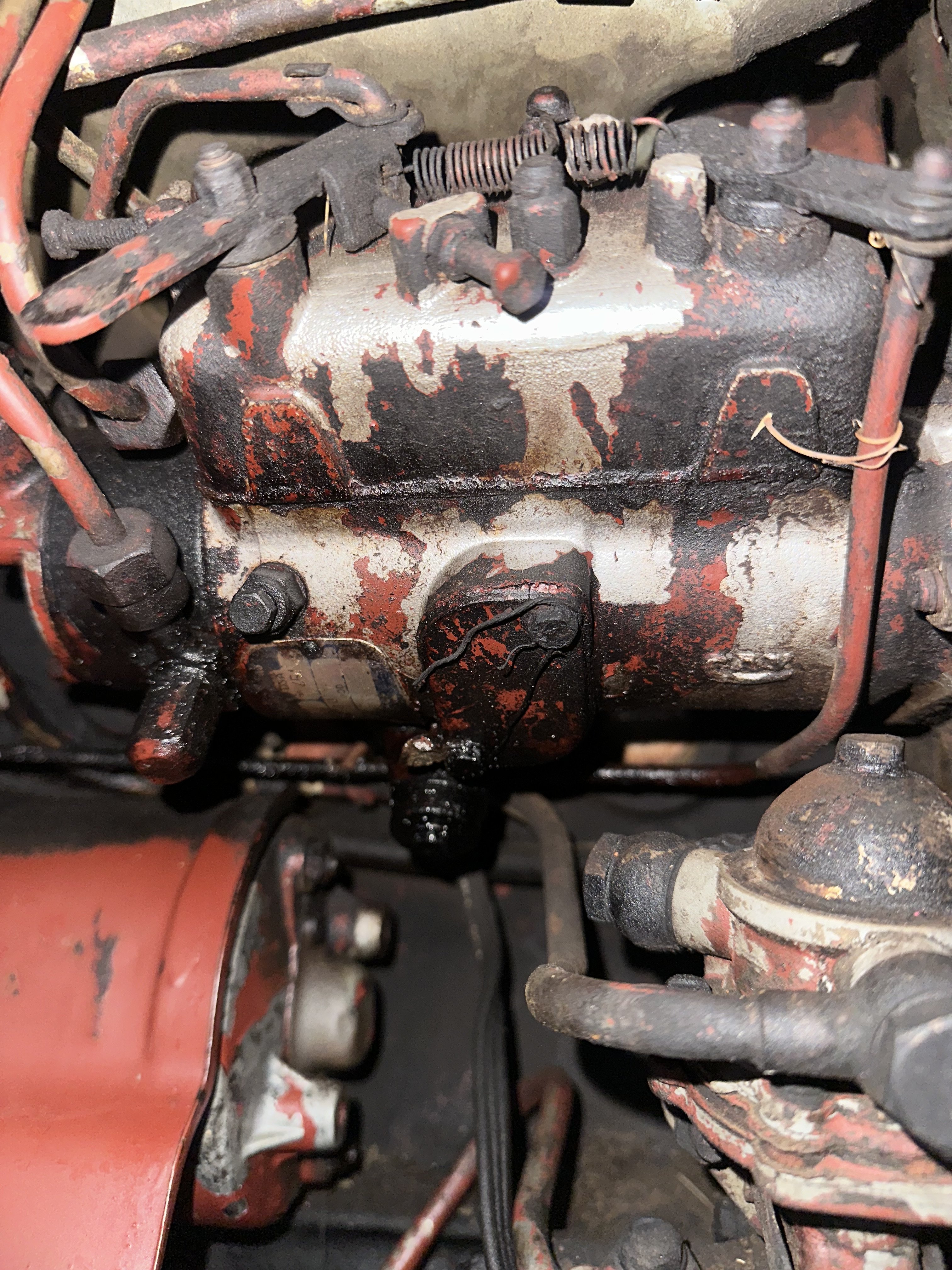

Update so I got the primary filter changed and bleed the lines ..turned engine over two or three times times I noticed fuel coming from behind injection pump out this round part on the engine side of the pump. It’s leaking pretty good ..I’ll load a pic so you can see ..let me remind you I brought this tractor not running with 1800 hrs ..I was kinder happen when it turn over ..but now Ineed to fix this leak ..it does look like it can be screwed out but not sure any help will be greatly appreciated

That round toad stool piece is the pulsation dampner. Yes it can be screwed out and replaced. Call a pump shop with the pump numbers.
