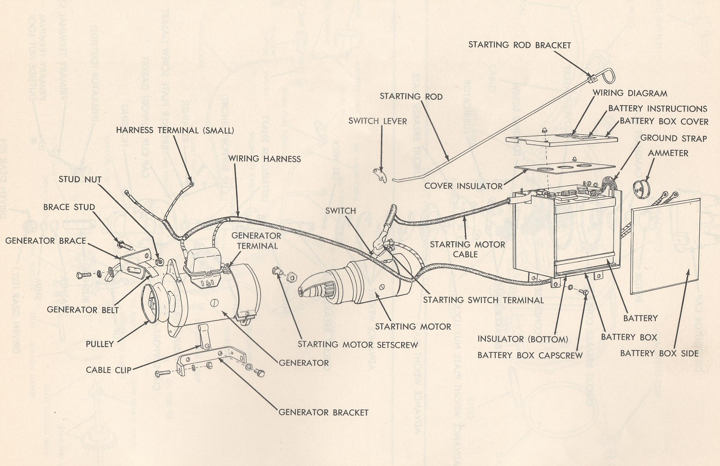

Hi all, I am working on an Allis Chalmers C and the people that left it for dead didn't label anything on the wiring harness. There are 4 wires coming out by where the engine and bell housing meet together and there is already a two worse running to the starter and there is another one that the online pictures told me to put there but there is only one extra one supposed to be there. there is a 12 volt conversion done still using the generator not an alternator. any help is appreciated and I am at my wits end with this thing.

A 12-volt generator needs the correct regulator and would not need to use all the terminals/functions of the multiple position light and charging switch in the box below the steering wheel, the 6-volt generator used.
Below is a link to an Allis Chalmers manual for the G, B, C, and CA. There is a wiring diagram in the C section of the original 6-volt wiring. You might find a wiring diagram for 12-volts but details on the generator and regulator will be needed, as well as the gauges and switches it has. Your description won't do it. Try drawing a sketch of what you have. Pictures can help but a bunch of wires in a loom or taped together don't tell much

Resistors in 6-to-12-volt conversions are generally used ahead of the original 6-volt coils to save buying a true 12-volt coil. I can't say I have seen a resistor mounted on a 12-volt generator as part of a conversion. If you look at the original 6-volt wiring diagram the resistor was controlled by the charging/light switch. In the low position the field current went through the resistor to reduce the charge rate. When in lights on or High position the resistor was bypassed, and the field receive full current to give a higher charge rate.
Sounds like a good sketch of what is there is the first step, along with seeing if you can identify the generator and regulator. Figure out what you have to start with.

Would this help?
https://public.fotki.com/DickL/parts_drawings/wireing_diagram_3.html#media
The wiring diagram is the same one that is in the linked manual.
