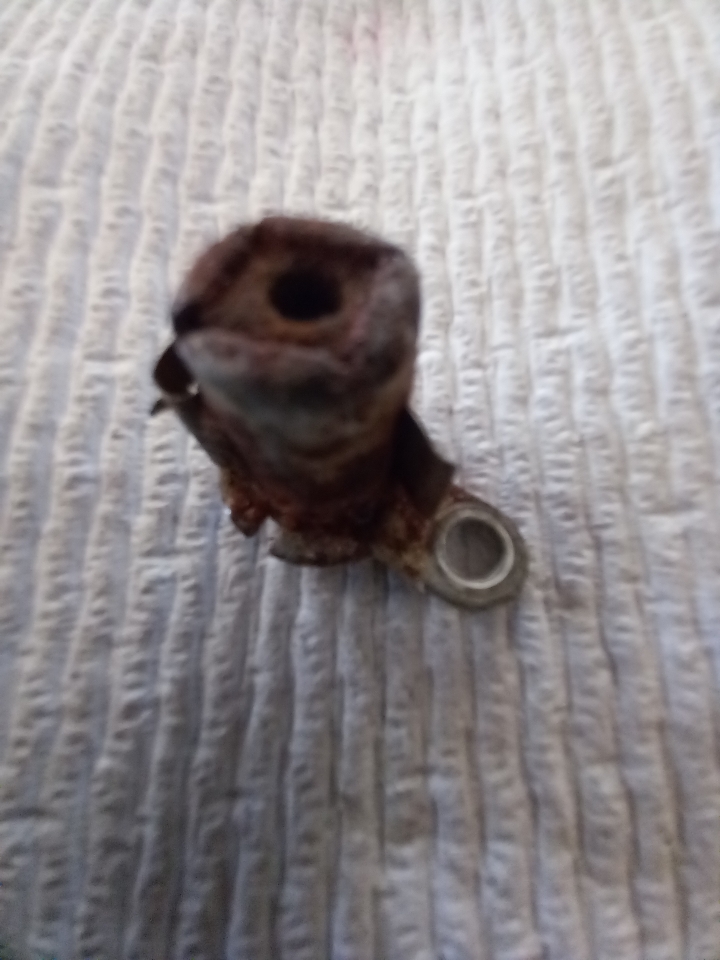

(quoted from post at 06:46:19 09/15/23) Good luck with it. I've had a D-14 for thirty years - most reliable piece of equipment I own. I would suggest getting a shop manual for it
<img src=https://www.yesterdaystractors.com/cvphotos/cvphoto163218.jpg>
Thanks Part Time Pete. It's going to be a "toy".
You tagged onto someone else's thread about a D14, from months ago and posted a picture of something, with the note: "Here's the picture".
I suggest you start a new thread of your own and provide details of just what this is and what it goes on along with a description of what you are trying to accomplish. You have posted before about an Allis Chalmers B.
