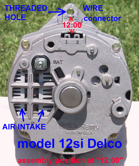

The regulator is not intended to be used for a Delco 3 wire (assumes the alternator) eliminate the regulator mounted on the tractor from prior owner. The wire to the solenoid should be fused with a 70 amp fuse link to protect against ruining the alternator The #1 wire attaches to a oil pressure switch from NAPA or? that has 2 terminals, The second terminal is connected to the battery Plus (same as the fuse link) this excites the alt when running and shuts it off when no oil pressure (off)). The #2 terminal does attach to the BAT stud. Jim

Does your alternator have a two spade plug in the side as the one in the photo by Jim has shown by the 12:00? If so it has already been converted to a 3 wire if those spades are connecting to wiring. If the side terminals are not connected then you have a 10SI that has been modified for one wire self excite operation. I doubt this is the case but you may also have a Delco 10DN alternator that requires an external regulator. It would have a two spade plug into the back in a configuration like this.. I I ..instead the.. - - ..that the 10SI internal regulator type has. My guess is the regulator you see is not active and was for the original alternator and it has a Delco 10SI 3 wire already in use. Does the “battery” light in your dash come on with the key on and the tractor not running then go out when the engine starts? If so the alternator was installed utilizing the dash lamp to power the alternator’s excite circuit.

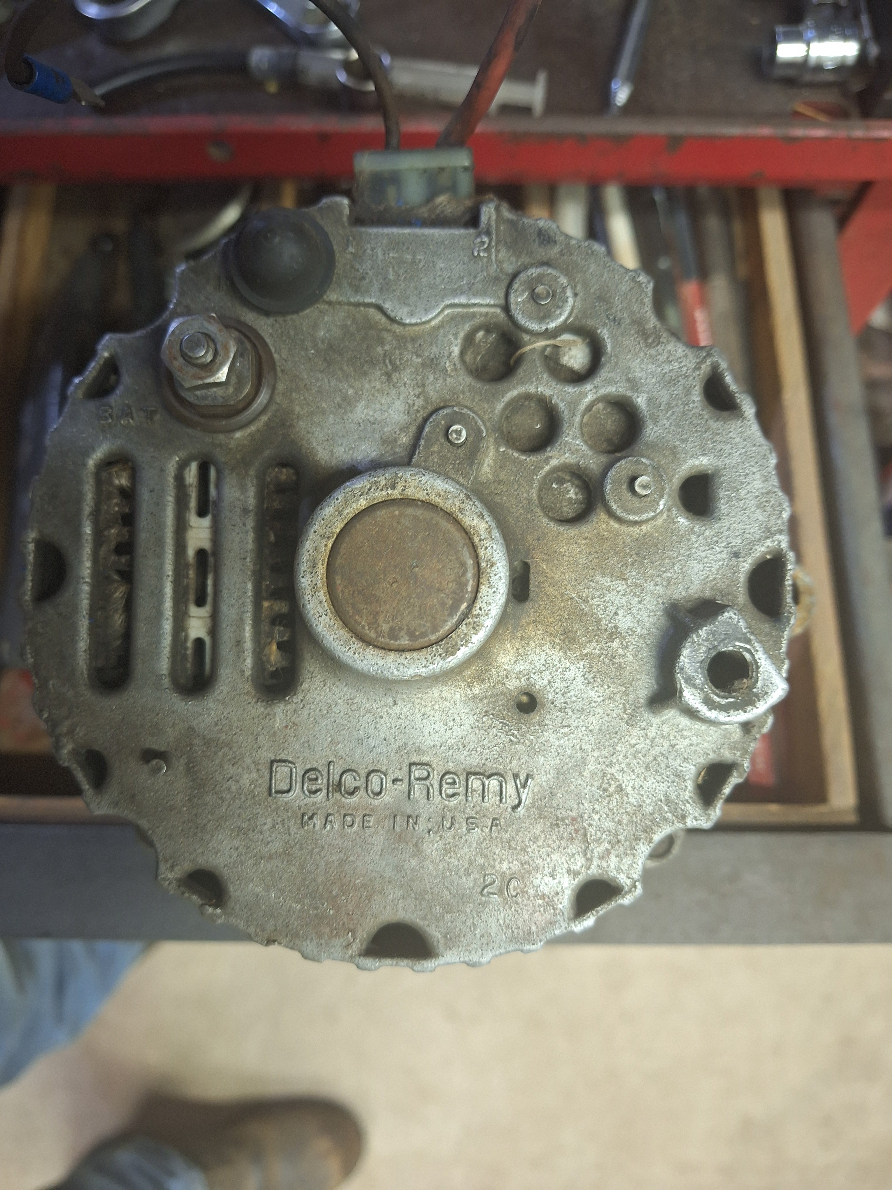

Took it off this morning feels like the bearings are gone.. since I have to buy one anyway is this model suitable or should I get something different??
That model is suitable and commonly available, it is a common three wire Delco type 10SI alternator. The alternator in your picture has the optional "R" terminal under the rubber cover above the output stud. As it has the protective cover on it, your tractor is not using it, and you don't need to have one with the "R" terminal. (From a Delco instruction sheet: “R” Terminal - Relay terminal carries half systems voltage and may be used for certain types of control relays, charge indicators, tachometers or similar devices. This may be the third terminal in the voltage regulator opening or a threaded stud or pin on the case near the output terminal.)
