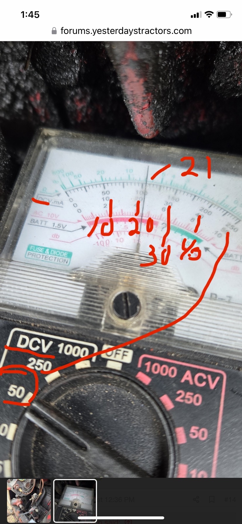

Thanks I held a powered wire to the field terminal and it worked. So I just A.A. engineered it with a wire and let it charge for a awhile and then turn toggle switch off.

You want to be careful doing that. If I am reading your meter correctly 21 volts is a bit high to be charging at. Did you have the toggle switch on previously? If it wasn't, the regulator would not have worked-- if it is any good.
21 volts is how I am reading it as well. If that little red wire that came off the switch running up by the intake manifold is the main wire to the battery/solenoid etc. carrying the charge amperage it probably won’t take that charge rate for very long. I agree with Jim and others, get a 3 wire Delco 10si, wire it in properly and forget about that switch.
15 volts
I am taking this to mean it reads 15 volts with the switch on and the regulator plugged in, which would mean the alternator and regulator are working. If I had to keep that set up for a while, I would move the toggle switch to the red wire which goes from the alternator post to the regulator and run a 10-gauge wire from the post on the alternator back to wherever the second wire on the toggle switch currently goes.
