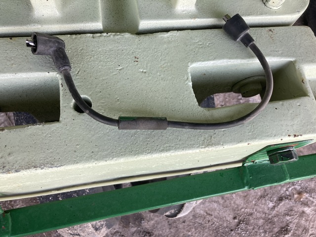

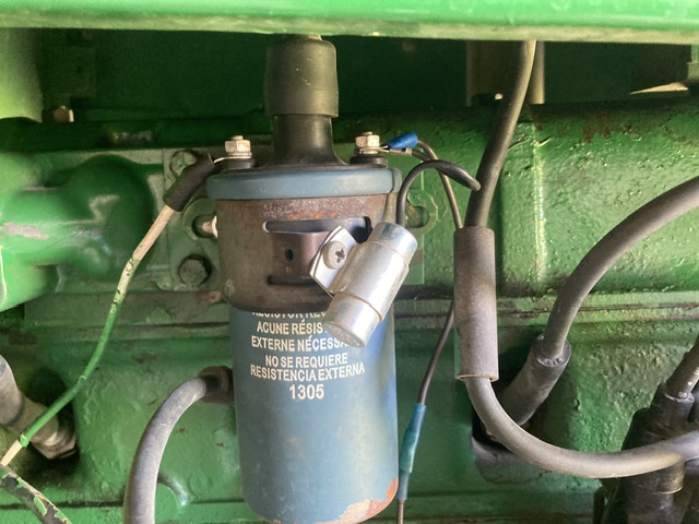

I put an older fender mount radio on my gas Oliver 1655.The static is bad at all engine speeds. Is there anything I can add to cut the static? In the 60’s and 70’s radios came with a round resistor? That you cut the coil wire and screwed it into the wire to cut the static. Are these still available? You can hear the radio but the static is annoying! I tried adding a condenser to the coil but it didn’t help.
Just wondering if u have the condenser on the correct terminal. I remember them being on the coil for radio interference but don’t remember which side it was hooked too

Suppression capacitor would connect to the ignition switch side of the coil. To me, it appears the O.P. has connected it to the distributor side of the coil.
In theory, that will not be good for breaker point life.
I'm not gonna hold my breath that swapping it to the other side us gonna help with the static, tho.

Yes I figured it goes to the ignition side. Also. Carbon core wires are of help. I remember on the older vehicles you could hear the plugs firing On the radio. Didn’t notice any point trouble. 🤷🏻‍♂️
Resistor plugs , resistor wires or wound suppression wires .
Alternators sometimes need a capacitor .
No idea what the tinkering with the exterior capacitor on the coil is supposed to accomplish .
