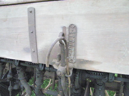

So I just picked up this old grain drill today. It's an American Seeding Machine Co. Farmer's Favorite No. 5 (at least I think that's what's painted on it). It's really not in too bad of shape, considering it's age. I'm guessing it was made sometime in the first decade of the 20th century. Call me crazy, but I plan to fix a few things and use it. Couple problems however; it is missing "seed actuators" (round discs in hopper, with finger-like points), and 2 of the lower gears which turn these. There's also so many levers, I'm not sure what all of them do. Take a look at the photo's and let me know what you think. Could definitely use those missing parts and a manual if anyone has them! I think Oliver Superior drills might have interchangeable parts.

One is to set the pounds of seed per acre. Another is for pounds of fertilizer and the little one with the pointer looks like it might be some sort of acre counter. I would paint the thing back to original colors and park it in the front yard. There is an old one sitting in my back yard made of wood but it is a little outdated for any sort of planting.

The small meter is an acreage calculator. I'll tell you they put a lot of thought and engineering into these old things. I love the variable speed gears and how they work!

From the end of it I see it says fertilizer,so it has 3 boxes,correct? The small one is for clover seed,alfalfa,that kind of thing. One of the big ones is fertilizer,the other big one is seed,such as wheat,oats,rye,etc. Those flat spyder shaped gears that lay flat in the box are for fertilizer. Even if you do put it to work,I don't know of anybody who runs fertilizer through a grain drill anymore anyway. That's always spread bulk. Follow the linkage down from that guage that says something like "pecks of seed" and it should lead you to the adjustable gears. If it's like the early Olivers,it's a big vertical gear under the box,on the axle,with a whole bunch of knobs on the side with another small gear running up against it.

Your drill has 3 boxes, the small one on the front that is mounted seperate is for grass seeds and the fertilizer and grain seed are in the one big devided box with the grain being in the front box and the fertilizer with what you are thinking is for sowing the seed are actually called fertilizer feed wheels. I do have some of those parts in a drill I do not know if I am going to fix up or not but do know of then in a scrap yard that if I decide to fix it up I will likely get that drill. The lever on the left end of the box is what sets the fertilizer rate on yours. I have a slightly older version that I am going to fix up, Have several Amish waiting for it when I get it done but is having to wait a while due to a heart attack and 5 bypasses. Mine has the same wood wheel (omly one left) that is in better shape than yours. Some of your controls are more like the newer from the 40's model 26 Oliver. Mine has on the cast ends, Superior Double Force feed Grain Drill MF'D BY American Seeding Machine Co. Superior Division Springfield O. U.S.A. on both ends and right end has Superior Force Feed Grain and Fertilizer Drill With Variable Speed. The earliest pat date on mine is Nov. 27, 82 and last date is June 27, 99 or 112 year ago. The Oliver museum does have the manuals for the No. 26 drill. The oldest and newest I have here are very simular but there are differences. The seed controls and settings I would say would be the same as in the books for the Oliver No. 26 drill. I am dealing in them with the Amish and delievered 2 of the steel wheel model 26 13-7 drills and have a low rubber of same size that I do not yet know if will go for parts or rebuilding and then this one that is old enough that it does not carry the Oliver name. Thought last winter I would get a parts only drill and it went for $150, $50 more than I though it was worth.
