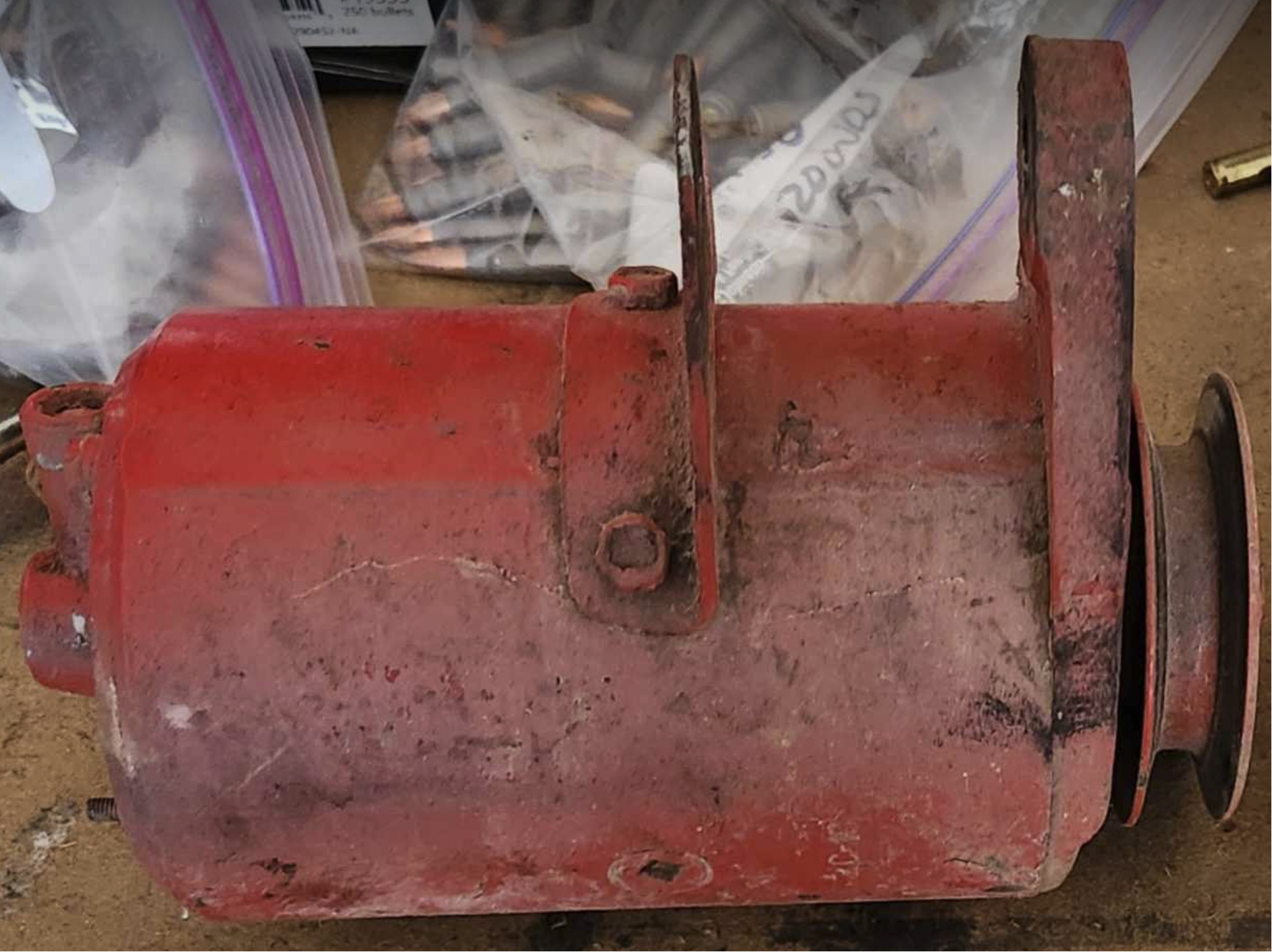

Group,
Working with a 49 8n. Removed all the wiring and put it back to a 6 volt system. Put in a new battery, a new voltage regulator (https://just 8n's/8N10505B-Years-1948-50-Voltage-Regulator-8N-Before-263844) a new resistor and mounting block assembly (https://just 8n's/A8NN12250A-Years-1948-50-Resistor-And-Mounting-Block-Assembly) and had an original ford generator rebuilt. Bought all new wiring and wired everything up based on the diagrams in the old manuals. When the tractor is running the ammeter is a 0. When we turn on the lights, it goes negative. With everything new and/or rebuilt, what could my issue be?

Iron pole pieces in gen need residual magnetism in order to initiate generation. It gets this from polarizing the generator. For your gen, this is done in about one second by shorting Battery to Armature.

Thanks, after doing the above jumper wire technique, we drove it around the block (in a neighborhood lol), never showed a charge.

If the generator is a B circuit (probably not) the field is polarized by removing the wire from the Field terminal on the regulator, and jumping 12 volts from Bat to the F terminal on the gen. (not the regulator terminal. Jim
Are you certain, positive, 100% that you hooked up the ammeter correctly? An ammeter hooked up backwards will show a charge as a discharge as the current is flowing in opposite direction.
Charge your batt fully. Take the charger off, wait 2 min and measure the resting voltage of your battery. Record that reading, about 6.3 or a bit more volts. Start the engine, and run it up to 1200 RPM. Now measure the voltage of the battery. Is showing 7.4 or greater volts? If yes, your ammeter is wired backwards, swap the two wires on the ammeter. If it is below 6.3, you are not charging.
I've had marginal luck with new V Regulators. With the tractor running at 1200, measure the voltage on each of the three legs on the V Reg. Report back here.
As a generator test, you can temporarily bypass the VR with a jumper from BATT to ARM while running and if still no charge, add a second jumper from Field to Ground. At this point the VR is doing nothing and Arm is connected to battery and Field is seeing full voltage/current.
We took the generator and voltage regulator back to the shop that rebuilt it to check it over. He had to resolder some wires, but then told me that he could not get it to charge using any of his voltage regulators he had in his shop. But he could get it to provide a consistent charge going through a cutout regulator. After reading several posts, it seems like the general consensus is a voltage regulator is a better and more consistent charging solution, but I curious why this generator would not work while going through one but will would going through a cut out?
