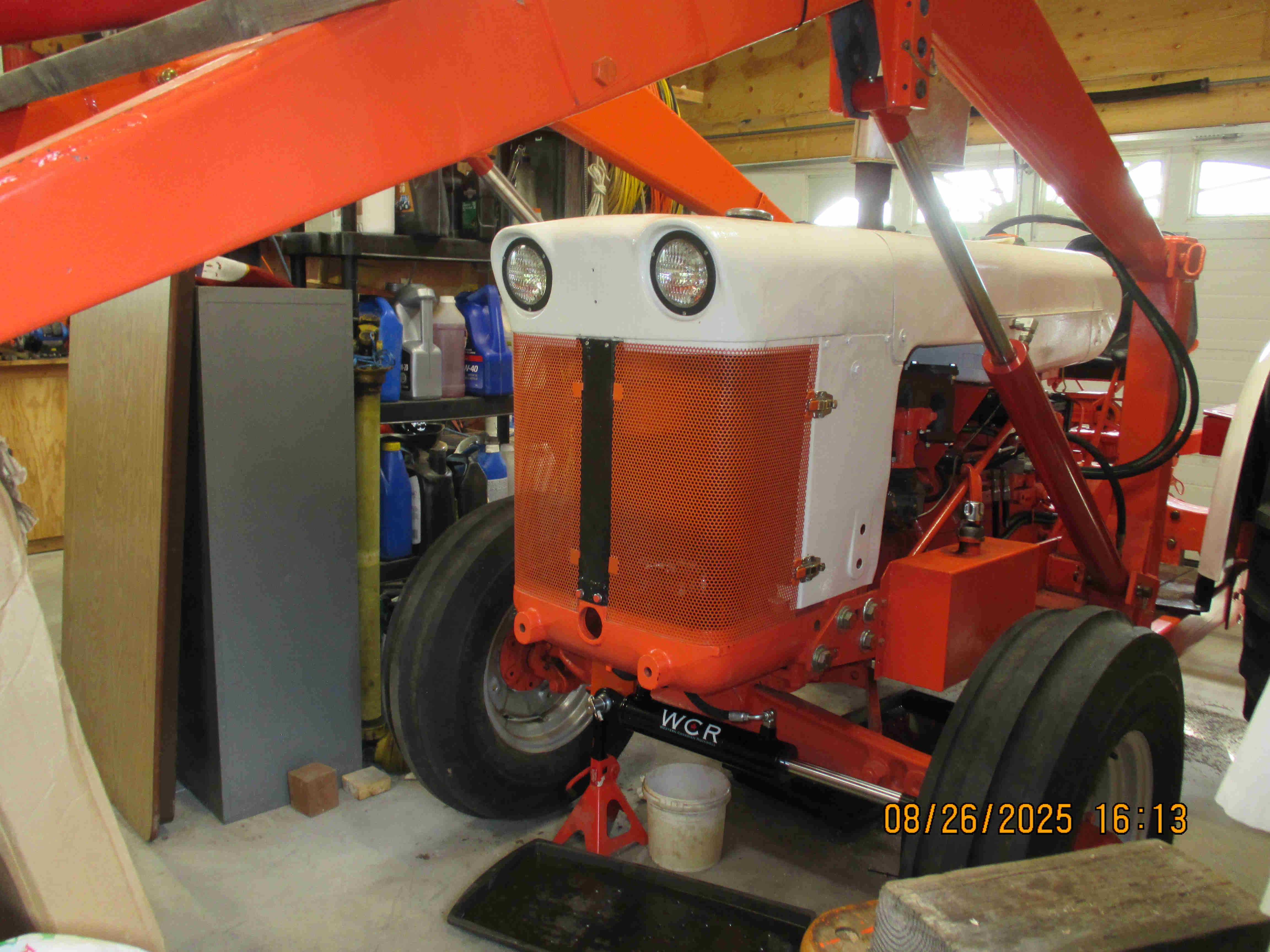

OK. so here are photos! I hope you don't think that I've butchered the tractor, I'm just trying to make it work for me and therefore made a few mods!
  • I added an FEL, the arms and bucket were off an 8N I'd had for a while, arms and bucket were seriously straightened out and reinforced - the tractor had an old, small FEL probably used for clearing out manure and it was beaten up;
  • There's a 3-way hydraulic valve to split the flow between the 3 pt. hitch and the FEL, somewhat as previously;
  • As a result of a lowish hydraulic pressure I used biggish cylinders and had to add an external hydraulic tank to give more volume - unfortunately, this limited the turning circle for left turns;
  • I did away with the original hydraulic valves - after having removed and reinstalled them 6 times, also tried good used ones - in the end, the problems I was having were the result of cross leakage between the stacked valves;
  • There is a flat plate where the valves used to sit with a 1/2" pickup from the pump and a 1/2" return to the tank/reservoir;
  • Oil passes from the pump through a Priority Flow Control Valve (Prince Mfrg - from Steiner IHS740 - with a pump flow of ~8 gpm in-house modifications to this valve were necessary, if you're aware of the valve you'll know what I'm talking about(!) - the excess oil from the PFCV goes to the control valves on the FEL right post;
  • I fought with the Eagle Hitch on and off once too often and changed the system over as shown in the pics - needed to get a few special parts made to make the change; and
  • The front grille was all smashed up so I had to get new 'doors" made.
I stripped and worked over the whole tractor but, of course, didn't take gear boxes or engine apart since all that checked out well. Yes, I missed out on the Hand Clutch, not even realizing what it did!! OK, the question now is (apart from the year and S/N of the tractor) how am I going to pull out that second clutch adjustment pin so I can make the adjustment - it seems to be stuck; does that pin body unscrew by any chance?
Appreciate your patience and all your advice - long retired but clearly still learning! (I'll have to do a separate post for the other pictures!)

Kudos!!! you have put a lot of time and bucks into that tractor. Nice clean routing of new hydraulic lines, about the best that could be done. You see the missing transmission shift pattern just to the right of the shifter stick? The triple range shift pattern if it still exists will be on the torque tube cover under the battery. The hand clutch adjustment pins are positioned exactly as they should be, I'll explain that when I write the adjustment procedures in the morning. I didn't have time look at all your pics, you did a good picture posting job.
It might be too late now, but if the hydraulic tank you added is affecting the steering to the left, is there room to add the tank at the base of the loader arm on the right side of the tractor? I would think you would not want the steering limited in any way.
Thanks, DRussell: It’s a bit late to move the tank now and, of course, I have thought about this since realizing the left steering issue. The key for that tank, its capacity and location, is to maintain the oil level conditions in the main torque tube reservoir since it augments that reservoir. I concluded that it was best to put up with the left turn limitations figuring that the majority of my turning is to the right. It’s not too limiting and I’ve guarded against wheel contact with the tank by using the end of piston travel in the cylinder as an end stop.
As to the 3 point hitch. I just found the rigid Eagle Hitch arms too difficult to line up, not being able to twist and turn as I once could! Last year, I gave up in a bit of a rage after trying to hitch this tractor up using the EH to my disc mower and that was the last straw hitch-wise!

You might consider putting some support in this valve area. That is quite a bit of weight for the potential vibration and possible pull of the hoses.

On the “overhanging” valves, yes, that is a concern and the one on the 3-pt circuit is potentially a similar problem. These valves are not meant to be unsupported, especially the 1/2”; the two you flagged are 3/8”. My implement quick connectors are also a bit vulnerable too. Another day - which may end up meaning that nothing will get done until something breaks!
