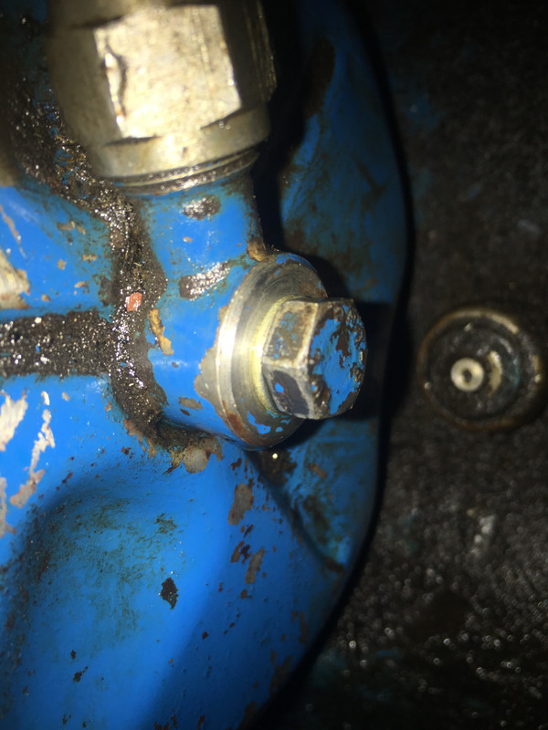

Well, that was an easy fix. Now I have a leak at the pump reservoir bolt. Never leaked before, but the seal fell apart when I changed the filter. Ordered a new $22 washer and now it leaks. Does it look like I’m missing something?
