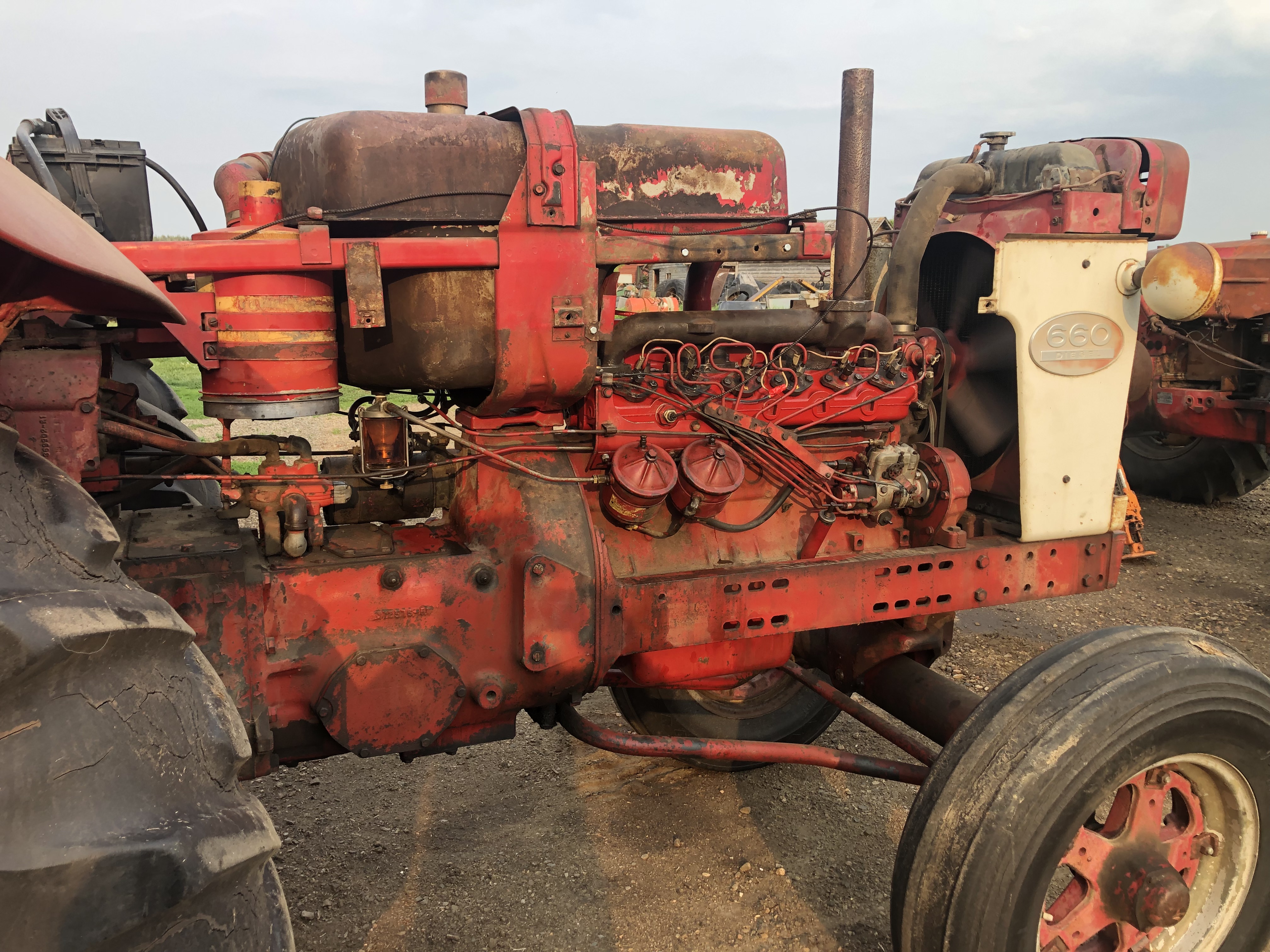

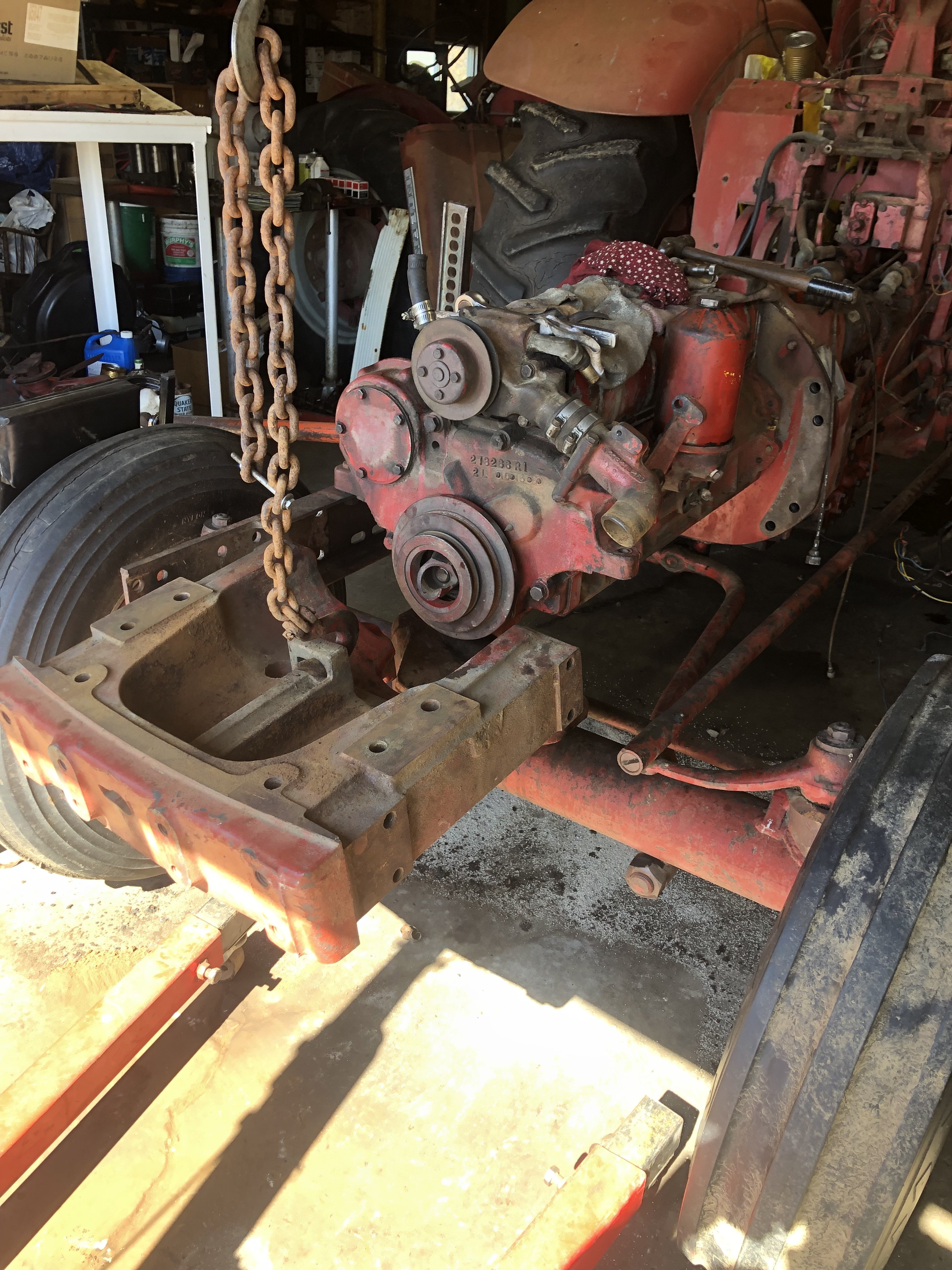

The 660 is running perfectly now. Starts with 2 revolutions , A world of difference on starting with having the valve protrusion at the top of the spec , instead of below the bottom of spec. Did a lot of work on this engine.was a big job. Need to retorque the head and set valves and put sheet metal on. Change tires Then try it out at the pulls against the 830 john deeres. No problem there. Lol.
