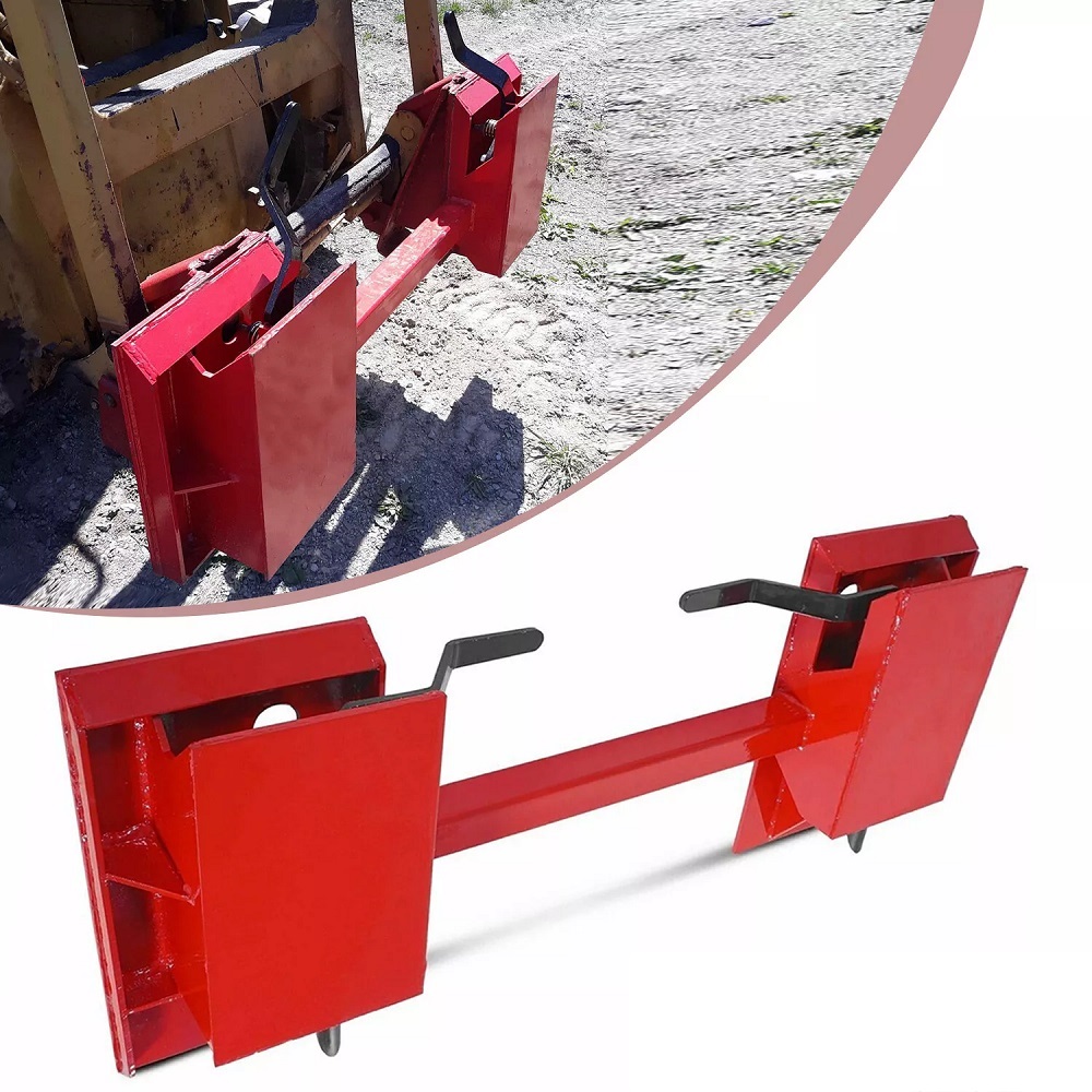

When you say bobcat do you mean the brand Bobcat or the skid steer style quick attach?At this point I think I would put a universal (bobcat) quick attach on it. I think the loader is built heavy enough for the hydraulics of a Dave Brown.
I just did a similar cylinder on my Massey, it was $32 for all the seals at my local hydraulic shop.Good to know, thanks. I knew I could take it apart and identify the parts that way, didn't think it would be that much cheaper though.
Yes, skid steer style.When you say bobcat do you mean the brand Bobcat or the skid steer style quick attach?
I've been thinking about it. I'd kinda like to build my own but I'm not sure how much work that isYes, skid steer style.
Thanks, and these cheaper ones are still built well enough?You can get ones like this that you add ears on to fit your loader. The longer loader side allows room for different ear arrangements o be installed. They are on eBay, Amazon, and likely found other places. I've used several. Sometimes a bit of adjusting to the latches, grinding the top taper that fits in the attachment plate, along with fabricating and installing the ears, but price can be 1/4 or less than some of the brand name ones you can buy complete.
We have put a couple on JD 2030s, no problems. Have been used on grapples handling logs, forks on many things, bale huggers as well as buckets. Tractor's have loaded rears and ballast on the three point.Thanks, and these cheaper ones are still built well enough?
