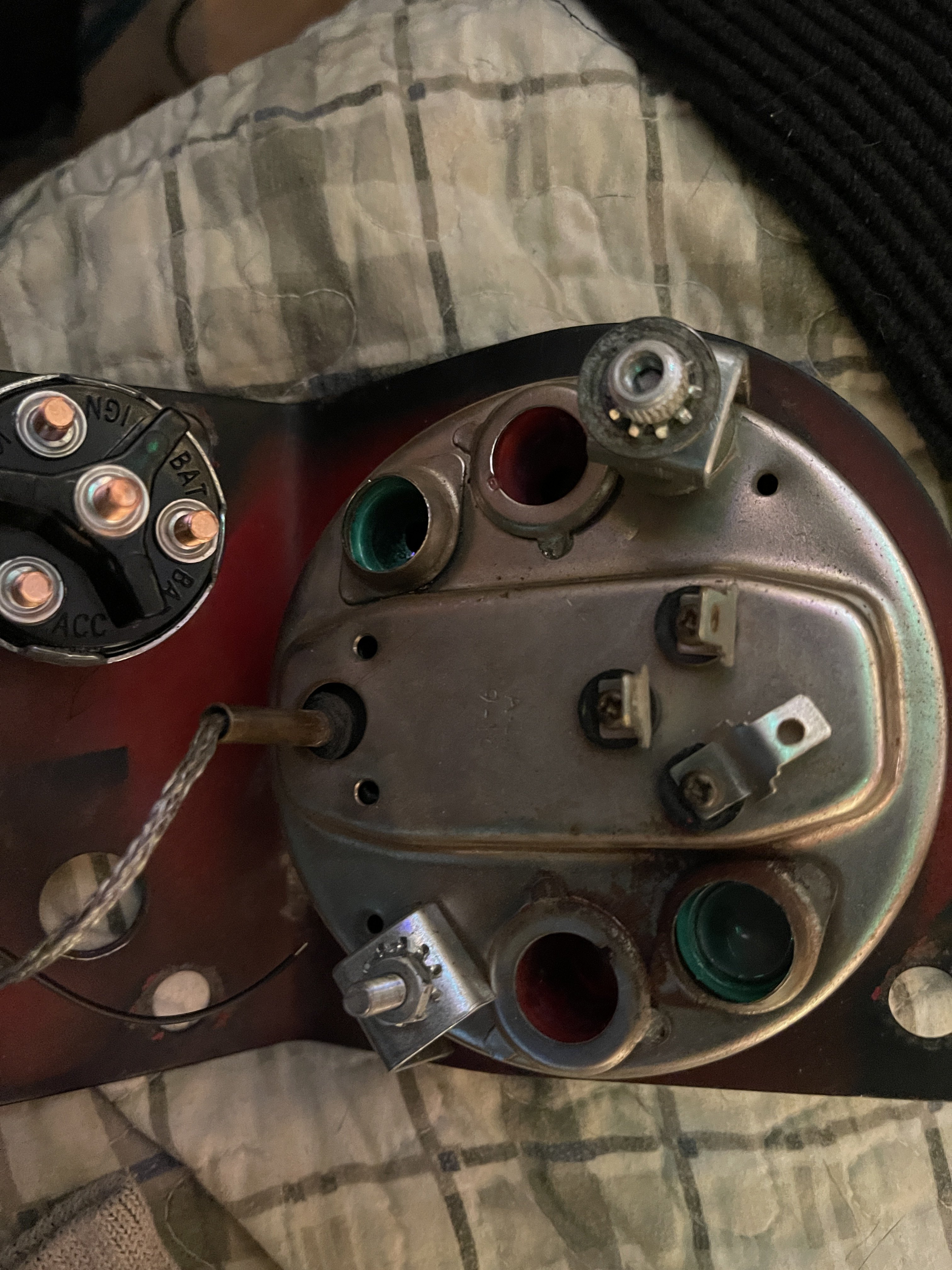

Any help on understanding this panel wiring?
>Tractor is an IH/farmall 826 diesel.
> I am rewiring the tractor and swapping the POS 3 wire/external regulated alternator for a delco 10si/internally regulated alternator
>photos are of right hand panel instrument cluster/gauge thingies
I've already tried looking in literature for the tractor, but as usual, and always, the operator's manual/service&repair manual are just below the threshold of actually being useful. There's no markings on the gauges whatsoever, and original wiring had literally deteriorated into nothing and was so janky with splicing photos wouldn't even help
1) The main part of this panel I need info on is the AMP light
2) is this amp gauge actually just an idiot light for detecting (any) amperage at all (make sure that the battery is getting charged)? As it's just a light rather than a true gauge (im assuming the bottom gauge is for the oil pressure, though maybe I'm wrong?
3) I have an
Aftermarket voltage meter gauge
I've swapped the air filter indicator for the voltage gauge, but im not sure how to wire it in properly. Ive read that a voltage meter is superior to amp gauges and makes them unnecessary, but I can't find any videos or instructions on how to do so

That really helps!!! The wiring I have suggested can basically be ignored. There os only one wire needed and that is from the Bat on the Alt to the battery post where you have it. The #1 and #2 terminals are to be ignored. This style of alternator does use a tiny amount of electricity all the...
From the bat terminal on your alternator you should just run a 10 ga wire directly to the post on the starter where the positive battery cable connects. You can do this since you are not using an ammeter otherwise the wire off the alt would need to go up to the dash. A little short 16ga jumper from the bat terminal on the alt over to the “2” spade on the edge of the 10si. The number “1” spade needs to connect to the ignition switch. This will work fine on a diesel with a throttle kill.
Your voltmeter will also just need to have power when the ignition is on. It may have a light to illuminate the dial that will have to connect to the light wiring.
The gauge in the cluster gauge you are showing opposite of the fuel gauge is the temp gauge that operates by a manual capillary tube. Those tractors only had an idiot “tell tale” light for oil pressure. If I had a proper wiring diagram I think the amp light could be connected to the “1” spade on the alternator and work like a charge lamp. I do not want to mislead you. I have a wiring diagram for the “..06” series which I think is close. I will wait and see if someone post one for the “..26/..56” series.

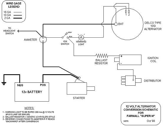

Treat the Amp light like the warning light or diode in your typical 3-wire 12V conversion for the old Farmalls.
You don't NEED the ammeter but you could add one.
https://www.yesterdaystractors.com/articles/artint195.htm

Any light used for the 3 wire Delco alternator needs to be in series with the #1 terminal to keyed ignition (on) voltage. The existing light may be grounded and have one wire. There are many sources for 2 wire 12v indicator lights. The diagram shown shows this series circuit. Jim
Upvote 0
this isnt a 3 wire/ext reg anymore tho, the new alternator is internally regulated

Being a diesel, The #2 terminal is correct wired to the Bat terminal with a short wire.
The Bat terminal is correct attached to the starter where the Battery positive cable attaches to a big stud. (10 gauge wire)
The #1 terminal can be attached directly to a 2 wire 12v indicator light on the dash (yours to purchase and install). then from that new "idiot" light to the IGN terminal on the key, The light is needed because the diesel is shut off by fuel not electricity, and the light will remind you to shut off the key. If the key is left on the alternator will be left on and a battery drain will happen (slowly but surely).
An alternative to the Key switch being used is to use an oil pressure switch from NAPA to cause the alternator to start and stop. This switch is cheap, and will plumb into the port that has the oil pressure sending unit in it. (could be a tube if the gauge is non-electric). You would need a nipple and T so the gauge works and the switch gets pressure. One of the two terminals on the switch (either) connects to the Battery post on the starter where the Bat wire is attached, the other terminal is connected to the #1 terminal of the alternator. This does not need a light but could have one in series with that wire to the pressure switch if you wanted a "idiot" light for the alternator functioning. The oil pressure switch shuts off the alternator when the engine stops. Jim
