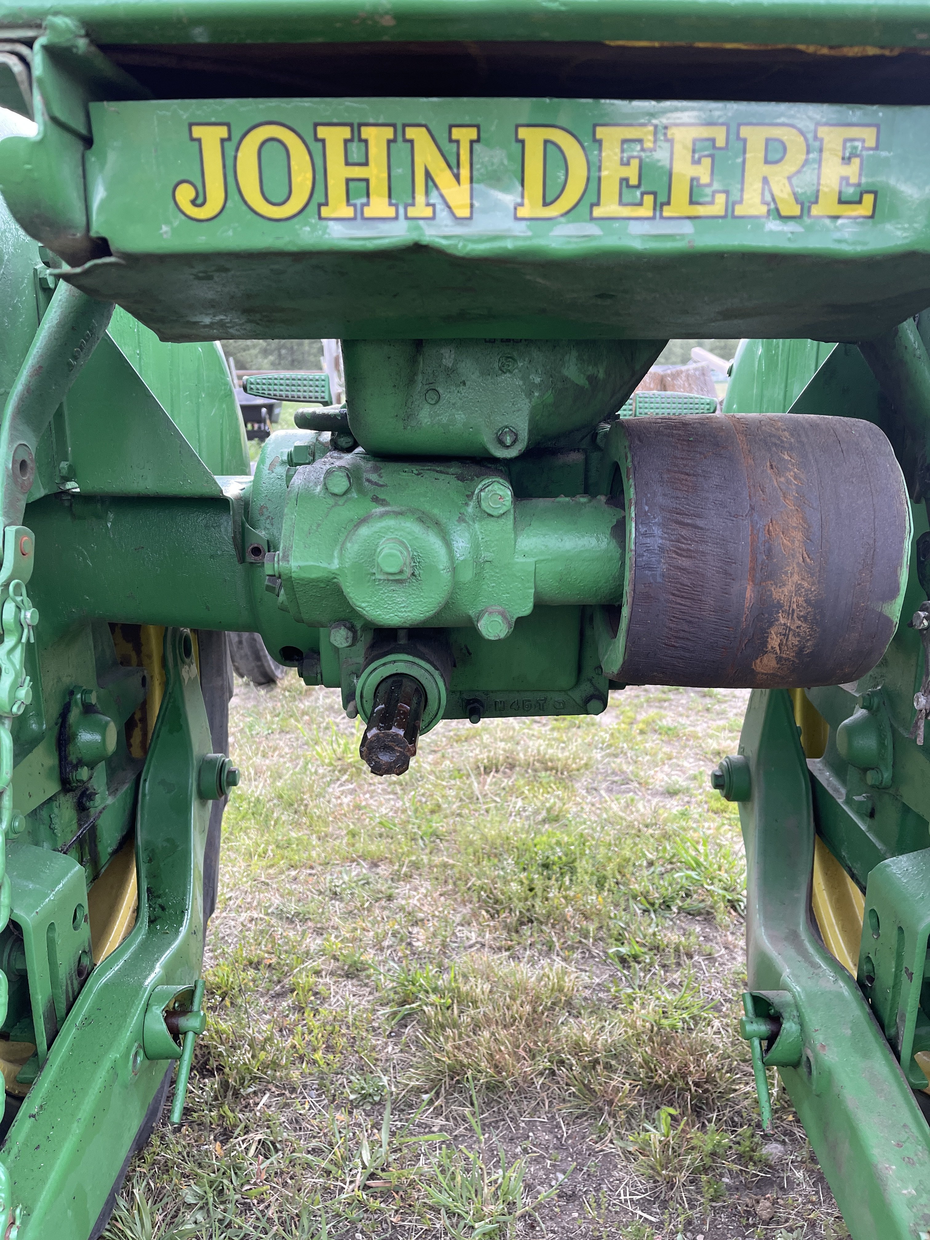

Has anyone converted to the 3 point system and run an auger for post holes? I would like to try this with my M but I have 2 concerns;
Will it lift high enough?
Is there enough power to actually dig holes with it?

I have known 2 people that used an auger on an M.
Worked fine they said.

Yes it will you are better off running it at an idle and letting it kill it than going full bore this honestly is probably about perfect tractor for the task you are less likely to break something since it doesn’t have much power or get yourself hurt. I’ve never had a tractor that could reverse the pto out like a skidloader mounted one. Is a 420 with that reverser able to do it?
I have run a post hole auger on a 1025r, which is rated at roughly the same PTO hp as the M. I did need to take it slow, and if the ground was really hard it was slow and rough going, but it got it done...so as far as PTO hp goes, I think you have enough.
But having run the auger on other tractors, and knowing how my M and MT lift, I suspect it won't lift high enough. I don't know that for certain, though. Just a suspicion.
As always i can't say enough about a PHD mounted to a skid steer. Rent, beg, borrow or steal a PHD on a skid steer because it is far superior to any 3 pt PHD.
Does anyone have experience running a belt driven post hole digger? My M has the belt pulley and I might be able to get one from an M-H Pony.
